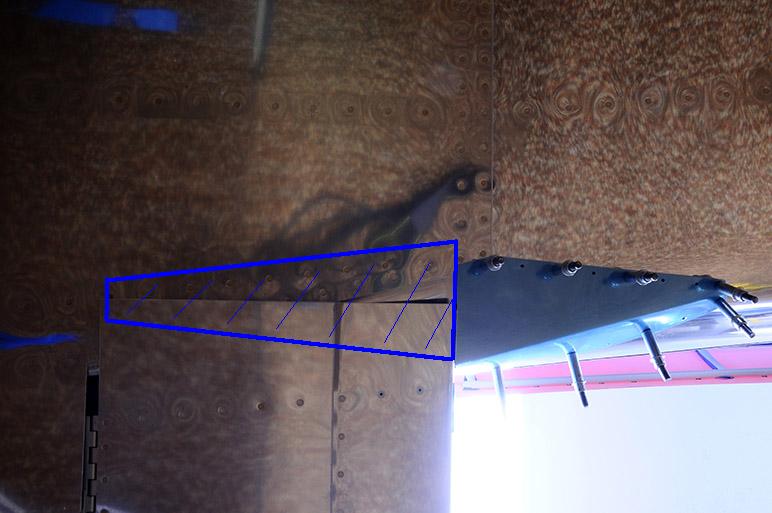

Subject: RV8-List: Flap Skins Too Short?
Dear Listers,
Please see the attached photo taken from the underside of my RV-8. I was going
to cut the bottom flap skin to match the diagonal of the fuselage skin per the
"View E-E Flaps Fairing" on DGW 80. But, it appears that the aft portion of
the flap skin was cut too short by
the QB builders. Note that the front part
seems to be exactly the right length and that diagonal cut will clip just
perfectly.
But on the aft skin of the flap, it is cut off about 2" too short to
continue the diagonal line. Since the fuselage side skin is curving up right
there, this will act like a giant air scoop. The flaps appear to be mounted in
the correct position, left/right as they are the required 3/16" from the
ailerons.
The left side is exactly the same as the right side as shown in the picture.
Thoughts?
Thanks!
Matt Dralle
RV-8 #82880 N998RV
FWF Is Right Around The Corner!!

| Subject: | Re: Flap Skins Too Short? |
Matt,
I'd like to respond, but I have no idea where your photos are.
Stan Sutterfield
going
the
of
the flap skin was cut too short by the QB builders. Note that the front
part
perfectly.
right
mounted in
ailerons.
picture.

Message 4
Hi Stan,
You can see the photo here:
http://forums.matronics.com/viewtopic.php?t=60433
Matt
At 02:21 PM 7/20/2009 Monday, you wrote:
>Matt,
>Stan Sutterfield

> cut will clip just perfectly.
> too short to
> required 3/16" from the ailerons.

Here's what I heard back from Van's today regarding the issue including the updated
picture:
> Simply rivet on a .040" extension (like the -4 & -6 builders had to) as shown
in the attached picture. You can bend it to fit any contour or overlap the flap
intersection fairing as you see fit. Use pop or solid flush rivets to attach.
Um, good thing its underneath... ;-)
Matt

Matt,
That's not the solution I would have expected to hear. You are way ahead of me
right now. I am about to rivet my flaps together and I'm doing a standard kit.
When I saw your 1st pics, I thought the skins looked to be cut about the same
as mine. After seeing what Van's suggested you do, I went out to measure
my skins. From the first rivet out to the inboard edge of the skin, I measure
3-7/8". The last rivet toward the aft end of the flap measures about 2-7/8"
to the edge. Is this what yours measures? Just thinking out loud here, if you
splice an additional skin extension to the existing flap skin as you have it
drawn, wouldn't the shop head of the rivets contact the bottom of the fuselage
thereby keeping the flap skin from resting flat against the fuselage?
Bill Settle
