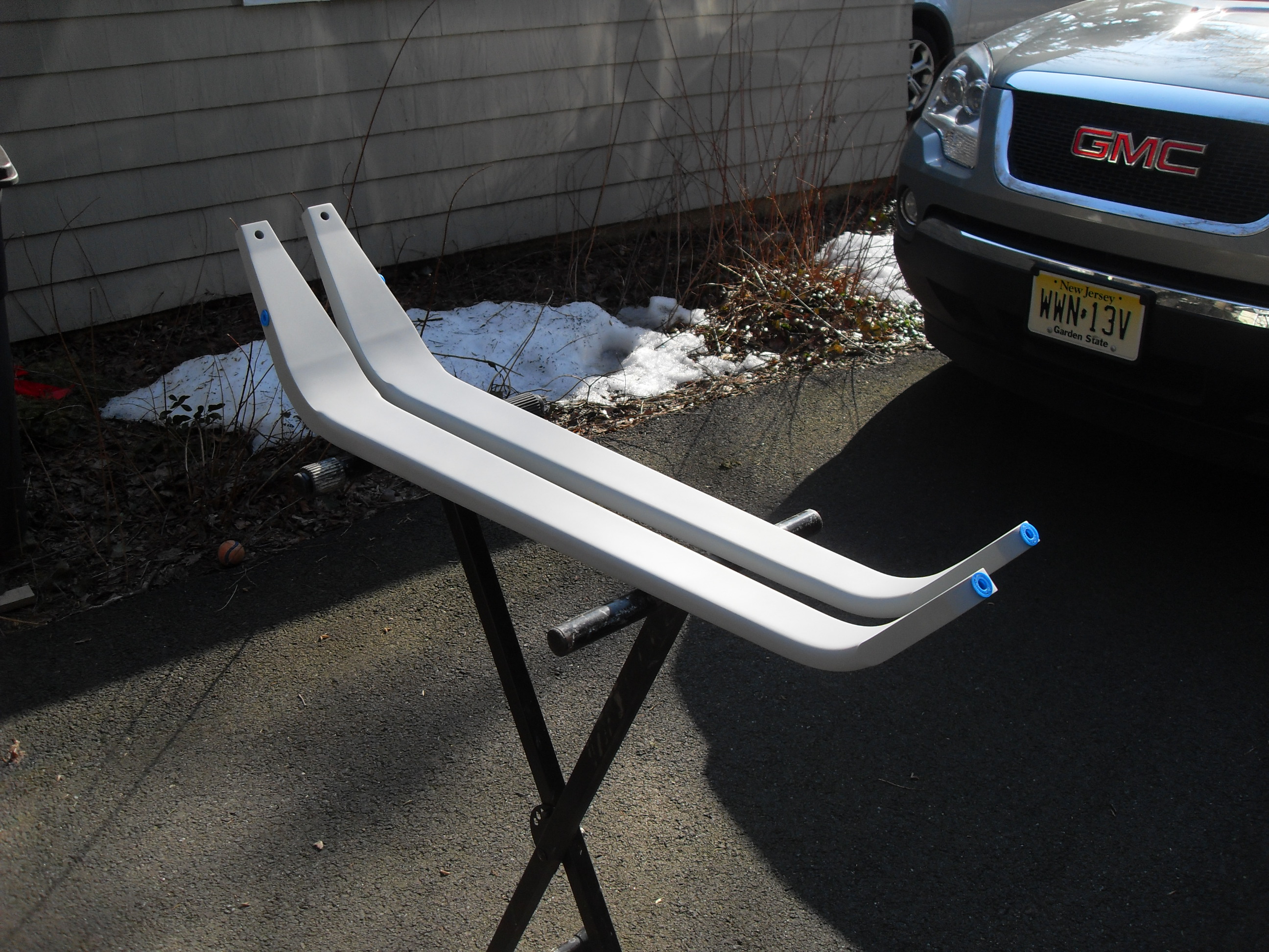

I have an extra set of Grove standard aluminum gear for an RV-8. New with hardware
kit included.
17 pounds lighter than Vans steel gear legs. Gun drilled brake lines.
Paid $1595, sell for $1400
http://www.groveaircraft.com/rv8.html
email f.dombroski at yahoo.com for pictures and questions.
Frank Dombroski
RV-10 N46WD Flying
RV-8 N84FD final assembly
N40 Sky Manor Airport
