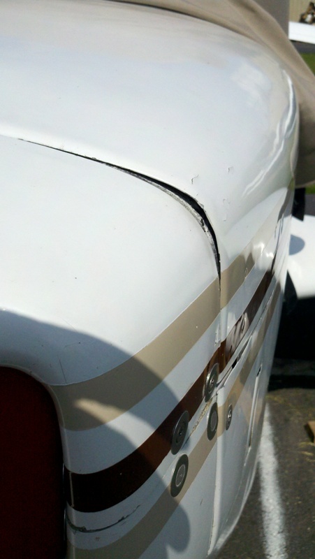

    I warned you that I had lots of questions. My next one relates to the alignment of the upper cowl to the nose bowl and the fuselage at the base of the windscreen. On my Tiger there are gaps where the upper cowl is between about 3/8 inch and 5/8 inch higher than the nosebowl (at the front of the cowl) and the fuselage at the base of the windscreen (at the rear of the cowl). The gaps are at the bend where the upper cowl curves down from the horizontal to the vertical. You can see what I mean in the attached photos (if I've been successful in attaching them). The right front is ok. But the left front and both rear joints show the gaps. It's as if the bottom edge of the upper cowl can't go down far enough to allow it to fit tightly enough. As you can see, the cowling is cracking at the bends. What do I need to do to eliminate the gaps and get the upper cowl to align better with the nosebowl and fuselage? By the way, the lower cowl seems to fit and align well with the fuselage. Read this topic online here: http://forums.matronics.com/viewtopic.php?p=373968#373968 Attachments: http://forums.matronics.com//files/right_front_cowling_657.jpg http://forums.matronics.com//files/right_rear_cowling_193.jpg http://forums.matronics.com//files/left_rear_cowling_493.jpg http://forums.matronics.com//files/left_front_cowling_980.jpg

    you'll have to send pictures. -It's impossible for the upper cowling to b e off 5/8 inches and still close.=0A=0A=0A________________________________ =0A From: bkspero <bkspero@gmail.com>=0ATo: teamgrumman-list@matronics.com =0ASent: Friday, May 25, 2012 7:17 PM=0ASubject: TeamGrumman-List: Improve bkspero@gmail.com>=0A=0AI warned you that I had lots of questions.- My ne xt one relates to the alignment of the upper cowl to the nose bowl and the fuselage at the base of the windscreen.- On my Tiger there are gaps where the upper cowl is between about 3/8 inch and 5/8 inch higher than the nose bowl (at the front of the cowl) and the fuselage at the base of the windscr een (at the rear of the cowl).- The gaps are at the bend where the upper cowl curves down from the horizontal to the vertical.=0A=0AYou can see what I mean in the attached photos (if I've been successful in attaching them). - The right front is ok.- But the left front and both rear joints show the gaps.- It's as if the bottom edge of the upper cowl can't go down far enough to allow it to fit tightly enough.- As you can see, the cowling i s cracking at the bends.=0A=0AWhat do I need to do to eliminate the gaps an d get the upper cowl to align better with the nosebowl and fuselage?- By the way, the lower cowl seems to fit and align well with the fuselage.=0A =0A=0A=0A=0ARead this topic online here:=0A=0Ahttp://forums.matronics.com/v iewtopic.php?p=373968#373968=0A=0A=0A=0A=0AAttachments: =0A=0Ahttp://foru ms.matronics.com//files/right_front_cowling_657.jpg=0Ahttp://forums.matroni cs.com//files/right_rear_cowling_193.jpg=0Ahttp://forums.matronics.com//fil es/left_rear_cowling_493.jpg=0Ahttp://forums.matronics.com//files/left_fron - - - - - - - - - - - - -Matt Dralle, List Admin. ====

    Gary, I did post photos. They show up in the webmail listing so I'm not sure why you didn't get them. Try this link: http://forums.matronics.com/viewtopic.php?t=90423 teamgrumman(at)yahoo.com wrote: > you'll have to send pictures. It's impossible for the upper cowling to be off 5/8 inches and still close. > Read this topic online here: http://forums.matronics.com/viewtopic.php?p=373976#373976

    I see the pics. Was it always like that? The only real solution is to buy a Jaguar cowling. Gary Sent from my iPad On May 25, 2012, at 7:17 PM, "bkspero" <bkspero@gmail.com> wrote: > > I warned you that I had lots of questions. My next one relates to the alignment of the upper cowl to the nose bowl and the fuselage at the base of the windscreen. On my Tiger there are gaps where the upper cowl is between about 3/8 inch and 5/8 inch higher than the nosebowl (at the front of the cowl) and the fuselage at the base of the windscreen (at the rear of the cowl). The gaps are at the bend where the upper cowl curves down from the horizontal to the vertical. > > You can see what I mean in the attached photos (if I've been successful in attaching them). The right front is ok. But the left front and both rear joints show the gaps. It's as if the bottom edge of the upper cowl can't go down far enough to allow it to fit tightly enough. As you can see, the cowling is cracking at the bends. > > What do I need to do to eliminate the gaps and get the upper cowl to align better with the nosebowl and fuselage? By the way, the lower cowl seems to fit and align well with the fuselage. > > > > > Read this topic online here: > > http://forums.matronics.com/viewtopic.php?p=373968#373968 > > > > > Attachments: > > http://forums.matronics.com//files/right_front_cowling_657.jpg > http://forums.matronics.com//files/right_rear_cowling_193.jpg > http://forums.matronics.com//files/left_rear_cowling_493.jpg > http://forums.matronics.com//files/left_front_cowling_980.jpg > > > > > > >

    I got them. I see what your talking about. It looks like the cowling is damaged . . . Doubler may have broken at the corners allowing the cowling to deform. Gary Sent from my iPad On May 25, 2012, at 8:40 PM, "bkspero" <bkspero@gmail.com> wrote: > > Gary, I did post photos. They show up in the webmail listing so I'm not sure why you didn't get them. > > Try this link: > > http://forums.matronics.com/viewtopic.php?t=90423 > > > teamgrumman(at)yahoo.com wrote: >> you'll have to send pictures. It's impossible for the upper cowling to be off 5/8 inches and still close. >> > > > > > > Read this topic online here: > > http://forums.matronics.com/viewtopic.php?p=373976#373976 > > > > > > > > > >
