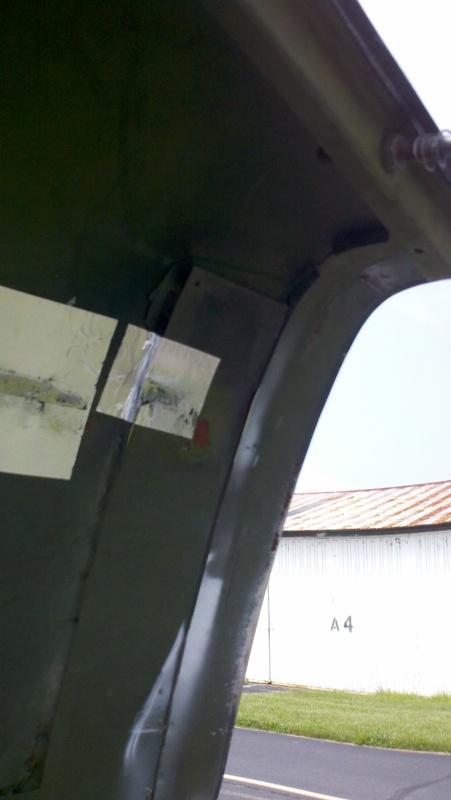

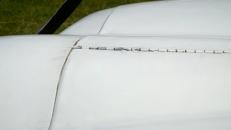

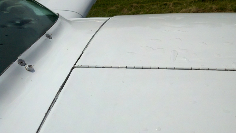

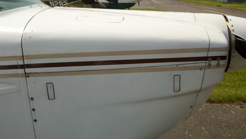

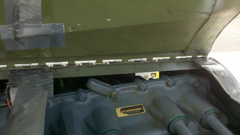

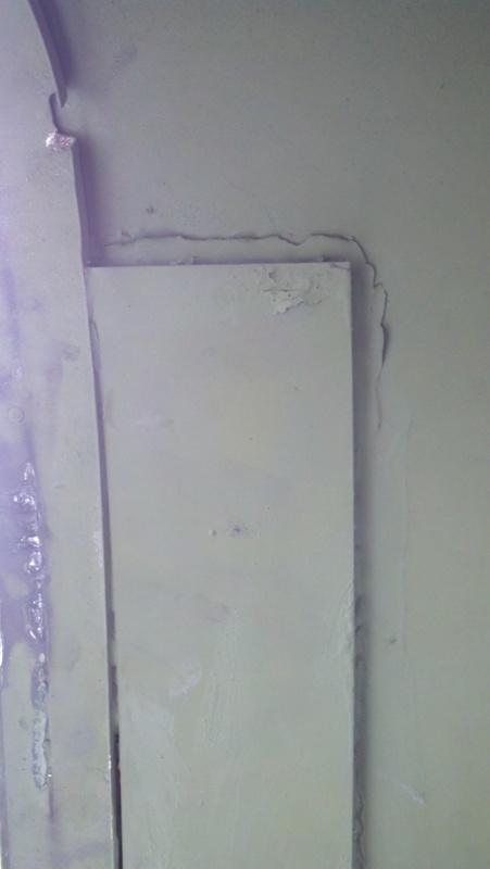

    gketell wrote: > You can definitely see cracks in the cowl at the top of the curve of each "high point". Can you take/post pictures of the inside of the cowl? Here is a pretty full set of photos both inside and outside. Two more, from the front looking at the nosebowl thru the propellor were poorly focused and I have to retake them. Do these indicate anything. I do see the delamination inside at the corners. Seems to me more like the result of the mis-fit than the cause. The upper cowl halves just seem to long, or the lower cowl seems set to high (although it lines up pretty well with the fuselage). Barry S(2) Read this topic online here: http://forums.matronics.com/viewtopic.php?p=374030#374030 Attachments: http://forums.matronics.com//files/right_side_horizontal_cowl_seam_150.jpg http://forums.matronics.com//files/rear_right_side_vertical_cowl_seam_101.jpg http://forums.matronics.com//files/rear_of_center_hinge_internal_right_159.jpg http://forums.matronics.com//files/rear_of_center_hinge_internal_left_142.jpg http://forums.matronics.com//files/rear_of_center_hinge_external_from_right_135.jpg http://forums.matronics.com//files/rear_of_center_hinge_external_from_left_156.jpg http://forums.matronics.com//files/rear_left_side_vertical_cowl_seam_233.jpg http://forums.matronics.com//files/rear_inside_right_cowl_closeup_904.jpg http://forums.matronics.com//files/rear_inside_right_cowl_closeup_2_252.jpg http://forums.matronics.com//files/rear_inside_left_rear_closeup_137.jpg http://forums.matronics.com//files/left_side_horizontal_cowl_seam_117.jpg http://forums.matronics.com//files/front_right_side_vertical_cowl_seam_and_nosebowl_205.jpg http://forums.matronics.com//files/front_of_center_hinge_internal_right_198.jpg http://forums.matronics.com//files/front_of_center_hinge_internal_left_635.jpg http://forums.matronics.com//files/front_of_center_hinge_external_from_right_676.jpg http://forums.matronics.com//files/front_of_center_hinge_external_from_left_142.jpg http://forums.matronics.com//files/front_left_side_vertical_cowl_seam_and_nosebowl_356.jpg http://forums.matronics.com//files/front_inside_right_cowl_211.jpg http://forums.matronics.com//files/front_inside_right_cowl_closeup_186.jpg http://forums.matronics.com//files/front_inside_left_cowl_closeup_206.jpg

    Barry, if you had wanted a near perfect plane, you missed your opportunity. -The original cowling is built to the nearest .3 inches. -Yours looks fine to me.=0A=0APic 150: -Looks normal to me.=0APic 101: -Looks normal to me.=0APic 159: -Other than the hinge . . . -I mount the hinge like this left to right: hinge, mounting bracket, hinge, mounting bracket, hinge .=0A- - - - - - - - -I open the hinge and have it straddl e the two mounting brackets.=0APic 142: -see comment for 159=0APic 135: -You can crowd the hinge aft and redrill. -It will pull the the nose bo wl aft however.=0APic 156: -No comment=0APic 233: -Seem is typical.=0AP ic 904/252: -The missing sections of the doubler are so the cowling can b end in the corner.=0APic 186: -Looks like the doubler is debonding=0ARest of pics: -Pretty typical of all the planes I see.=0A=0ABarry, go find so me other Cheetahs/Tigers. -You'll see they are all the same. -=0A=0AThe only fix is a new cowling.=0AGary=0A=0A=0A=0A=0A__________________________ ______=0A From: bkspero <bkspero@gmail.com>=0ATo: teamgrumman-list@matronic s.com =0ASent: Saturday, May 26, 2012 6:54 PM=0ASubject: TeamGrumman-List: "bkspero" <bkspero@gmail.com>=0A=0A=0Agketell wrote:=0A> You can definitel y see cracks in the cowl at the top of the curve of each "high point".- C an you take/post pictures of the inside of the cowl?=0A=0A=0AHere is a pret ty full set of photos both inside and outside.- Two more, from the front looking at the nosebowl thru the propellor were poorly focused and I have t o retake them.=0A=0ADo these indicate anything.- I do see the delaminatio n inside at the corners.- Seems to me more like the result of the mis-fit than the cause.- The upper cowl halves just seem to long, or the lower c owl seems set to high (although it lines up pretty well with the fuselage). =0A=0ABarry S(2)=0A=0A=0A=0A=0ARead this topic online here:=0A=0Ahttp://for ums.matronics.com/viewtopic.php?p=374030#374030=0A=0A=0A=0A=0AAttachments : =0A=0Ahttp://forums.matronics.com//files/right_side_horizontal_cowl_seam_ 150.jpg=0Ahttp://forums.matronics.com//files/rear_right_side_vertical_cowl_ seam_101.jpg=0Ahttp://forums.matronics.com//files/rear_of_center_hinge_inte rnal_right_159.jpg=0Ahttp://forums.matronics.com//files/rear_of_center_hing e_internal_left_142.jpg=0Ahttp://forums.matronics.com//files/rear_of_center _hinge_external_from_right_135.jpg=0Ahttp://forums.matronics.com//files/rea r_of_center_hinge_external_from_left_156.jpg=0Ahttp://forums.matronics.com/ /files/rear_left_side_vertical_cowl_seam_233.jpg=0Ahttp://forums.matronics. com//files/rear_inside_right_cowl_closeup_904.jpg=0Ahttp://forums.matronics .com//files/rear_inside_right_cowl_closeup_2_252.jpg=0Ahttp://forums.matron ics.com//files/rear_inside_left_rear_closeup_137.jpg=0Ahttp://forums.matron ics.com//files/left_side_horizontal_cowl_seam_117.jpg=0Ahttp://forums.matro nics.com//files/front_right_side_vertical_cowl_seam_and_nosebowl_205.jpg=0A http://forums.matronics.com//files/front_of_center_hinge_internal_right_198 .jpg=0Ahttp://forums.matronics.com//files/front_of_center_hinge_internal_le ft_635.jpg=0Ahttp://forums.matronics.com//files/front_of_center_hinge_exter nal_from_right_676.jpg=0Ahttp://forums.matronics.com//files/front_of_center _hinge_external_from_left_142.jpg=0Ahttp://forums.matronics.com//files/fron t_left_side_vertical_cowl_seam_and_nosebowl_356.jpg=0Ahttp://forums.matroni cs.com//files/front_inside_right_cowl_211.jpg=0Ahttp://forums.matronics.com //files/front_inside_right_cowl_closeup_186.jpg=0Ahttp://forums.matronics.c =============

    The "Rear inside right" pictures shows obvious signs of debonding of the doubler. The "Rear inside left" pictures show hints that the doubler might be debonding (cracking paint around the doubler). Read this topic online here: http://forums.matronics.com/viewtopic.php?p=374033#374033
