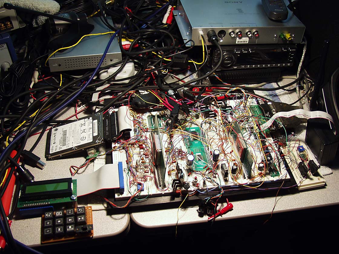

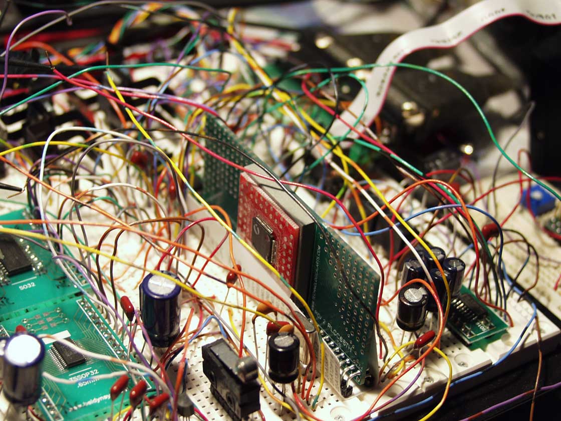

    A bit Squirrely??? At 03:09 AM 7/1/2007 Sunday, you wrote: >I am re-vamping my 1999 Tacoma Audio installation, and I integrated a 30GB Video iPod with my C90 + XDP-4K combo. I bought a "PAC" brand "Unilink Aux Input Adaptor" that plugs into the CD-Changer Unilink Input on my XDP-4k, and tricks the Head Unit (or XDP) into thinking a Unilink CD-Changer is connected (The C90 displays "CD2, Track 00 Time 00:00" continuously while listening to the iPod), and allows you to use the associated RCA Inputs for whatever source you want (an iPod's "Dock" Line Out in my case). I removed my dual 10-Disc changers in favor of the iPod (and I still have the C90's CD Player via Toslink for more "Critical Listening"). > >The PAC Unilink adaptor is like this: ><http://home.speedfactory.net/tcashin/pacdongle.jpg>http://home.speedfactor y.net/tcashin/pacdongle.jpg Sounds to me like the PacDongle isn't following the Unilink protocol correctly. There are quite a few "nuances" about the protocol that must be emulated exactly if reliable operation is expected. I wrote a Unilink emulator for a 8051-core microcontroller and spent a substantial amount of effort getting the timing correct and emulating the protocol correctly. To my knowledge, there is no officially available "specification" from Sony on the Unilink protocol, and anyone that has ever done it other than Sony, did it by reverse engineering it. I was pretty motivated for a while on building a device similar to the PacDongle that you have and actually have built a system that does a full CD Changer emulation including track and album information in a test enviroment. Unfortunately, as you pointed out, the the market for a Unilink product is dwendling quickly. Here's a couple of pics of the system I built with a 60GB hard drive. The close up is of the 100 mips 8051-based microcontroller to specifically do the Unilink emulation. It also does full Unilink decode on the bus and outputs to RS232 for debugging. http://www.matronics.com/xdp-4000x/MattsUnilinkMP3-CompleteSystem.jpg http://www.matronics.com/xdp-4000x/MattsUnilinkMP3-100mips8051.jpg http://www.matronics.com/xdp-4000x/MattsUnilinkMP3-DebugDecodingDump.pdf I've been using the Phatnoise Phatbox system in both my car and truck C90/4000x installations for about 5 years now. http://www.phatnoise.com/ The Phatbox is basically what I was building. The Phatbox is in the trunk and looks in every way just like a full-featured CD Changer. The Phatbox has its quirks, but generally works great and has been extremely reliable. There is a website called PhatHack http://www.phathack.com/ that has hacked the Phatbox firmware such that you can use your own OEM hard drives now, and I have recently upgraded both of Phatboxes to 160GB. My library is currently at 85GB so I can have my entire collection online with the Phatbox. For me, the best part of the Phatbox type implementation is that it is truly like a CD Changer in that it is remotely mounted and I simply control it from the C90 including all track display information. Fumbling around with an iPod in the passenger area is just a car accident waiting to happen not to mention pretty kludgy with the wires and what not. Its also big sign asking someone to break in a steal it. My recommendation? Dump the iPod and PacDongle and get yourself a sweet Phatbox setup. Your friends will be impressed and you will be too. Matt Dralle Matt G Dralle | Matronics | PO Box 347 | Livermore | CA | 94551 925-606-1001 V | 925-606-6281 F | dralle@matronics.com Email http://www.matronics.com/ WWW | Featuring Products For Aircraft

    bit Squirrely??? That's some hadcore DIY'ing, Matt! I considered the Phatbox for some time, but I could not justify its cost or the cost of it's HD's (the Hacked Firmware sounds interesting). I can live with this "PAC Issue" like it is, but it is just annoying. I bet it would work fine w/o the XDP4k (if I had the PAC adaptor plugged directly into the C90). But, I can't read the darn C90 Display to begin with - so trying to navigate through the Phatbox's 10,000 MP3's from that un-readable display is asking for frustration (and hunching over and using your hands to "Sheild" the sun from the C90's face is probably more dangerous than clicking through the iPod - I know I have almost crashed a few times while trying to read the C90's clock during the day). I also wanted a high-contrast color Video Screen. So the Phatbox is out (due to no fault of its own). I mounted my 30GB Video iPod right next to the C90, and it is in plain view and sits approx 2" away from the C90's rotary encoder. The wiring is very clean (one Dock connector cable, about 8" of it is exposed and not cluttered at all IMO), and the mount is solid (but does not mar the iPod's finish). Here is a quick (and dark) pic: http://img243.imageshack.us/my.php?image=9aipodc90noflashgccl3.jpg You can see how much brighter the iPod is, and that is with it set at 50% Brightness! That thing will blind you in a dark truck if you don't crank down the Brightness! It is so much easier to read and navigate than the C90 IMO (even 100% readable in direct sunlight)... As far as "Theft" - I think the $,$$$ 12" Subs and amps are more of an attraction than the $200 iPod, but with literally two clicks (one to remove the Dock Cable, one to release the iPod Cradle) the iPod comes inside with me in under 5 seconds :-) Just as easy as removing the C90's face... I'll probably stick with this install for a year or so, and then rip out the C90/XDP in favor of a Car-PC + RME "Multiface" Audio Interface to do all of the Linear-Phase DSP, and I'll get a 7" LCD with DVD-Navigation and endless storage capacity to boot! That's going to be fun (seems like the next logical step to me)... Thanks for the info! Any ideas on how to kill the noise I'm getting when the iPod is charging? I'll probably just add a seperate toggle switch so I can charge it when I'm not listening to it, and play off the Battery while listening (or even do a "Reverse Relay" that kicks on when I turn off the Truck)... Randy V On 7/1/07, Matt Dralle <dralle@matronics.com> wrote: > > > At 03:09 AM 7/1/2007 Sunday, you wrote: > > I am re-vamping my 1999 Tacoma Audio installation, and I integrated a 30GB > Video iPod with my C90 + XDP-4K combo. I bought a "PAC" brand "Unilink Aux > Input Adaptor" that plugs into the CD-Changer Unilink Input on my XDP-4k, > and tricks the Head Unit (or XDP) into thinking a Unilink CD-Changer is > connected (The C90 displays "CD2, Track 00 Time 00:00" continuously while > listening to the iPod), and allows you to use the associated RCA Inputs for > whatever source you want (an iPod's "Dock" Line Out in my case). I removed > my dual 10-Disc changers in favor of the iPod (and I still have the C90's CD > Player via Toslink for more "Critical Listening"). > > The PAC Unilink adaptor is like this: > http://home.speedfactory.net/tcashin/pacdongle.jpg > > > Sounds to me like the PacDongle isn't following the Unilink protocol > correctly. There are quite a few "nuances" about the protocol that must be > emulated exactly if reliable operation is expected. I wrote a Unilink > emulator for a 8051-core microcontroller and spent a substantial amount of > effort getting the timing correct and emulating the protocol correctly. To > my knowledge, there is no officially available "specification" from Sony on > the Unilink protocol, and anyone that has ever done it other than Sony, did > it by reverse engineering it. > > I was pretty motivated for a while on building a device similar to the > PacDongle that you have and actually have built a system that does a full CD > Changer emulation including track and album information in a test > enviroment. Unfortunately, as you pointed out, the the market for a Unilink > product is dwendling quickly. Here's a couple of pics of the system I built > with a 60GB hard drive. The close up is of the 100 mips 8051-based > microcontroller to specifically do the Unilink emulation. It also does full > Unilink decode on the bus and outputs to RS232 for debugging. > > http://www.matronics.com/xdp-4000x/MattsUnilinkMP3-CompleteSystem.jpg > > http://www.matronics.com/xdp-4000x/MattsUnilinkMP3-100mips8051.jpg > > > http://www.matronics.com/xdp-4000x/MattsUnilinkMP3-DebugDecodingDump.pdf > > I've been using the Phatnoise Phatbox system in both my car and truck > C90/4000x installations for about 5 years now. http://www.phatnoise.com/ > The Phatbox is basically what I was building. The Phatbox is in the trunk > and looks in every way just like a full-featured CD Changer. The Phatbox > has its quirks, but generally works great and has been extremely reliable. > There is a website called PhatHack http://www.phathack.com/ that has > hacked the Phatbox firmware such that you can use your own OEM hard drives > now, and I have recently upgraded both of Phatboxes to 160GB. My library is > currently at 85GB so I can have my entire collection online with the > Phatbox. For me, the best part of the Phatbox type implementation is that > it is truly like a CD Changer in that it is remotely mounted and I simply > control it from the C90 including all track display information. Fumbling > around with an iPod in the passenger area is just a car accident waiting to > happen not to mention pretty kludgy with the wires and what not. Its also > big sign asking someone to break in a steal it. > > My recommendation? Dump the iPod and PacDongle and get yourself a sweet > Phatbox setup. Your friends will be impressed and you will be too. > > Matt Dralle > > Matt G Dralle | Matronics | PO Box 347 | Livermore | CA | 94551 > 925-606-1001 V | 925-606-6281 F | dralle@matronics.com Email > http://www.matronics.com/ WWW | Featuring Products For Aircraft > > * > > * > > -- Randy V. Houston, TX Audio-Dude/Musician/Crazy Guy
