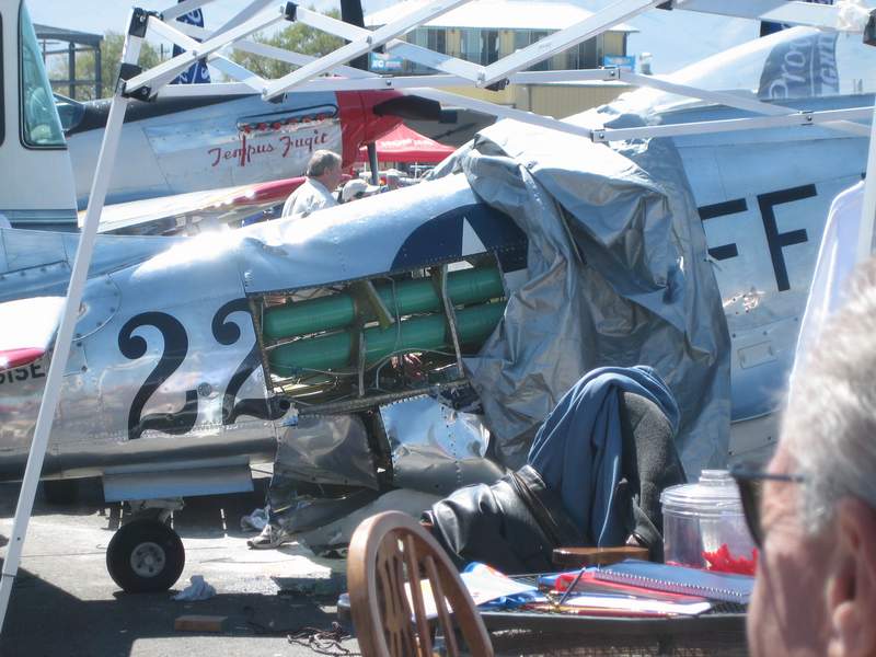

    Yak air tanks can be lethal too ! This one let go on the ground during warm up. Keep em tested ! kp ----- Original Message ----- From: "Mike Bell" <yakflyr@comcast.net> Sent: Wednesday, September 20, 2006 4:42 AM Subject: Yak-List: Oxygen Tank Explosion, Hydrotesting > --> Yak-List message posted by: "Mike Bell" <yakflyr@comcast.net> > > Ben mentioned the oxygen tank explosion at Reno. I was shooting video of > his team's gorgeous Grumman Tigercat when I heard the big boom. The > picture below shows what that does to a Mustang. > > Jill and Carl at M-14P can now do your hydrotesting. The turnaround is > fast and they won't ruin your tanks using the wrong fittings. > > -------- > Mike Bell > Yak 52 > Elk Grove, CA > yakflyr@comcastdotnet > > > Read this topic online here: > > http://forums.matronics.com/viewtopic.php?p=62673#62673 > > > Attachments: > > http://forums.matronics.com//files/reno_2006_008_e_314.jpg > > >

    The tank exploded because it was over pressurized. It was an original type tank, which is low pressure and rarely used today. The important questions are: from the aircraft owners point of view: WHo allowed it to be filed w/out checking/confirming what was going in from the maintainer's view: How did someone come to be filling a tank without know for certain the type of tank it was. Ira Saligman RPA Treasurer o 610 687 0420 c 610 324 5500 f 215 243 7699 <mailto:treasurer@flyredstar.org> treasurer@flyredstar.org <mailto:isaligman@saligman.com> isaligman@saligman.com

    --> Yak-List message posted by: "Scooter" <yakk52@verizon.net> I assume that's pilot O2 (what else can it be)? Seems like a large supply. I guess these guys are flying up high. I did a little searching and found two other O2 cylinder explosions in P-51 mustangs over the years (one last year and one in '72). Read this topic online here: http://forums.matronics.com/viewtopic.php?p=63087#63087

    --> Yak-List message posted by: "Ben Marsh" <ben@designselect.net> It happened in Tom Dwelle's Sea Fury as well. Pressure indicator rated for 3000 psi, bottle rated for 1000 psi. When it blew it took Dwelle's fingers and sent the bottle through the airplane and into the top of the hanger. Ouch! -----Original Message----- From: owner-yak-list-server@matronics.com [mailto:owner-yak-list-server@matronics.com] On Behalf Of Scooter Sent: Thursday, September 21, 2006 1:36 PM Subject: Yak-List: Re: Oxygen Tank Explosion, Hydrotesting --> Yak-List message posted by: "Scooter" <yakk52@verizon.net> I assume that's pilot O2 (what else can it be)? Seems like a large supply. I guess these guys are flying up high. I did a little searching and found two other O2 cylinder explosions in P-51 mustangs over the years (one last year and one in '72). Read this topic online here: http://forums.matronics.com/viewtopic.php?p=63087#63087

    --> Yak-List message posted by: "doug sapp" <rvfltd@televar.com> This is a good point, you should be checking your gauges as well as your tanks. New CJ replacement tanks used to be very hard to find but I have managed to source them out of China once again, but testing is still the lowest cost way to be sure, this being said make sure you ask the right questions of the firm doing the testing. I found one outfit who simply was cleaning and inspecting the interior of the tanks and did no pressure testing because they indicated that they did not have the fittings to do so, but were still willing to say the tank was ok for use. "let the buyer beware" Always Yakin, Doug Sapp -----Original Message----- From: owner-yak-list-server@matronics.com [mailto:owner-yak-list-server@matronics.com]On Behalf Of Ben Marsh Sent: Thursday, September 21, 2006 3:37 PM Subject: RE: Yak-List: Re: Oxygen Tank Explosion, Hydrotesting --> Yak-List message posted by: "Ben Marsh" <ben@designselect.net> It happened in Tom Dwelle's Sea Fury as well. Pressure indicator rated for 3000 psi, bottle rated for 1000 psi. When it blew it took Dwelle's fingers and sent the bottle through the airplane and into the top of the hanger. Ouch! -----Original Message----- From: owner-yak-list-server@matronics.com [mailto:owner-yak-list-server@matronics.com] On Behalf Of Scooter Sent: Thursday, September 21, 2006 1:36 PM Subject: Yak-List: Re: Oxygen Tank Explosion, Hydrotesting --> Yak-List message posted by: "Scooter" <yakk52@verizon.net> I assume that's pilot O2 (what else can it be)? Seems like a large supply. I guess these guys are flying up high. I did a little searching and found two other O2 cylinder explosions in P-51 mustangs over the years (one last year and one in '72). Read this topic online here: http://forums.matronics.com/viewtopic.php?p=63087#63087

    Hence my first statement on the this thread, Ouch...those Tech Orders really do mean something! Doc ----- Original Message ----- From: Ira Saligman Sent: 9/21/2006 2:22:44 PM Subject: Re: Yak-List: Re: Oxygen Tank Explosion, Hydrotesting The tank exploded because it was over pressurized. It was an original type tank, which is low pressure and rarely used today. The important questions are: from the aircraft owners point of view: WHo allowed it to be filed w/out checking/confirming what was going in from the maintainer's view: How did someone come to be filling a tank without know for certain the type of tank it was. Ira Saligman RPA Treasurer o 610 687 0420 c 610 324 5500 f 215 243 7699 treasurer@flyredstar.org isaligman@saligman.com <font size=2 color

    MessageAre we to understand that North American didn't didn't know about relief valves or rupture disks when they designed the Mustang? ----- Original Message ----- From: Roger Kemp To: yak-list@matronics.com Sent: Thursday, September 21, 2006 6:29 PM Subject: Re: Yak-List: Re: Oxygen Tank Explosion, Hydrotesting Hence my first statement on the this thread, Ouch...those Tech Orders really do mean something! Doc ----- Original Message ----- From: Ira Saligman To: yak-list@matronics.com Sent: 9/21/2006 2:22:44 PM Subject: Re: Yak-List: Re: Oxygen Tank Explosion, Hydrotesting The tank exploded because it was over pressurized. It was an original type tank, which is low pressure and rarely used today. The important questions are: from the aircraft owners point of view: WHo allowed it to be filed w/out checking/confirming what was going in from the maintainer's view: How did someone come to be filling a tank without know for certain the type of tank it was. Ira Saligman RPA Treasurer o 610 687 0420 c 610 324 5500 f 215 243 7699 treasurer@flyredstar.org isaligman@saligman.com <font size=2 color

    In a message dated 9/21/2006 7:45:20 P.M. Pacific Daylight Time, L39parts@hotmail.com writes: Are we to understand that North American didn't didn't know about relief valves or rupture disks when they designed the Mustang? ----- Original Message ----- Yes they did but most systems of that time were 400 to 500 PSI type I believe that the P-51 had 5 or 6 low press bottles. one reason for this was when Flak or rounds hit the bottles they would not BLOW the plane up. Tom Elliott CJ-6 NX63727 Sandy Valley NV 3L2 702-723-1223
