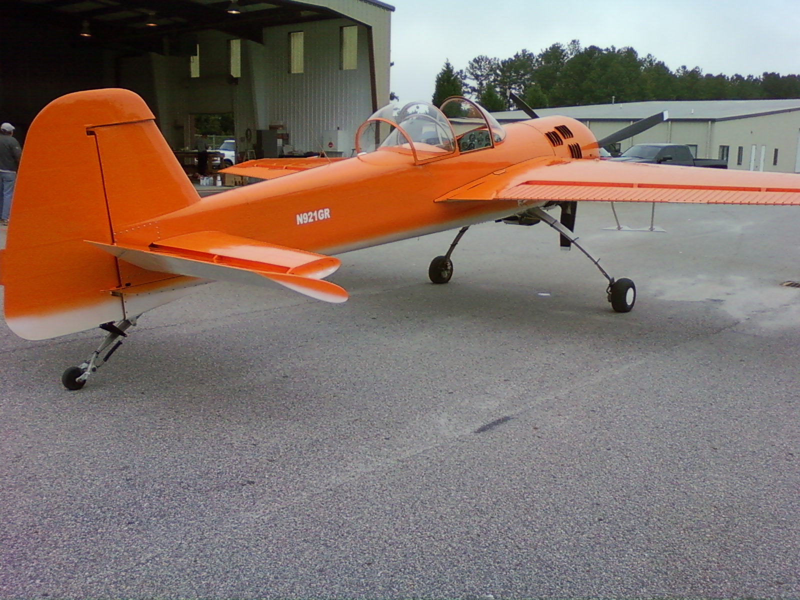

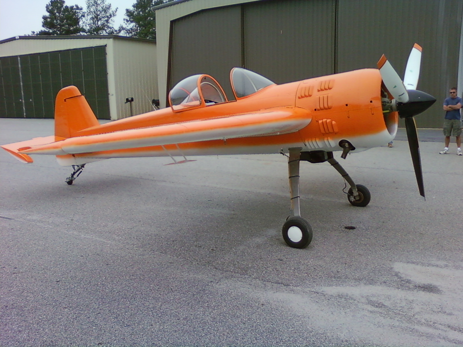

    Fellow 55'rs, Thanks for the replies to my balancing request. In short for those of you who are still interested, I have come to the conclusion that there are no published specs on the balance limits published for after paint for the 55M. If the factory balance weights are still installed on the Rudder and Elevator, then they should still be within design specs even after a recover and repaint. I used the Polly Fiber cover system except for tapes. There I went the extra mile and used the Double Cover method from Kimball Enterprises (3.4oz then cover again with 1.7oz), which is most known for their seamless award winning finishes on the Pitts Model 12. I also went back to the original Russian style rib stitching as it provided the most seamless results possible. (See Attached for stitch pattern) For the ultimate finish I had Advanced Aircraft Refinishers in Griffin, GA shoot the top coats. They are award wining painters and are known for the finish on the 2007 AOPA aircraft sweepstakes plane. Its definitely the best wet look I have seen on a plane in a while and the fabric looked almost like fiberglass when completed. For the rest of you wondering, yes the back of the prop tips are painted white. This is a formation flying technique for those who fly tight formation a lot. Attached are the photos of the finish paint. Now off to trim which will be completed with high performance 2 mil vinyl. -------- Mark- Tumbling Tiger Airshows Read this topic online here: http://forums.matronics.com/viewtopic.php?p=269375#269375 Attachments: http://forums.matronics.com//files/sspx0658_641.jpg http://forums.matronics.com//files/sspx0657_986.jpg http://forums.matronics.com//files/stiching_diag_181.pdf
