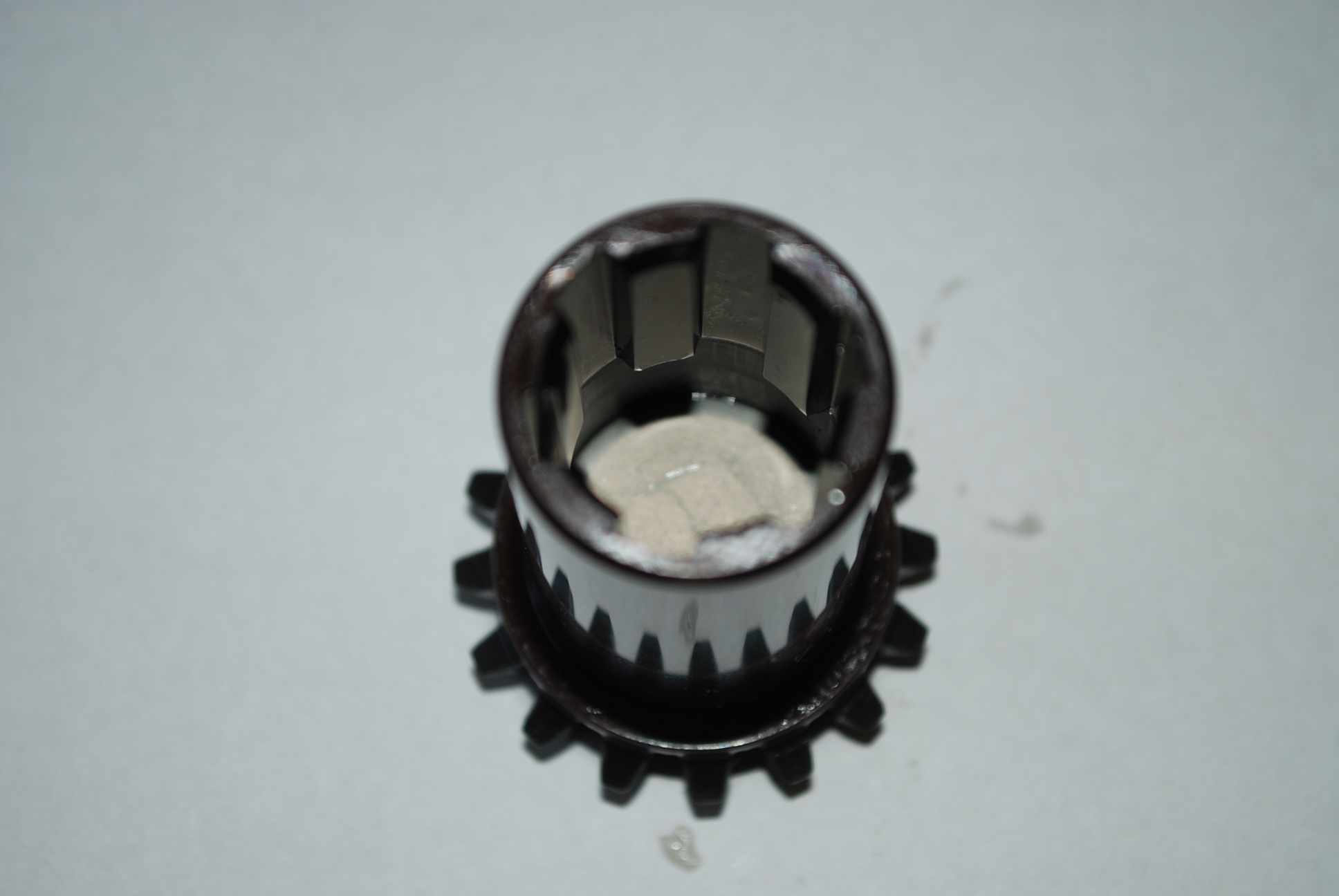

The design of the Housai and M-14P generators are different in how the
lower bearing on the generator is oiled. Hence, the pinion drive gear
is different.
I have attached three pictures of the M-14P pinion drive gear here.
Note the gear has a metal plug at the base. The Housai gear does not.
In the B&C application, this metal plug serves two purposes:
1) it keeps oil out of the bottom of the alternator during aerobatics
(a very good thing), and;
2) it provides support to the male shaft that fits into the female
splined part of the pinion gear. Without this support, the male shaft,
due to gravity, vibration, etc will fall out of the shear coupling that
is on the alternator. When this happens, the alternator stops spinning
(now you are flying off battery power only). This can also cause the
shear coupling in the B&C design to fail. (the shear coupling is
replaceable and is there to protect the engine in the rare case of a
bearing in the alternator seizing).
Bill (owner of B&C) was considering making an injection moulded male
shaft with a collar on it that would prevent the shaft from falling out
of the shear coupling. This only solves item 2. However, he did have
one customer who had a hole worn thru the metal plug after many hours of
flying. So, the injection moulded part was to prevent this from
happening. What is unknown is what the wear on the collar may/will be.
I hope this helps.
Craig
