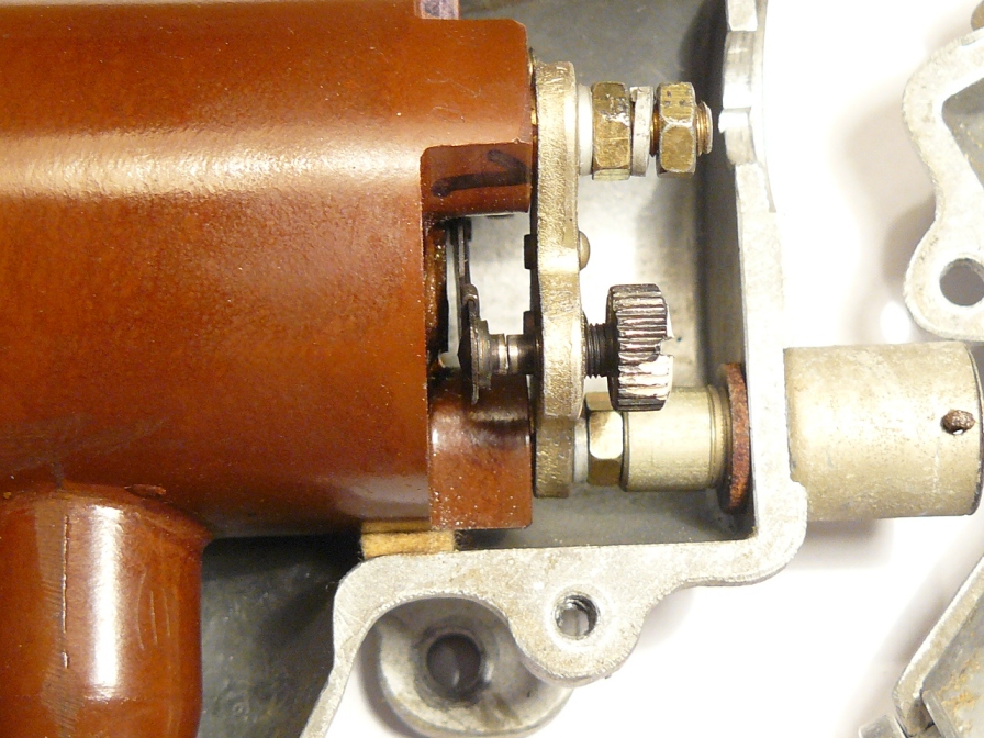

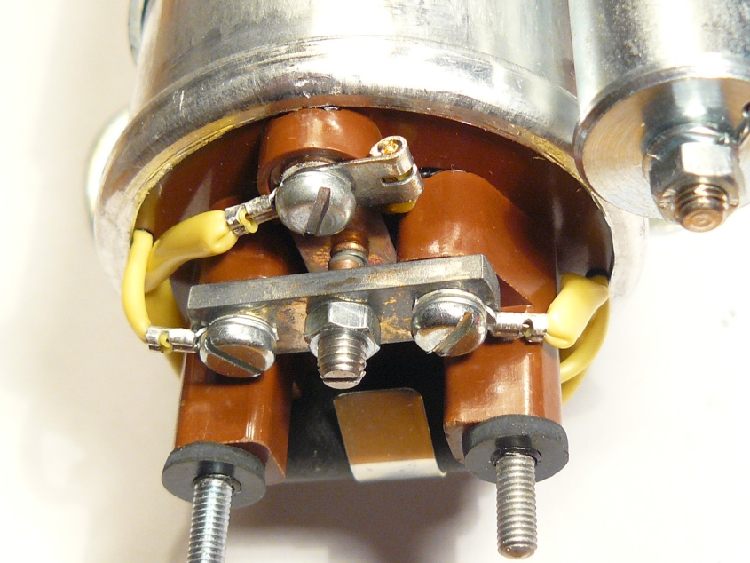

Hello,
some time ago I found a perfect replacement for the buzzer coil. It is a 24
V coil with buzzer, military equipment. It produces half an inch spark. They
turn up occasionally, new old stock, vacuum packed in aluminium. So, if
nobody objects, Id put a short notice here to make them available to the
Yakkers. I am a private, no dealer, but a little profit should be allright ?
At the moment there is one to give away, offers by PM.
Vic
http://forums.matronics.com/viewtopic.php?p=312806#312806
http://forums.matronics.com//files/buzzer_contacts_333.jpg
http://forums.matronics.com//files/new_coil_209.jpg
http://forums.matronics.com//files/contacts_185.jpg
http://forums.matronics.com//files/original_coil_143.jpg
