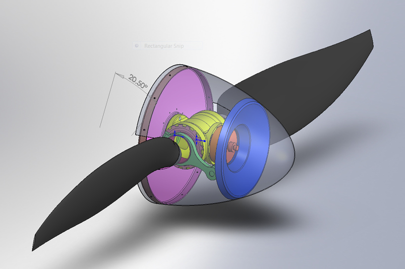

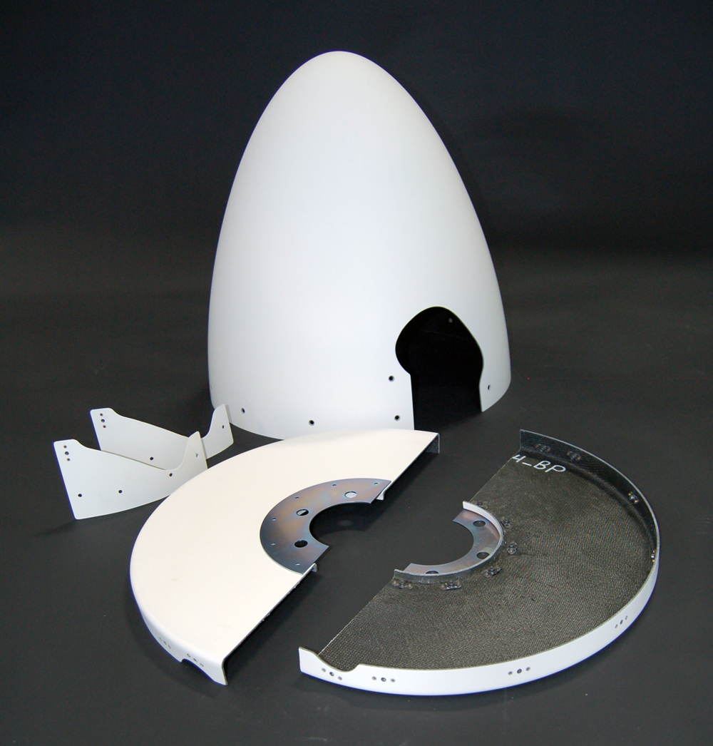

Spinners
We also have a new composite 20" diameter spinner that will turn your trainer into
a fighter. The spinner comes with front & rear bulkheads installed, nutplates
installed. The spinner will arrive fitted & trimmed with a primer coat ready
for paint. The current price is $1,500 USD plus shipping.
