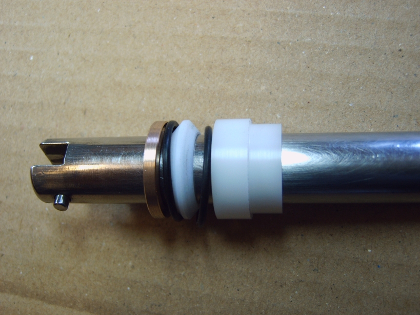

from within the cockpit. It is true that the action of the plunger is not really
smooth with an o-ring acting on the steel plunger in non lubricating gasoline.
So we made up a set of seals from teflon and nylon/polyamide plus o-rings
as elastics - no more problems.
