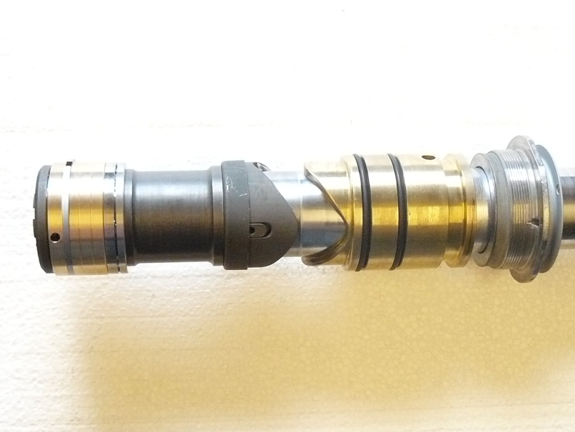

Message 6
| Subject: | Re: Undercarriage |
Hi Didier, Chris,
for dismantling the struts you may need two special spanners, as you see in the
photo above. Didier, you can have them for a while - winter, I think, would be
ideal for the job. Maybe we meet in Eggenfelden some day for you to pick them
up. Also I made up some sort of shoe horn to help the piston ring over the shoulder
in the strut. This is a pipe with 65mm o.d. and 62mm i.d. and ~200mm long
cut in two halves. The nose wheel is different by few mms, I can check sizes
later. The seals can be found in hydraulics industry supplies for piston rods
with 52mm and 50mm dia. as dust wipers. And next to these I put o-rings in
to keep the grease inside the strut. You need adapter rings for the seals to position
them in the milled nut where the felt was before.
The photo below shows the spring loaded damper valve with no backlash to get rid
of the knocking on rough airstrips. Still not yet tested on real rough stuff
but I am confident ...
Cheers
Vic
http://forums.matronics.com/viewtopic.php?p=346704#346704
http://forums.matronics.com//files/damper_valve_orig_148.jpg
http://forums.matronics.com//files/main_gear_mod_160.jpg
http://forums.matronics.com//files/nose_gear_original_889.jpg

Message 7
G'Day Vic,
Thank for the photos.
I have printed them and will check it out later today.
Do you have any info on the seals that you bought such as manufacturer and
numbers?
Cheers,
Chris.
