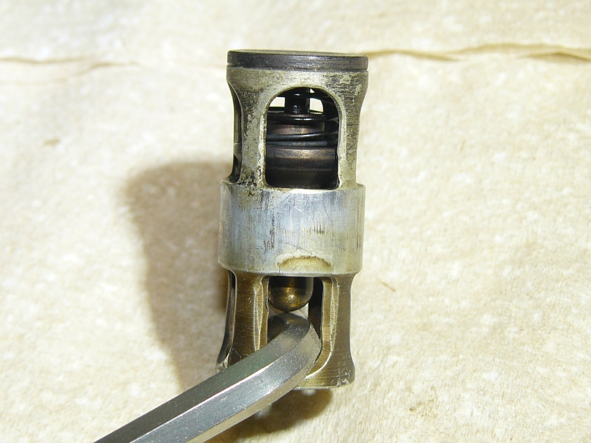

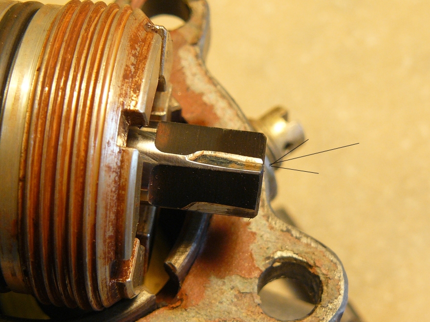

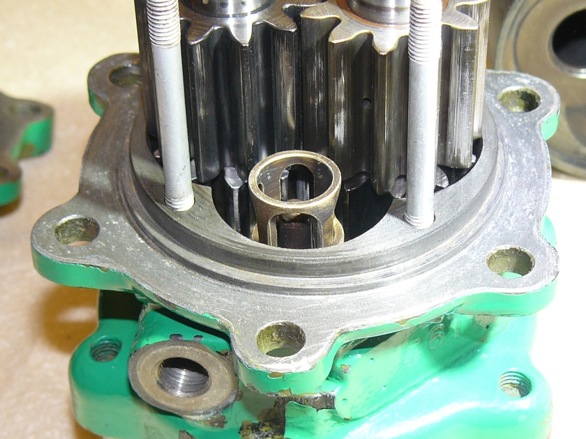

Hello,
recently had the oil pump removed to check seals - in the fuel pump as well. The
check valve was an easy push fit, so this was not correct ? Yes, the oil tank
leaks into the engine somewhat, no problem, have fitted a shut-off ball valve
in the feed hose to the pump. What worried me more was the wear on the flats
of the fuel pump drive shaft because this was assembled dry in the past - with
steel dust collecting in the space between pumps - not great for the seals.
So I filled the space with PTFE/teflon grease.
Does anyone have an idea what the pipe connection on the fuel pump is for ? This
leads between the two seals to this groove with holes. I utilized this access
to fill up the space with grease in order to lube the seals : Gasoline is not
great for shaft seals.

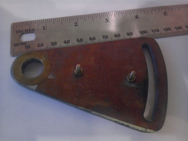

Sorting through multiple fuel indication and low fuel warning issues on my TechnoAvia
SP55M.
Going to have to replace the cheap westach guage with one that I can calibrate
to the voltage output of my fuel senders. Anyone have any experience with Aerospace
Logic programmable fuel level gauges?
Also looking for a part. See attached photo. This is a switch that activates
the right fuel tank low light. It is magnetically activated. Could not get any
continuity between the posts. The switch part is glued into the back of this
piece. Would this be a common part with any of the other Yaks or CJ's? I
need one.
Also need a float for the left fuel low indication light. Looked in the tank and
my float don't float.
So if anyone is familiar with TechnoAvia fuel system parts and where to buy some,
please send me the info.

Vic;
I suspect you are looking at the cavity drain line connection. Should be
one on each side of the fuel pump (1/8" NPT). One is used with a fitting
and pipeline to overboard which is checked periodically for any fuel flow
indicating pump seal leakage. The other should be plugged.

access to fill up the space with grease in order to lube the seals :
Gasoline is not great for shaft seals.
