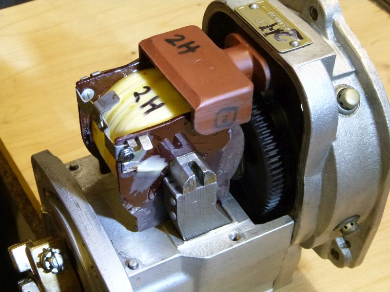

    Jill/All, Recent threads on the subject of mag problems and total cuts in flights etc . suggest changing the mag coil cures the problem. I've recently changed one on my M14P Yak52, only to be presented with the s ame problem again on the replaced coil. (Everything else has been checked o ut). Discussions with various people seem to point to it being an "age" breakdow n problem with the coils rather than a "amount of use" problem. So, the question is, does anyone have a supply of KNOWN GOOD coils that can be used as a replacement? If anyone DOES, can they let me know price including shipping to the UK? Or , and alternative source of supply (Termikas tell me "not available" and "unable to overhaul"). Thanks in advance everyone... Regards, Nigel Willson Flying Instructor/Examiner and Display Pilot _________________________________________________ email: nigel@yakdisplay.com<mailto:nigel@yakdisplay.com> mobile: (+44) 7809 116676 web: http://yakdisplay.com<http://yakdisplay.com/> [Description: cid:image001.png@01C8A476.2E19D440]

    Maybe you want to try Aerometal Kft in Budapest. They have changed one coil on my M-14 Regards 2015-07-27 12:22 GMT+01:00 Nigel Willson <nigel@yakdisplay.com>: > Jill/All, > > > Recent threads on the subject of mag problems and total cuts in flights > etc. suggest changing the mag coil cures the problem. > > > I=99ve recently changed one on my M14P Yak52, only to be presented with the > same problem again on the replaced coil. (Everything else has been checke d > out). > > > Discussions with various people seem to point to it being an =9Dage =9D > breakdown problem with the coils rather than a =9Camount of use =9D problem. > > > So, the question is, does anyone have a supply of KNOWN GOOD coils that > can be used as a replacement? > > > If anyone DOES, can they let me know price including shipping to the UK? > Or, and alternative source of supply (Termikas tell me =9Cnot ava ilable=9D > and =9Cunable to overhaul=9D). > > > Thanks in advance everyone > > > *Regards,* > > *Nigel Willson* > > *Flying Instructor/Examiner and Display Pilot* > > _________________________________________________ > * email*: *nigel@yakdisplay.com* <nigel@yakdisplay.com> > *mobile*: (+44) 7809 116676 > *web*: http://yakdisplay.com > [image: Description: cid:image001.png@01C8A476.2E19D440] > > -- Pedro Cerveira Pinto

    You say that the problem continued with a "new" coil - I suspect you have anticipated the problem yourself in that I suspect the replacement coil was also not working well. After almost 30 years with these engines, I can say that almost any high-tension ignition problem does come down to magneto coils or, on occasions, the high-tension wiring. Coils are a significant problem. M 14 P Inc are making new ones, as we in Hungary. We know that ours are perfect, but our level of production is such that we need to reserve most of them for our engine overhaul customers, but can supply some to others if they want. If anyone is interested, please come back to me off list. Richard Goode Rhodds Farm Lyonshall Hereford HR5 3LW United Kingdom Tel: +94 (0) 81 241 5137 (Sri Lanka) Tel: +44 (0) 1544 340120 Fax: +44 (0) 1544 340129 <http://www.russianaeros.com> www.russianaeros.com I'm currently in Sri Lanka but this Mail is working,and my local phone is +94 779 132 160. From: owner-yak-list-server@matronics.com [mailto:owner-yak-list-server@matronics.com] On Behalf Of Nigel Willson Sent: Monday, July 27, 2015 4:52 PM Subject: Yak-List: M14P mag coils (YAk52) Jill/All, Recent threads on the subject of mag problems and total cuts in flights etc. suggest changing the mag coil cures the problem. I've recently changed one on my M14P Yak52, only to be presented with the same problem again on the replaced coil. (Everything else has been checked out). Discussions with various people seem to point to it being an "age" breakdown problem with the coils rather than a "amount of use" problem. So, the question is, does anyone have a supply of KNOWN GOOD coils that can be used as a replacement? If anyone DOES, can they let me know price including shipping to the UK? Or, and alternative source of supply (Termikas tell me "not available" and "unable to overhaul"). Thanks in advance everyone. Regards, Nigel Willson Flying Instructor/Examiner and Display Pilot _________________________________________________ email: <mailto:nigel@yakdisplay.com> nigel@yakdisplay.com mobile: (+44) 7809 116676 web: <http://yakdisplay.com/> http://yakdisplay.com Description: cid:image001.png@01C8A476.2E19D440 -- This message has been scanned for viruses and dangerous content by <http://www.mailscanner.info/> MailScanner, and is believed to be clean.

    None of my business Nigel, but if you don't mind I'd like to ask a question. Assuming your engine is having "total cuts in flight", and you know which mag you think is causing the problem, have you ever turned that mag completely OFF with the mag switch and tested to see if the condition continues? And another suggestion that may sound rather dumb, but ...... . I have seen the wiring to the mag switch reversed on more than one occasion. This obviously can lead the owner to think the wrong mag is bad. Simply put an ohm-meter on the P lead and check to see which switch position grounds it JUST TO BE SURE. My 2 cents only. Mark -----Original Message----- From: owner-yak-list-server@matronics.com [mailto:owner-yak-list-server@matronics.com] On Behalf Of Richard Goode Sent: Monday, July 27, 2015 9:11 AM Subject: RE: Yak-List: M14P mag coils (YAk52) You say that the problem continued with a "new" coil - I suspect you have anticipated the problem yourself in that I suspect the replacement coil was also not working well. After almost 30 years with these engines, I can say that almost any high-tension ignition problem does come down to magneto coils or, on occasions, the high-tension wiring. Coils are a significant problem. M 14 P Inc are making new ones, as we in Hungary. We know that ours are perfect, but our level of production is such that we need to reserve most of them for our engine overhaul customers, but can supply some to others if they want. If anyone is interested, please come back to me off list. Richard Goode Rhodds Farm Lyonshall Hereford HR5 3LW United Kingdom Tel: +94 (0) 81 241 5137 (Sri Lanka) Tel: +44 (0) 1544 340120 Fax: +44 (0) 1544 340129 www.russianaeros.com <http://www.russianaeros.com> I'm currently in Sri Lanka but this Mail is working,and my local phone is +94 779 132 160. From: owner-yak-list-server@matronics.com [mailto:owner-yak-list-server@matronics.com] On Behalf Of Nigel Willson Sent: Monday, July 27, 2015 4:52 PM Subject: Yak-List: M14P mag coils (YAk52) Jill/All, Recent threads on the subject of mag problems and total cuts in flights etc. suggest changing the mag coil cures the problem. I've recently changed one on my M14P Yak52, only to be presented with the same problem again on the replaced coil. (Everything else has been checked out). Discussions with various people seem to point to it being an "age" breakdown problem with the coils rather than a "amount of use" problem. So, the question is, does anyone have a supply of KNOWN GOOD coils that can be used as a replacement? If anyone DOES, can they let me know price including shipping to the UK? Or, and alternative source of supply (Termikas tell me "not available" and "unable to overhaul"). Thanks in advance everyone... Regards, Nigel Willson Flying Instructor/Examiner and Display Pilot _________________________________________________ email: nigel@yakdisplay.com <mailto:nigel@yakdisplay.com> mobile: (+44) 7809 116676 web: http://yakdisplay.com <http://yakdisplay.com/> Description: cid:image001.png@01C8A476.2E19D440 -- This message has been scanned for viruses and dangerous content by MailScanner <http://www.mailscanner.info/> , and is believed to be clean.

    Thanks Mark. Yes, p-leads have been traced to ensure correct mag was looked at. And when I say total cut, I had a rough engine, and selected mags indi vidually in flight to see which was causing the problem. On mag2, got a tot al cut. Mag1 ran fine. Regards, Nigel Willson Flying Instructor / Examiner Display Pilot Tel. 07809 116676 Web. yakdisplay.com Sent from my HTC One mini 2 ----- Reply message ----- From: "Bitterlich, Mark G CIV NAVAIR, WD" <mark.bitterlich@navy.mil> Subject: Yak-List: M14P mag coils (YAk52) itterlich@navy.mil> None of my business Nigel, but if you don't mind I'd like to ask a question . Assuming your engine is having "total cuts in flight", and you know which m ag you think is causing the problem, have you ever turned that mag complete ly OFF with the mag switch and tested to see if the condition continues? And another suggestion that may sound rather dumb, but ...... . I have seen the wiring to the mag switch reversed on more than one occasion . This obviously can lead the owner to think the wrong mag is bad. Simpl y put an ohm-meter on the P lead and check to see which switch position gro unds it JUST TO BE SURE. My 2 cents only. Mark -----Original Message----- From: owner-yak-list-server@matronics.com [mailto:owner-yak-list-server@mat ronics.com] On Behalf Of Richard Goode Sent: Monday, July 27, 2015 9:11 AM Subject: RE: Yak-List: M14P mag coils (YAk52) You say that the problem continued with a "new" coil - I suspect you have a nticipated the problem yourself in that I suspect the replacement coil was also not working well. After almost 30 years with these engines, I can say that almost any high-te nsion ignition problem does come down to magneto coils or, on occasions, th e high-tension wiring. Coils are a significant problem. M 14 P Inc are making new ones, as we in H ungary. We know that ours are perfect, but our level of production is such that we need to reserve most of them for our engine overhaul customers, but can supply some to others if they want. If anyone is interested, please come back to me off list. Richard Goode Rhodds Farm Lyonshall Hereford HR5 3LW United Kingdom Tel: +94 (0) 81 241 5137 (Sri Lanka) Tel: +44 (0) 1544 340120 Fax: +44 (0) 1544 340129 www.russianaeros.com<http://www.russianaeros.com> <http://www.russianaeros. com> I'm currently in Sri Lanka but this Mail is working,and my local phone is + 94 779 132 160. From: owner-yak-list-server@matronics.com [mailto:owner-yak-list-server@mat ronics.com] On Behalf Of Nigel Willson Sent: Monday, July 27, 2015 4:52 PM Subject: Yak-List: M14P mag coils (YAk52) Jill/All, Recent threads on the subject of mag problems and total cuts in flights etc . suggest changing the mag coil cures the problem. I've recently changed one on my M14P Yak52, only to be presented with the s ame problem again on the replaced coil. (Everything else has been checked o ut). Discussions with various people seem to point to it being an "age" breakdow n problem with the coils rather than a "amount of use" problem. So, the question is, does anyone have a supply of KNOWN GOOD coils that can be used as a replacement? If anyone DOES, can they let me know price including shipping to the UK? Or , and alternative source of supply (Termikas tell me "not available" and "unable to overhaul"). Thanks in advance everyone... Regards, Nigel Willson Flying Instructor/Examiner and Display Pilot _________________________________________________ email: nigel@yakdisplay.com <mailto:nigel@yakdisplay.com> mobile: (+44) 7809 116676 web: http://yakdisplay.com <http://yakdisplay.com/> Description: cid:image001.png@01C8A476.2E19D440 -- This message has been scanned for viruses and dangerous content by MailScan ner <http://www.mailscanner.info/> , and is believed to be clean.

    Nigel, Did you verify the points are opening and closing properly and set to .25-.35mm? See if the foot of the points is still there and not worn down to where it does not contact the point cam. Poor lubrication of the cam causes the foot to wear significantly. If the points are not opening, the mag will not fire. Did you check the high voltage stick to make sure it was not arcing to ground on the side of it? Sometimes the high voltage stick is cracked. Especially right around the part of the stick that is protruding just above the hole in fits into. If it cracks, the voltage from the coil will never make it to the cap because it is arcing to ground. Dennis A. Dennis Savarese 334-546-8182 (mobile) www.yak-52.com Skype - Yakguy1 On 7/27/2015 10:31 AM, Nigel Willson wrote: > Thanks Mark. Yes, p-leads have been traced to ensure correct mag was > looked at. And when I say total cut, I had a rough engine, and > selected mags individually in flight to see which was causing the > problem. On mag2, got a total cut. Mag1 ran fine. > > Regards, > > Nigel Willson > Flying Instructor / Examiner > Display Pilot > > Tel. 07809 116676 > Web. yakdisplay.com > > Sent from my HTC One mini 2 > > ----- Reply message ----- > From: "Bitterlich, Mark G CIV NAVAIR, WD" <mark.bitterlich@navy.mil> > To: "yak-list@matronics.com" <yak-list@matronics.com> > Subject: Yak-List: M14P mag coils (YAk52) > Date: Mon, Jul 27, 2015 16:20 > > <mark.bitterlich@navy.mil> > > None of my business Nigel, but if you don't mind I'd like to ask a > question. > > Assuming your engine is having "total cuts in flight", and you know > which mag you think is causing the problem, have you ever turned that > mag completely OFF with the mag switch and tested to see if the > condition continues? > > And another suggestion that may sound rather dumb, but ...... . > > I have seen the wiring to the mag switch reversed on more than one > occasion. This obviously can lead the owner to think the wrong mag is > bad. Simply put an ohm-meter on the P lead and check to see which > switch position grounds it JUST TO BE SURE. > > My 2 cents only. > > Mark > > > -----Original Message----- > From: owner-yak-list-server@matronics.com > [mailto:owner-yak-list-server@matronics.com] On Behalf Of Richard Goode > Sent: Monday, July 27, 2015 9:11 AM > To: yak-list@matronics.com > Subject: RE: Yak-List: M14P mag coils (YAk52) > > You say that the problem continued with a "new" coil - I suspect you > have anticipated the problem yourself in that I suspect the > replacement coil was also not working well. > > > After almost 30 years with these engines, I can say that almost any > high-tension ignition problem does come down to magneto coils or, on > occasions, the high-tension wiring. > > > Coils are a significant problem. M 14 P Inc are making new ones, as we > in Hungary. We know that ours are perfect, but our level of production > is such that we need to reserve most of them for our engine overhaul > customers, but can supply some to others if they want. > > > If anyone is interested, please come back to me off list. > > > Richard Goode > > > Rhodds Farm > > Lyonshall > > Hereford > > HR5 3LW > > United Kingdom > > Tel: +94 (0) 81 241 5137 (Sri Lanka) > > Tel: +44 (0) 1544 340120 > > Fax: +44 (0) 1544 340129 > > www.russianaeros.com <http://www.russianaeros.com> > <http://www.russianaeros.com> > > I'm currently in Sri Lanka but this Mail is working,and my local phone > is +94 779 132 160. > > > From: owner-yak-list-server@matronics.com > [mailto:owner-yak-list-server@matronics.com] On Behalf Of Nigel Willson > Sent: Monday, July 27, 2015 4:52 PM > To: info@m-14p.com; yak-list@matronics.com > Subject: Yak-List: M14P mag coils (YAk52) > > > Jill/All, > > > Recent threads on the subject of mag problems and total cuts in > flights etc. suggest changing the mag coil cures the problem. > > > I've recently changed one on my M14P Yak52, only to be presented with > the same problem again on the replaced coil. (Everything else has been > checked out). > > > Discussions with various people seem to point to it being an "age" > breakdown problem with the coils rather than a "amount of use" problem. > > > So, the question is, does anyone have a supply of KNOWN GOOD coils > that can be used as a replacement? > > > If anyone DOES, can they let me know price including shipping to the > UK? Or, and alternative source of supply (Termikas tell me "not > available" and "unable to overhaul"). > > > Thanks in advance everyone... > > > Regards, > > Nigel Willson > > Flying Instructor/Examiner and Display Pilot > > _________________________________________________ > email: nigel@yakdisplay.com <mailto:nigel@yakdisplay.com> > mobile: (+44) 7809 116676 > web: http://yakdisplay.com <http://yakdisplay.com/> > Description: cid:image001.png@01C8A476.2E19D440 > > > -- > This message has been scanned for viruses and dangerous content by > MailScanner <http://www.mailscanner.info/> , and is believed to be clean. > > > ========== > Email Forum - > List">http://www.matronics.com/Navigator?Yak-List > ========== > p; - MATRONICS WEB FORUMS - > ums.matronics.com > ========== > p; - List Contribution Web Site - > p; -Matt Dralle, List Admin. > http://www.matronics.com/contribution > ========== > > > http://www.matronics.com/contribution

    Thanks Dennis. Will pass it on to the maintenance guys. I suspect they have checked these things already though. They have been looking after yams for years. The problem has been intermittent so far, except for the last fligh t. Strangely after a coil change... Regards, Nigel Willson Flying Instructor / Examiner Display Pilot Tel. 07809 116676 Web. yakdisplay.com Sent from my HTC One mini 2 ----- Reply message ----- From: "A. Dennis Savarese" <dsavarese0812@bellsouth.net> Subject: Yak-List: M14P mag coils (YAk52) th.net> Nigel, Did you verify the points are opening and closing properly and set to .25-.35mm? See if the foot of the points is still there and not worn down to where it does not contact the point cam. Poor lubrication of the cam causes the foot to wear significantly. If the points are not opening, the mag will not fire. Did you check the high voltage stick to make sure it was not arcing to ground on the side of it? Sometimes the high voltage stick is cracked. Especially right around the part of the stick that is protruding just above the hole in fits into. If it cracks, the voltage from the coil will never make it to the cap because it is arcing to ground. Dennis A. Dennis Savarese 334-546-8182 (mobile) www.yak-52.com<http://www.yak-52.com> Skype - Yakguy1 On 7/27/2015 10:31 AM, Nigel Willson wrote: > Thanks Mark. Yes, p-leads have been traced to ensure correct mag was > looked at. And when I say total cut, I had a rough engine, and > selected mags individually in flight to see which was causing the > problem. On mag2, got a total cut. Mag1 ran fine. > > Regards, > > Nigel Willson > Flying Instructor / Examiner > Display Pilot > > Tel. 07809 116676 > Web. yakdisplay.com > > Sent from my HTC One mini 2 > > ----- Reply message ----- > From: "Bitterlich, Mark G CIV NAVAIR, WD" <mark.bitterlich@navy.mil> > To: "yak-list@matronics.com" <yak-list@matronics.com> > Subject: Yak-List: M14P mag coils (YAk52) > Date: Mon, Jul 27, 2015 16:20 > > <mark.bitterlich@navy.mil> > > None of my business Nigel, but if you don't mind I'd like to ask a > question. > > Assuming your engine is having "total cuts in flight", and you know > which mag you think is causing the problem, have you ever turned that > mag completely OFF with the mag switch and tested to see if the > condition continues? > > And another suggestion that may sound rather dumb, but ...... . > > I have seen the wiring to the mag switch reversed on more than one > occasion. This obviously can lead the owner to think the wrong mag is > bad. Simply put an ohm-meter on the P lead and check to see which > switch position grounds it JUST TO BE SURE. > > My 2 cents only. > > Mark > > > -----Original Message----- > From: owner-yak-list-server@matronics.com > [mailto:owner-yak-list-server@matronics.com] On Behalf Of Richard Goode > Sent: Monday, July 27, 2015 9:11 AM > To: yak-list@matronics.com > Subject: RE: Yak-List: M14P mag coils (YAk52) > > You say that the problem continued with a "new" coil - I suspect you > have anticipated the problem yourself in that I suspect the > replacement coil was also not working well. > > > After almost 30 years with these engines, I can say that almost any > high-tension ignition problem does come down to magneto coils or, on > occasions, the high-tension wiring. > > > Coils are a significant problem. M 14 P Inc are making new ones, as we > in Hungary. We know that ours are perfect, but our level of production > is such that we need to reserve most of them for our engine overhaul > customers, but can supply some to others if they want. > > > If anyone is interested, please come back to me off list. > > > Richard Goode > > > Rhodds Farm > > Lyonshall > > Hereford > > HR5 3LW > > United Kingdom > > Tel: +94 (0) 81 241 5137 (Sri Lanka) > > Tel: +44 (0) 1544 340120 > > Fax: +44 (0) 1544 340129 > > www.russianaeros.com<http://www.russianaeros.com> <http://www.russianaero s.com> > <http://www.russianaeros.com> > > I'm currently in Sri Lanka but this Mail is working,and my local phone > is +94 779 132 160. > > > From: owner-yak-list-server@matronics.com > [mailto:owner-yak-list-server@matronics.com] On Behalf Of Nigel Willson > Sent: Monday, July 27, 2015 4:52 PM > To: info@m-14p.com; yak-list@matronics.com > Subject: Yak-List: M14P mag coils (YAk52) > > > Jill/All, > > > Recent threads on the subject of mag problems and total cuts in > flights etc. suggest changing the mag coil cures the problem. > > > I've recently changed one on my M14P Yak52, only to be presented with > the same problem again on the replaced coil. (Everything else has been > checked out). > > > Discussions with various people seem to point to it being an "age" > breakdown problem with the coils rather than a "amount of use" problem. > > > So, the question is, does anyone have a supply of KNOWN GOOD coils > that can be used as a replacement? > > > If anyone DOES, can they let me know price including shipping to the > UK? Or, and alternative source of supply (Termikas tell me "not > available" and "unable to overhaul"). > > > Thanks in advance everyone... > > > Regards, > > Nigel Willson > > Flying Instructor/Examiner and Display Pilot > > _________________________________________________ > email: nigel@yakdisplay.com <mailto:nigel@yakdisplay.com> > mobile: (+44) 7809 116676 > web: http://yakdisplay.com <http://yakdisplay.com/> > Description: cid:image001.png@01C8A476.2E19D440 > > > -- > This message has been scanned for viruses and dangerous content by > MailScanner <http://www.mailscanner.info/> , and is believed to be clean. > > > ========== > Email Forum - > List">http://www.matronics.com/Navigator?Yak-List > ========== > p; - MATRONICS WEB FORUMS - > ums.matronics.com > ========== > p; - List Contribution Web Site - > p; -Matt Dralle, List Admin. > http://www.matronics.com/contribution > ========== > > > http://www.matronics.com/contribution

    Nigel, I have to concur with Dennis, it is kind of logical that if you change the coil and have the exact same problem, it might be something else. He pointed out the two "logical something else's" that I was getting ready to say. Other than those two ... the only other weird thing I have seen is the actual P lead wire that was under a tie wrap that cut into it and caused the P lead to short to ground with engine vibration. That one was extremely tough to find. Mark -----Original Message----- From: owner-yak-list-server@matronics.com [mailto:owner-yak-list-server@matronics.com] On Behalf Of Nigel Willson Sent: Monday, July 27, 2015 12:06 PM Subject: Re: Yak-List: M14P mag coils (YAk52) Thanks Dennis. Will pass it on to the maintenance guys. I suspect they have checked these things already though. They have been looking after yams for years. The problem has been intermittent so far, except for the last flight. Strangely after a coil change... Regards, Nigel Willson Flying Instructor / Examiner Display Pilot Tel. 07809 116676 Web. yakdisplay.com Sent from my HTC One mini 2 ----- Reply message ----- From: "A. Dennis Savarese" <dsavarese0812@bellsouth.net> Subject: Yak-List: M14P mag coils (YAk52) --> <dsavarese0812@bellsouth.net> Nigel, Did you verify the points are opening and closing properly and set to .25-.35mm? See if the foot of the points is still there and not worn down to where it does not contact the point cam. Poor lubrication of the cam causes the foot to wear significantly. If the points are not opening, the mag will not fire. Did you check the high voltage stick to make sure it was not arcing to ground on the side of it? Sometimes the high voltage stick is cracked. Especially right around the part of the stick that is protruding just above the hole in fits into. If it cracks, the voltage from the coil will never make it to the cap because it is arcing to ground. Dennis A. Dennis Savarese 334-546-8182 (mobile) www.yak-52.com Skype - Yakguy1 On 7/27/2015 10:31 AM, Nigel Willson wrote: > Thanks Mark. Yes, p-leads have been traced to ensure correct mag was > looked at. And when I say total cut, I had a rough engine, and > selected mags individually in flight to see which was causing the > problem. On mag2, got a total cut. Mag1 ran fine. > > Regards, > > Nigel Willson > Flying Instructor / Examiner > Display Pilot > > Tel. 07809 116676 > Web. yakdisplay.com > > Sent from my HTC One mini 2 > > ----- Reply message ----- > From: "Bitterlich, Mark G CIV NAVAIR, WD" <mark.bitterlich@navy.mil> > To: "yak-list@matronics.com" <yak-list@matronics.com> > Subject: Yak-List: M14P mag coils (YAk52) > Date: Mon, Jul 27, 2015 16:20 > > <mark.bitterlich@navy.mil> > > None of my business Nigel, but if you don't mind I'd like to ask a > question. > > Assuming your engine is having "total cuts in flight", and you know > which mag you think is causing the problem, have you ever turned that > mag completely OFF with the mag switch and tested to see if the > condition continues? > > And another suggestion that may sound rather dumb, but ...... . > > I have seen the wiring to the mag switch reversed on more than one > occasion. This obviously can lead the owner to think the wrong mag is > bad. Simply put an ohm-meter on the P lead and check to see which > switch position grounds it JUST TO BE SURE. > > My 2 cents only. > > Mark > > > -----Original Message----- > From: owner-yak-list-server@matronics.com > [mailto:owner-yak-list-server@matronics.com] On Behalf Of Richard > Goode > Sent: Monday, July 27, 2015 9:11 AM > To: yak-list@matronics.com > Subject: RE: Yak-List: M14P mag coils (YAk52) > > You say that the problem continued with a "new" coil - I suspect you > have anticipated the problem yourself in that I suspect the > replacement coil was also not working well. > > > After almost 30 years with these engines, I can say that almost any > high-tension ignition problem does come down to magneto coils or, on > occasions, the high-tension wiring. > > > Coils are a significant problem. M 14 P Inc are making new ones, as we > in Hungary. We know that ours are perfect, but our level of production > is such that we need to reserve most of them for our engine overhaul > customers, but can supply some to others if they want. > > > If anyone is interested, please come back to me off list. > > > Richard Goode > > > Rhodds Farm > > Lyonshall > > Hereford > > HR5 3LW > > United Kingdom > > Tel: +94 (0) 81 241 5137 (Sri Lanka) > > Tel: +44 (0) 1544 340120 > > Fax: +44 (0) 1544 340129 > > www.russianaeros.com <http://www.russianaeros.com> > <http://www.russianaeros.com> > > I'm currently in Sri Lanka but this Mail is working,and my local phone > is +94 779 132 160. > > > From: owner-yak-list-server@matronics.com > [mailto:owner-yak-list-server@matronics.com] On Behalf Of Nigel > Willson > Sent: Monday, July 27, 2015 4:52 PM > To: info@m-14p.com; yak-list@matronics.com > Subject: Yak-List: M14P mag coils (YAk52) > > > Jill/All, > > > Recent threads on the subject of mag problems and total cuts in > flights etc. suggest changing the mag coil cures the problem. > > > I've recently changed one on my M14P Yak52, only to be presented with > the same problem again on the replaced coil. (Everything else has been > checked out). > > > Discussions with various people seem to point to it being an "age" > breakdown problem with the coils rather than a "amount of use" problem. > > > So, the question is, does anyone have a supply of KNOWN GOOD coils > that can be used as a replacement? > > > If anyone DOES, can they let me know price including shipping to the > UK? Or, and alternative source of supply (Termikas tell me "not > available" and "unable to overhaul"). > > > Thanks in advance everyone... > > > Regards, > > Nigel Willson > > Flying Instructor/Examiner and Display Pilot > > _________________________________________________ > email: nigel@yakdisplay.com <mailto:nigel@yakdisplay.com> > mobile: (+44) 7809 116676 > web: http://yakdisplay.com <http://yakdisplay.com/> > Description: cid:image001.png@01C8A476.2E19D440 > > > -- > This message has been scanned for viruses and dangerous content by > MailScanner <http://www.mailscanner.info/> , and is believed to be clean. > > > ========== > Email Forum - > List">http://www.matronics.com/Navigator?Yak-List > ========== > p; - MATRONICS WEB FORUMS - > ums.matronics.com > ========== > p; - List Contribution Web Site - > p; -Matt Dralle, List Admin. > http://www.matronics.com/contribution > ========== > > > http://www.matronics.com/contribution ========== Email Forum - List">http://www.matronics.com/Navigator?Yak-List ========== p; - MATRONICS WEB FORUMS - ums.matronics.com ========== p; - List Contribution Web Site - p; -Matt Dralle, List Admin. http://www.matronics.com/contribution ==========

    I'm not saying that what I'm about to say defines the problem. But when a coil is replaced, thetop contact in the coil touches the high voltage stick. Plus the wire from the coil is passed up through a hole and affixed to the block right next to the stick. It is possible the stick moved ever so slightly and is now arcing to ground. Also, it could be the foot on the points has finally worn down to where the foot no longer rubs on the cam. As previously stated, if the points don't open, coil not work-ee. :-) Why not just replace the high voltage stick just for grins and see what happens? BTW, don'tput your finger on it to test it while someone rotates the prop. You might earn a Darwin award if you did. Dennis A. Dennis Savarese 334-546-8182 (mobile) www.yak-52.com Skype - Yakguy1 On 7/27/2015 11:06 AM, Nigel Willson wrote: > Thanks Dennis. Will pass it on to the maintenance guys. I suspect they > have checked these things already though. They have been looking after > yams for years. The problem has been intermittent so far, except for > the last flight. Strangely after a coil change... > > Regards, > > Nigel Willson > Flying Instructor / Examiner > Display Pilot > > Tel. 07809 116676 > Web. yakdisplay.com > > Sent from my HTC One mini 2 > > ----- Reply message ----- > From: "A. Dennis Savarese" <dsavarese0812@bellsouth.net> > To: "yak-list@matronics.com" <yak-list@matronics.com> > Subject: Yak-List: M14P mag coils (YAk52) > Date: Mon, Jul 27, 2015 17:03 > > <dsavarese0812@bellsouth.net> > > Nigel, > Did you verify the points are opening and closing properly and set to > .25-.35mm? See if the foot of the points is still there and not worn > down to where it does not contact the point cam. Poor lubrication of > the cam causes the foot to wear significantly. If the points are not > opening, the mag will not fire. > > Did you check the high voltage stick to make sure it was not arcing to > ground on the side of it? Sometimes the high voltage stick is cracked. > Especially right around the part of the stick that is protruding just > above the hole in fits into. If it cracks, the voltage from the coil > will never make it to the cap because it is arcing to ground. > Dennis > > A. Dennis Savarese > 334-546-8182 (mobile) > www.yak-52.com <http://www.yak-52.com> > Skype - Yakguy1 > > On 7/27/2015 10:31 AM, Nigel Willson wrote: > > Thanks Mark. Yes, p-leads have been traced to ensure correct mag was > > looked at. And when I say total cut, I had a rough engine, and > > selected mags individually in flight to see which was causing the > > problem. On mag2, got a total cut. Mag1 ran fine. > > > > Regards, > > > > Nigel Willson > > Flying Instructor / Examiner > > Display Pilot > > > > Tel. 07809 116676 > > Web. yakdisplay.com > > > > Sent from my HTC One mini 2 > > > > ----- Reply message ----- > > From: "Bitterlich, Mark G CIV NAVAIR, WD" <mark.bitterlich@navy.mil> > > To: "yak-list@matronics.com" <yak-list@matronics.com> > > Subject: Yak-List: M14P mag coils (YAk52) > > Date: Mon, Jul 27, 2015 16:20 > > > > <mark.bitterlich@navy.mil> > > > > None of my business Nigel, but if you don't mind I'd like to ask a > > question. > > > > Assuming your engine is having "total cuts in flight", and you know > > which mag you think is causing the problem, have you ever turned that > > mag completely OFF with the mag switch and tested to see if the > > condition continues? > > > > And another suggestion that may sound rather dumb, but ...... . > > > > I have seen the wiring to the mag switch reversed on more than one > > occasion. This obviously can lead the owner to think the wrong mag is > > bad. Simply put an ohm-meter on the P lead and check to see which > > switch position grounds it JUST TO BE SURE. > > > > My 2 cents only. > > > > Mark > > > > > > -----Original Message----- > > From: owner-yak-list-server@matronics.com > > [mailto:owner-yak-list-server@matronics.com] On Behalf Of Richard Goode > > Sent: Monday, July 27, 2015 9:11 AM > > To: yak-list@matronics.com > > Subject: RE: Yak-List: M14P mag coils (YAk52) > > > > You say that the problem continued with a "new" coil - I suspect you > > have anticipated the problem yourself in that I suspect the > > replacement coil was also not working well. > > > > > > > > After almost 30 years with these engines, I can say that almost any > > high-tension ignition problem does come down to magneto coils or, on > > occasions, the high-tension wiring. > > > > > > > > Coils are a significant problem. M 14 P Inc are making new ones, as we > > in Hungary. We know that ours are perfect, but our level of production > > is such that we need to reserve most of them for our engine overhaul > > customers, but can supply some to others if they want. > > > > > > > > If anyone is interested, please come back to me off list. > > > > > > > > Richard Goode > > > > > > > > Rhodds Farm > > > > Lyonshall > > > > Hereford > > > > HR5 3LW > > > > United Kingdom > > > > Tel: +94 (0) 81 241 5137 (Sri Lanka) > > > > Tel: +44 (0) 1544 340120 > > > > Fax: +44 (0) 1544 340129 > > > > www.russianaeros.com <http://www.russianaeros.com> > <http://www.russianaeros.com> > > <http://www.russianaeros.com> > > > > I'm currently in Sri Lanka but this Mail is working,and my local phone > > is +94 779 132 160. > > > > > > > > From: owner-yak-list-server@matronics.com > > [mailto:owner-yak-list-server@matronics.com] On Behalf Of Nigel Willson > > Sent: Monday, July 27, 2015 4:52 PM > > To: info@m-14p.com; yak-list@matronics.com > > Subject: Yak-List: M14P mag coils (YAk52) > > > > > > > > Jill/All, > > > > > > > > Recent threads on the subject of mag problems and total cuts in > > flights etc. suggest changing the mag coil cures the problem. > > > > > > > > I've recently changed one on my M14P Yak52, only to be presented with > > the same problem again on the replaced coil. (Everything else has been > > checked out). > > > > > > > > Discussions with various people seem to point to it being an "age" > > breakdown problem with the coils rather than a "amount of use" problem. > > > > > > > > So, the question is, does anyone have a supply of KNOWN GOOD coils > > that can be used as a replacement? > > > > > > > > If anyone DOES, can they let me know price including shipping to the > > UK? Or, and alternative source of supply (Termikas tell me "not > > available" and "unable to overhaul"). > > > > > > > > Thanks in advance everyone... > > > > > > > > Regards, > > > > Nigel Willson > > > > Flying Instructor/Examiner and Display Pilot > > > > _________________________________________________ > > email: nigel@yakdisplay.com <mailto:nigel@yakdisplay.com> > > mobile: (+44) 7809 116676 > > web: http://yakdisplay.com <http://yakdisplay.com/> > > Description: cid:image001.png@01C8A476.2E19D440 > > > > > > > > > > -- > > This message has been scanned for viruses and dangerous content by > > MailScanner <http://www.mailscanner.info/> , and is believed to be > clean. > > > > > > > > ========== > > Email Forum - > > List">http://www.matronics.com/Navigator?Yak-List > > ========== > > p; - MATRONICS WEB FORUMS - > > ums.matronics.com > > ========== > > p; - List Contribution Web Site - > > p; -Matt Dralle, List Admin. > > http://www.matronics.com/contribution > > ========== > > > > > > > > http://www.matronics.com/contribution > > > ========== > Email Forum - > List">http://www.matronics.com/Navigator?Yak-List > ========== > p; - MATRONICS WEB FORUMS - > ums.matronics.com > ========== > p; - List Contribution Web Site - > p; -Matt Dralle, List Admin. > http://www.matronics.com/contribution > ========== > > > http://www.matronics.com/contribution

    OK thanks Dennis. But this morning when I had to transit it back to the mtce airfield (10minute flight), all was ok with both mags. Seems to be a temperature related issue.... Regards, Nigel Willson Flying Instructor/Examiner and Display Pilot _________________________________________________ email: nigel@yakdisplay.com mobile: (+44) 7809 116676 web:http://yakdisplay.com -----Original Message----- From: owner-yak-list-server@matronics.com [mailto:owner-yak-list-server@matronics.com] On Behalf Of A. Dennis Savarese Sent: 27 July 2015 17:48 Subject: Re: Yak-List: M14P mag coils (YAk52) --> <dsavarese0812@bellsouth.net> I'm not saying that what I'm about to say defines the problem. But when a coil is replaced, thetop contact in the coil touches the high voltage stick. Plus the wire from the coil is passed up through a hole and affixed to the block right next to the stick. It is possible the stick moved ever so slightly and is now arcing to ground. Also, it could be the foot on the points has finally worn down to where the foot no longer rubs on the cam. As previously stated, if the points don't open, coil not work-ee. :-) Why not just replace the high voltage stick just for grins and see what happens? BTW, don'tput your finger on it to test it while someone rotates the prop. You might earn a Darwin award if you did. Dennis A. Dennis Savarese 334-546-8182 (mobile) www.yak-52.com Skype - Yakguy1 On 7/27/2015 11:06 AM, Nigel Willson wrote: > Thanks Dennis. Will pass it on to the maintenance guys. I suspect they > have checked these things already though. They have been looking after > yams for years. The problem has been intermittent so far, except for > the last flight. Strangely after a coil change... > > Regards, > > Nigel Willson > Flying Instructor / Examiner > Display Pilot > > Tel. 07809 116676 > Web. yakdisplay.com > > Sent from my HTC One mini 2 > > ----- Reply message ----- > From: "A. Dennis Savarese" <dsavarese0812@bellsouth.net> > To: "yak-list@matronics.com" <yak-list@matronics.com> > Subject: Yak-List: M14P mag coils (YAk52) > Date: Mon, Jul 27, 2015 17:03 > > <dsavarese0812@bellsouth.net> > > Nigel, > Did you verify the points are opening and closing properly and set to > .25-.35mm? See if the foot of the points is still there and not worn > down to where it does not contact the point cam. Poor lubrication of > the cam causes the foot to wear significantly. If the points are not > opening, the mag will not fire. > > Did you check the high voltage stick to make sure it was not arcing to > ground on the side of it? Sometimes the high voltage stick is cracked. > Especially right around the part of the stick that is protruding just > above the hole in fits into. If it cracks, the voltage from the coil > will never make it to the cap because it is arcing to ground. > Dennis > > A. Dennis Savarese > 334-546-8182 (mobile) > www.yak-52.com <http://www.yak-52.com> Skype - Yakguy1 > > On 7/27/2015 10:31 AM, Nigel Willson wrote: > > Thanks Mark. Yes, p-leads have been traced to ensure correct mag was > > looked at. And when I say total cut, I had a rough engine, and > > selected mags individually in flight to see which was causing the > > problem. On mag2, got a total cut. Mag1 ran fine. > > > > Regards, > > > > Nigel Willson > > Flying Instructor / Examiner > > Display Pilot > > > > Tel. 07809 116676 > > Web. yakdisplay.com > > > > Sent from my HTC One mini 2 > > > > ----- Reply message ----- > > From: "Bitterlich, Mark G CIV NAVAIR, WD" <mark.bitterlich@navy.mil> > > To: "yak-list@matronics.com" <yak-list@matronics.com> > > Subject: Yak-List: M14P mag coils (YAk52) > > Date: Mon, Jul 27, 2015 16:20 > > > > <mark.bitterlich@navy.mil> > > > > None of my business Nigel, but if you don't mind I'd like to ask a > > question. > > > > Assuming your engine is having "total cuts in flight", and you know > > which mag you think is causing the problem, have you ever turned > > that mag completely OFF with the mag switch and tested to see if the > > condition continues? > > > > And another suggestion that may sound rather dumb, but ...... . > > > > I have seen the wiring to the mag switch reversed on more than one > > occasion. This obviously can lead the owner to think the wrong mag is > > bad. Simply put an ohm-meter on the P lead and check to see which > > switch position grounds it JUST TO BE SURE. > > > > My 2 cents only. > > > > Mark > > > > > > -----Original Message----- > > From: owner-yak-list-server@matronics.com > > [mailto:owner-yak-list-server@matronics.com] On Behalf Of Richard > > Goode > > Sent: Monday, July 27, 2015 9:11 AM > > To: yak-list@matronics.com > > Subject: RE: Yak-List: M14P mag coils (YAk52) > > > > You say that the problem continued with a "new" coil - I suspect you > > have anticipated the problem yourself in that I suspect the > > replacement coil was also not working well. > > > > > > > > After almost 30 years with these engines, I can say that almost any > > high-tension ignition problem does come down to magneto coils or, on > > occasions, the high-tension wiring. > > > > > > > > Coils are a significant problem. M 14 P Inc are making new ones, as > > we in Hungary. We know that ours are perfect, but our level of > > production is such that we need to reserve most of them for our > > engine overhaul customers, but can supply some to others if they want. > > > > > > > > If anyone is interested, please come back to me off list. > > > > > > > > Richard Goode > > > > > > > > Rhodds Farm > > > > Lyonshall > > > > Hereford > > > > HR5 3LW > > > > United Kingdom > > > > Tel: +94 (0) 81 241 5137 (Sri Lanka) > > > > Tel: +44 (0) 1544 340120 > > > > Fax: +44 (0) 1544 340129 > > > > www.russianaeros.com <http://www.russianaeros.com> > <http://www.russianaeros.com> > > <http://www.russianaeros.com> > > > > I'm currently in Sri Lanka but this Mail is working,and my local > > phone is +94 779 132 160. > > > > > > > > From: owner-yak-list-server@matronics.com > > [mailto:owner-yak-list-server@matronics.com] On Behalf Of Nigel > > Willson > > Sent: Monday, July 27, 2015 4:52 PM > > To: info@m-14p.com; yak-list@matronics.com > > Subject: Yak-List: M14P mag coils (YAk52) > > > > > > > > Jill/All, > > > > > > > > Recent threads on the subject of mag problems and total cuts in > > flights etc. suggest changing the mag coil cures the problem. > > > > > > > > I've recently changed one on my M14P Yak52, only to be presented > > with the same problem again on the replaced coil. (Everything else > > has been checked out). > > > > > > > > Discussions with various people seem to point to it being an "age" > > breakdown problem with the coils rather than a "amount of use" problem. > > > > > > > > So, the question is, does anyone have a supply of KNOWN GOOD coils > > that can be used as a replacement? > > > > > > > > If anyone DOES, can they let me know price including shipping to the > > UK? Or, and alternative source of supply (Termikas tell me "not > > available" and "unable to overhaul"). > > > > > > > > Thanks in advance everyone... > > > > > > > > Regards, > > > > Nigel Willson > > > > Flying Instructor/Examiner and Display Pilot > > > > _________________________________________________ > > email: nigel@yakdisplay.com <mailto:nigel@yakdisplay.com> > > mobile: (+44) 7809 116676 > > web: http://yakdisplay.com <http://yakdisplay.com/> > > Description: cid:image001.png@01C8A476.2E19D440 > > > > > > > > > > -- > > This message has been scanned for viruses and dangerous content by > > MailScanner <http://www.mailscanner.info/> , and is believed to be > clean. > > > > > > > > ========== > > Email Forum - > > List">http://www.matronics.com/Navigator?Yak-List > > ========== > > p; - MATRONICS WEB FORUMS - > > ums.matronics.com > > ========== > > p; - List Contribution Web Site - > > p; -Matt Dralle, List Admin. > > http://www.matronics.com/contribution > > ========== > > > > > > > > http://www.matronics.com/contribution > > > ========== > Email Forum - > List">http://www.matronics.com/Navigator?Yak-List > ========== > p; - MATRONICS WEB FORUMS - > ums.matronics.com > ========== > p; - List Contribution Web Site - > p; -Matt Dralle, List Admin. > http://www.matronics.com/contribution > ========== > > > http://www.matronics.com/contribution

    That's good to know Nigel. That tell me the points are working. Since some of the high voltage sticks arecoated with wax; the hotter the mag gets, the softer the wax gets. If there is even the smallest crack in the wrapping around the stick which is covered by the wax, when the wax gets soft, it may be allowing the stick to arc to ground. I'd still replace the high voltage stick. They are inexpensive. Dennis A. Dennis Savarese 334-546-8182 (mobile) www.yak-52.com Skype - Yakguy1 On 7/27/2015 12:21 PM, Nigel Willson wrote: > > OK thanks Dennis. But this morning when I had to transit it back to the mtce airfield (10minute flight), all was ok with both mags. > Seems to be a temperature related issue.... > > Regards, > Nigel Willson > Flying Instructor/Examiner and Display Pilot > _________________________________________________ > email: nigel@yakdisplay.com > mobile: (+44) 7809 116676 > web: http://yakdisplay.com > > > -----Original Message----- > From: owner-yak-list-server@matronics.com [mailto:owner-yak-list-server@matronics.com] On Behalf Of A. Dennis Savarese > Sent: 27 July 2015 17:48 > To: yak-list@matronics.com > Subject: Re: Yak-List: M14P mag coils (YAk52) > > --> <dsavarese0812@bellsouth.net> > > I'm not saying that what I'm about to say defines the problem. But when a coil is replaced, thetop contact in the coil touches the high voltage stick. Plus the wire from the coil is passed up through a hole and affixed to the block right next to the stick. It is possible the stick moved ever so slightly and is now arcing to ground. > > Also, it could be the foot on the points has finally worn down to where the foot no longer rubs on the cam. As previously stated, if the points don't open, coil not work-ee. :-) > > Why not just replace the high voltage stick just for grins and see what happens? BTW, don'tput your finger on it to test it while someone rotates the prop. You might earn a Darwin award if you did. > Dennis > > A. Dennis Savarese > 334-546-8182 (mobile) > www.yak-52.com > Skype - Yakguy1 > > On 7/27/2015 11:06 AM, Nigel Willson wrote: >> Thanks Dennis. Will pass it on to the maintenance guys. I suspect they >> have checked these things already though. They have been looking after >> yams for years. The problem has been intermittent so far, except for >> the last flight. Strangely after a coil change... >> >> Regards, >> >> Nigel Willson >> Flying Instructor / Examiner >> Display Pilot >> >> Tel. 07809 116676 >> Web. yakdisplay.com >> >> Sent from my HTC One mini 2 >> >> ----- Reply message ----- >> From: "A. Dennis Savarese" <dsavarese0812@bellsouth.net> >> To: "yak-list@matronics.com" <yak-list@matronics.com> >> Subject: Yak-List: M14P mag coils (YAk52) >> Date: Mon, Jul 27, 2015 17:03 >> >> <dsavarese0812@bellsouth.net> >> >> Nigel, >> Did you verify the points are opening and closing properly and set to >> .25-.35mm? See if the foot of the points is still there and not worn >> down to where it does not contact the point cam. Poor lubrication of >> the cam causes the foot to wear significantly. If the points are not >> opening, the mag will not fire. >> >> Did you check the high voltage stick to make sure it was not arcing to >> ground on the side of it? Sometimes the high voltage stick is cracked. >> Especially right around the part of the stick that is protruding just >> above the hole in fits into. If it cracks, the voltage from the coil >> will never make it to the cap because it is arcing to ground. >> Dennis >> >> A. Dennis Savarese >> 334-546-8182 (mobile) >> www.yak-52.com <http://www.yak-52.com> Skype - Yakguy1 >> >> On 7/27/2015 10:31 AM, Nigel Willson wrote: >>> Thanks Mark. Yes, p-leads have been traced to ensure correct mag was >>> looked at. And when I say total cut, I had a rough engine, and >>> selected mags individually in flight to see which was causing the >>> problem. On mag2, got a total cut. Mag1 ran fine. >>> >>> Regards, >>> >>> Nigel Willson >>> Flying Instructor / Examiner >>> Display Pilot >>> >>> Tel. 07809 116676 >>> Web. yakdisplay.com >>> >>> Sent from my HTC One mini 2 >>> >>> ----- Reply message ----- >>> From: "Bitterlich, Mark G CIV NAVAIR, WD" <mark.bitterlich@navy.mil> >>> To: "yak-list@matronics.com" <yak-list@matronics.com> >>> Subject: Yak-List: M14P mag coils (YAk52) >>> Date: Mon, Jul 27, 2015 16:20 >>> >>> <mark.bitterlich@navy.mil> >>> >>> None of my business Nigel, but if you don't mind I'd like to ask a >>> question. >>> >>> Assuming your engine is having "total cuts in flight", and you know >>> which mag you think is causing the problem, have you ever turned >>> that mag completely OFF with the mag switch and tested to see if the >>> condition continues? >>> >>> And another suggestion that may sound rather dumb, but ...... . >>> >>> I have seen the wiring to the mag switch reversed on more than one >>> occasion. This obviously can lead the owner to think the wrong mag is >>> bad. Simply put an ohm-meter on the P lead and check to see which >>> switch position grounds it JUST TO BE SURE. >>> >>> My 2 cents only. >>> >>> Mark >>> >>> >>> -----Original Message----- >>> From: owner-yak-list-server@matronics.com >>> [mailto:owner-yak-list-server@matronics.com] On Behalf Of Richard >>> Goode >>> Sent: Monday, July 27, 2015 9:11 AM >>> To: yak-list@matronics.com >>> Subject: RE: Yak-List: M14P mag coils (YAk52) >>> >>> You say that the problem continued with a "new" coil - I suspect you >>> have anticipated the problem yourself in that I suspect the >>> replacement coil was also not working well. >>> >>> >>> >>> After almost 30 years with these engines, I can say that almost any >>> high-tension ignition problem does come down to magneto coils or, on >>> occasions, the high-tension wiring. >>> >>> >>> >>> Coils are a significant problem. M 14 P Inc are making new ones, as >>> we in Hungary. We know that ours are perfect, but our level of >>> production is such that we need to reserve most of them for our >>> engine overhaul customers, but can supply some to others if they want. >>> >>> >>> >>> If anyone is interested, please come back to me off list. >>> >>> >>> >>> Richard Goode >>> >>> >>> >>> Rhodds Farm >>> >>> Lyonshall >>> >>> Hereford >>> >>> HR5 3LW >>> >>> United Kingdom >>> >>> Tel: +94 (0) 81 241 5137 (Sri Lanka) >>> >>> Tel: +44 (0) 1544 340120 >>> >>> Fax: +44 (0) 1544 340129 >>> >>> www.russianaeros.com <http://www.russianaeros.com> >> <http://www.russianaeros.com> >>> <http://www.russianaeros.com> >>> >>> I'm currently in Sri Lanka but this Mail is working,and my local >>> phone is +94 779 132 160. >>> >>> >>> >>> From: owner-yak-list-server@matronics.com >>> [mailto:owner-yak-list-server@matronics.com] On Behalf Of Nigel >>> Willson >>> Sent: Monday, July 27, 2015 4:52 PM >>> To: info@m-14p.com; yak-list@matronics.com >>> Subject: Yak-List: M14P mag coils (YAk52) >>> >>> >>> >>> Jill/All, >>> >>> >>> >>> Recent threads on the subject of mag problems and total cuts in >>> flights etc. suggest changing the mag coil cures the problem. >>> >>> >>> >>> I've recently changed one on my M14P Yak52, only to be presented >>> with the same problem again on the replaced coil. (Everything else >>> has been checked out). >>> >>> >>> >>> Discussions with various people seem to point to it being an "age" >>> breakdown problem with the coils rather than a "amount of use" problem. >>> >>> >>> >>> So, the question is, does anyone have a supply of KNOWN GOOD coils >>> that can be used as a replacement? >>> >>> >>> >>> If anyone DOES, can they let me know price including shipping to the >>> UK? Or, and alternative source of supply (Termikas tell me "not >>> available" and "unable to overhaul"). >>> >>> >>> >>> Thanks in advance everyone... >>> >>> >>> >>> Regards, >>> >>> Nigel Willson >>> >>> Flying Instructor/Examiner and Display Pilot >>> >>> _________________________________________________ >>> email: nigel@yakdisplay.com <mailto:nigel@yakdisplay.com> >>> mobile: (+44) 7809 116676 >>> web: http://yakdisplay.com <http://yakdisplay.com/> >>> Description: cid:image001.png@01C8A476.2E19D440 >>> >>> >>> >>> >>> -- >>> This message has been scanned for viruses and dangerous content by >>> MailScanner <http://www.mailscanner.info/> , and is believed to be >> clean. >>> >>> >>> ========== >>> Email Forum - >>> List">http://www.matronics.com/Navigator?Yak-List >>> ========== >>> p; - MATRONICS WEB FORUMS - >>> ums.matronics.com >>> ========== >>> p; - List Contribution Web Site - >>> p; -Matt Dralle, List Admin. >>> http://www.matronics.com/contribution >>> ========== >>> >>> >>> >>> http://www.matronics.com/contribution >> >> ========== >> Email Forum - >> List">http://www.matronics.com/Navigator?Yak-List >> ========== >> p; - MATRONICS WEB FORUMS - >> ums.matronics.com >> ========== >> p; - List Contribution Web Site - >> p; -Matt Dralle, List Admin. >> http://www.matronics.com/contribution >> ========== >> >> >> >> http://www.matronics.com/contribution > >

    Hi all, I had some inflight "entertainment" with these coils in past two years as well. Seems that is age-related plus heat sensitive. Recently I had put two "good" coils on the Yak but the flight test produced great cut-outs once again after minimum half an hour in the air. So I put them in the oven at 75 degrees Celsius for 3 hours and yes, as expected, spark length reduced from half an inch cold to around 4mm to max 7mm hot, so not acceptable ! I had rewinds last year with no heat variation on spark length, be it cold or hot, capacitor external, car type. But I did not like the thin spark after the rewind, around half an inch length was OK though. So just now there are two fresh poor coils for rewind, will tell results then. So in the present case Id suggest putting the mags in the oven and see after 3 hours what they do. I guess you will find unacceptable sparks for operation. As I see it, the Russian coils with their coating on the windings and the internal capacitor may age so I will not fit any coil again as long as I do not know when it was produced. Besides, helicopter engines with M 14 radials had extra cooling ducts for both mags !! So no need for a lot of head scratching about other spark shorting out anywhere in the mag: Try another coil in your mag in both conditions, cold and hot and see yourself: A good/modern coil will get you a long fat spark in warm mode whereas a bad coil will fail this test with all the rest of the mag being the same components. Good luck with that one Cheers Vic Read this topic online here: http://forums.matronics.com/viewtopic.php?p=445277#445277 Attachments: http://forums.matronics.com//files/p1030694__kopie_165.jpg
