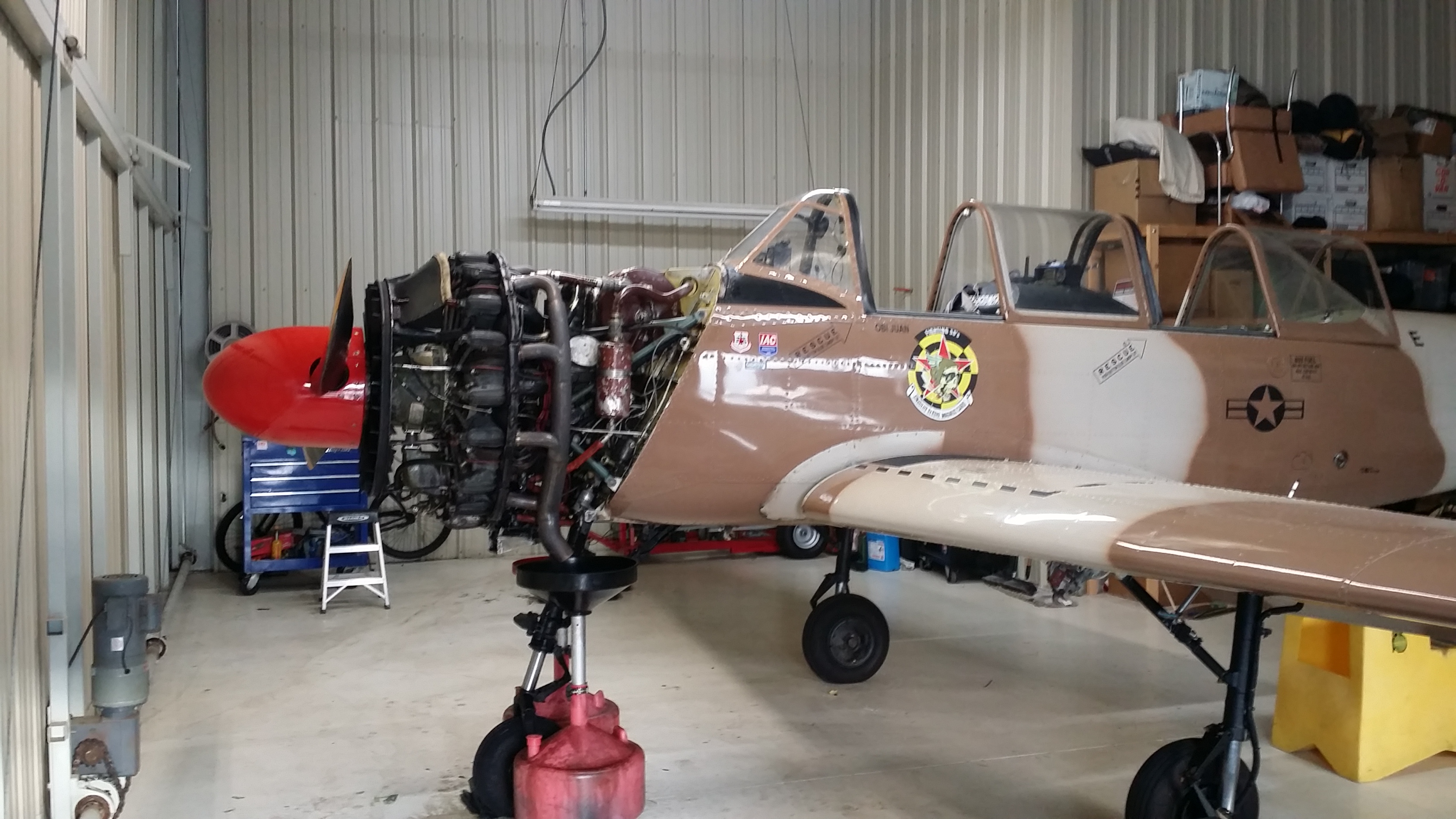

    aerostar6 wrote: > Hey John. > > I have done this process 4 times in the last 6 months when my overhauled engine had to be removed for the second time. > My mechanic came up with a perfect solution. Take a long, stiff strip of metal, around 9" long (an old hacksaw blade is perfect) and weld onto the end a stud made up of a bolt end the same size as the prop stud, with maybe three full threads remaining. > Now spin on your nut and you should have enough room to offer the whole assembly up to the prop stud. Then carefully nudge the nut off your 'tool' and onto the stud. > You will probably fail to engage the thread and drop the nut one time in three, but this method should see success in a much shorter time than any other I have used. > Sorry I don't have a pic, but am not back at the airfield for a few days. > > Hope to see your new spinner on at Gillespie when I am next in town later this month! Brilliant solution Mark, we got it on and it all balanced out to 0.05 IPS, smooth like butter, getting it all put back together with new cockpit, landing/taxi and nav/pos/strobe LED's, should test fly later this week. See in a few weeks. 'Gimp -------- Owner/Pilot N6209F 1987 Yak-52 COMM/ASEL/IFR/HP-Complex/TW Read this topic online here: http://forums.matronics.com/viewtopic.php?p=447694#447694 Attachments: http://forums.matronics.com//files/20151004_173221_zpskyxq2jp1_466.jpg
