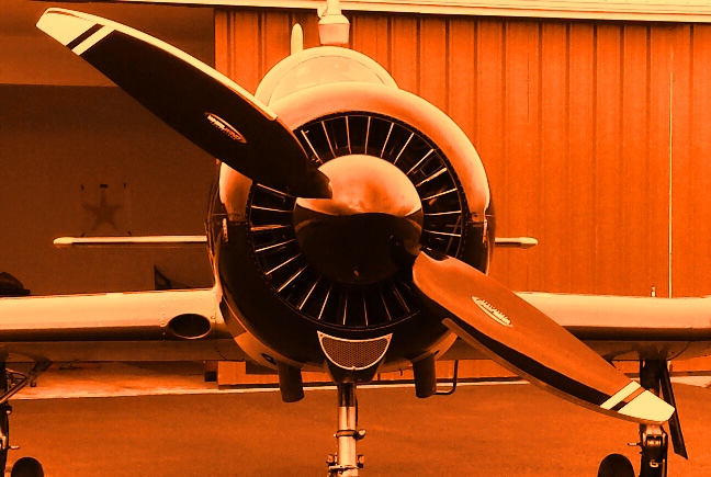

    You can always make one out of metal screen or perforated aluminum. :D Read this topic online here: http://forums.matronics.com/viewtopic.php?p=461989#461989 Attachments: http://forums.matronics.com//files/20151108_13389927_214.jpeg
