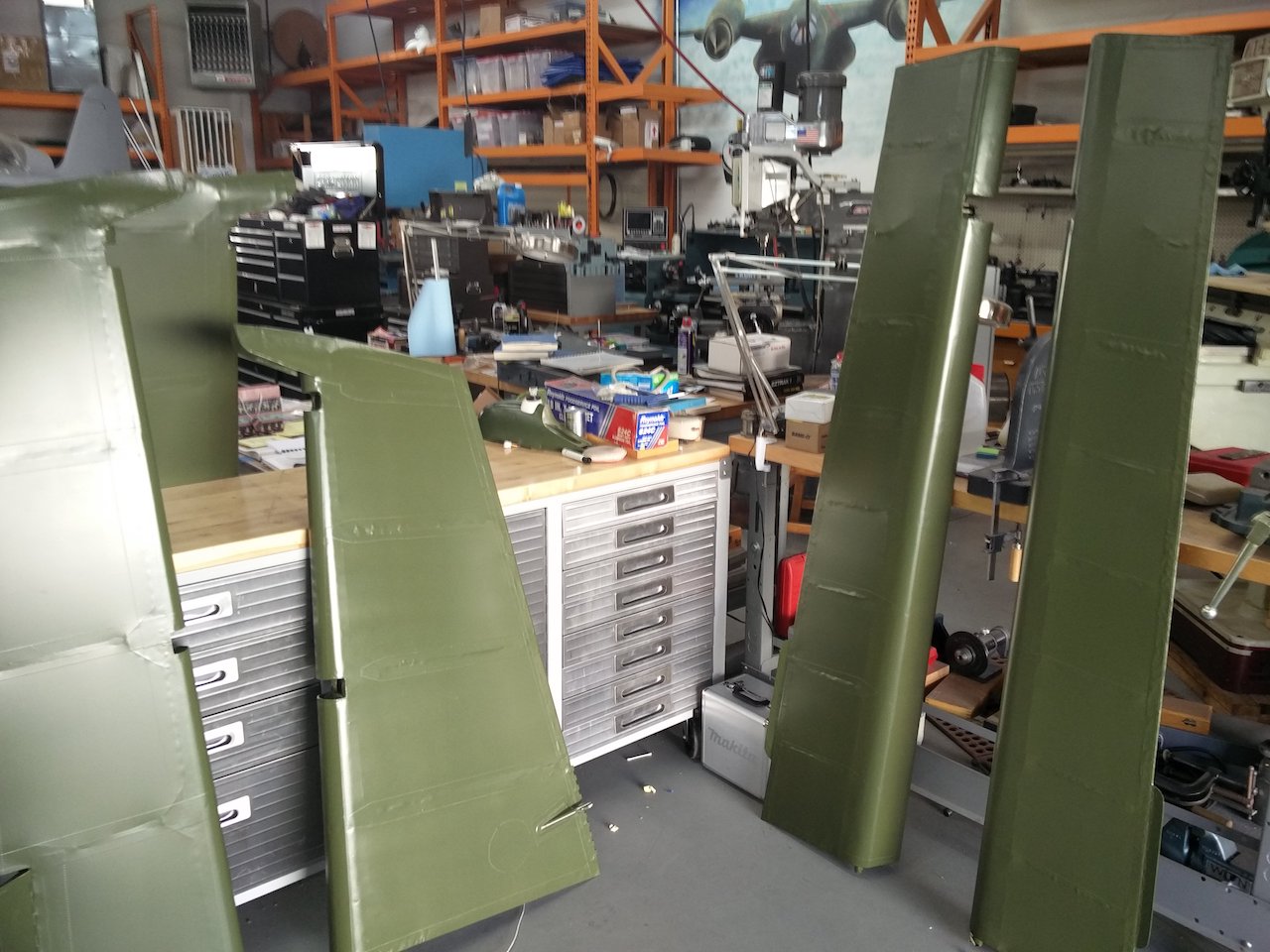

I just finished STITS from Aircraft Spruce, and it cost about $750 including the
PolyTone "paint" (which was almost the most expensive part). Here is what I
initially bought:
Qty Ship B/O Item Unit Price Total Price
2 2 0 09-18400 RIB STITCH NEEDLE 4" STRAIGHT # 504 1.450 2.90
1 1 0 09-02450 STITS PINKED P103 2" TAPE 25YD 23.200 23.20
2 2 0 09-03206 3" CURVED NEEDLE 1.120 2.24
2 2 0 09-03204 2" CURVED NEEDLE 0.950 1.90
2 2 0 09-18300 RIB STITCH NEEDLE 2-1/2" CURVD 1.100 2.20
2 2 0 09-18500 RIB STITCH NEEDLE 10" # 504 3.450 6.90
1 1 0 09-18710 RIB STITCH NEEDLE 6" CURVED 2.650 2.65
1 1 0 09-18705 RIB STITCH NEEDLE 3" CURVED 1.200 1.20
1 1 0 09-02900 POLY-FIBER P-103 3" TAPE 25YD 27.800 27.80
1 1 0 09-03600 STITS REINFORCING TAPE 3/8 56.600 56.60
1 0 1 09-41300-1 CECONITE RIB LACE CORD D693 RD 45.500 0.00
1 1 0 09-00234 POLY-FIBER COLOR CHART # 50 0.000 0.00
5 5 0 09-01600 POLY-FIBER FABRIC MEDIUM 73" 2.97 OZ 11.950 59.575
2 0 2 09-04850 POLY-FIBER REDUCER RR8500 GAL 48.500 0.00
1 1 0 09-04500 POLY-FIBER POLY-SPRAY GALLON 83.600 83.60
1 1 0 09-04100 POLY-BRUSH QT. TINTED 25.750 25.75
1 1 0 09-05000 POLY-FIBER POLY-TAK CEMENT QT 27.500 27.50
I ran out of Poly-Tak and Ply-Spray and had to borrow some from a friend. Didn't
use ANY of the needles except the straight one. Lots of tape, thread and reducer
left.
I then bought a gallon of the Poly-Tone (clear) and had it tinted locally to match
the Chinese Olive Drab - fairly good match. Didn't try to paint the underside
different. Still have 1/2 gallon of the clear Polytone left, as I only mixed
up a couple quarts of color.
I had never done this before, and it took about 3 weeks of afternoons... I'm fairly
satisfied with the job, but I got progressively better. Next time would
be almost professional. I'm pretty sure it is safe. :)
Attached is a pic of them - didn't get the elevators in there very well.
Hope this helps.
Stephen
