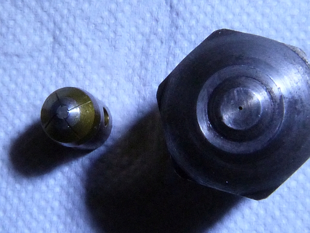

Hi Phil,
I did not like the design of the jet, so was thinking along the lines of jets used
in central heating oil burners. There is a taper top seated inside with very
fine grooves that do not point exactly to the center. That is to produce some
swirl and resulting in a cone of oil spray out of the tiny jet. For primer
application all details can be much more rough than for burner use. You have to
experiment a little with water from your water tap at home to see what it does.
But it is no very big deal to make up a jet for your purpose and maybe use
some part of a burner.
Vic
http://forums.matronics.com/viewtopic.php?p=468797#468797
http://forums.matronics.com//files/p1050236_kkk_104.jpg
http://forums.matronics.com//files/p1050237_kkk_627.jpg
http://forums.matronics.com//files/p1050240_kkk_117.jpg
http://forums.matronics.com//files/p1050241__kkk_196.jpg

> Gentlemen,
> plane currently in for annual. We had the primer line off as it was
> crimped at 90 degrees resulting in restricted flow.
> It's a pretty odd set up for this line. It comes out of the firewall,
> heads 90 degrees left, then doubles back right, and then another 90 degree
> bend into the intake manifold. Any thoughts of running a steel braided line
> right from the firewall straight in?
> The primer "atomizer" is pretty dreadful. We tested it, and really,
> gas just streams out similar to holding your thumb on a water hose. There
> is no atomizing, aerosol-izing, or misting of fuel. Is there an
> after-market part that would do a better job?
> Given the poor atomization, we started wondering if one shouldn't
> prime and 'press start' simultaneously (dragging gas into the cylinders) as
> opposed to priming earlier and having the gas collect at the bottom of the
> intake header. I suspect in the South (hotter) this isn't an issue, but in
> the North, gas doesn't create as much vapour.
> Anyone performed any upgrades to this system?
> Thoughts?
> Phil
> (C-FEPN - Ottawa)

Message 6
| Subject: | Re: [Non-DoD Source] Re: HS6 primer upgrade questions |
Mark,
WE dont have problems starting the M 14 after my mod. It was just an idea for improvements
as I think a better spray shape from the primer jet may be a lot better
for starting than a stream of fuel running down the case inside. That was
told by a few here leading to poor starting. As drilling extremely small holes
in a jet is not exactly easy in stainless so fabricating a jet like in my pictures
may be more practical in case there was a messed up jet.
Just when pressing the air start button we push the primer as well for the final
prime - and while cranking when necessary.
Vic
http://forums.matronics.com/viewtopic.php?p=468817#468817
Message 7
Sorry Vic, I am not aware of your mod, and I did not see your pictures.
My logic is as follows:
1. If your plan is not to prime the engine at all, but instead to start cranking
it, and THEN prime it furiously while you are cranking, then changing the fuel
primer nozzle to better atomize the stream would make a significant improvement,
at least I would think.
2. If your plan is to prime the engine before it is cranking then the question
becomes how long the fuel will stay atomized after it leaves the primer nozzle.
Unlike an oil burner, we are not injecting fuel directly into a burner can
for ignition. Instead it is going into the supercharger cavity where no matter
what, it is going to hit some metal and start running down the sides, unless
the engine has just been run and is hot.
On a typical day the engine should start within the second blade. If it goes longer
than that, it really was not ready to start when you pushed the starter
button, and you are playing a game of catch-up ball, while in the meantime you
are quickly reducing your air bottle pressure.
If the engine is primed and pulled through before hitting the starter button, 2nd
blade starts are the norm and not the exception. On a warm engine start, just
touching the start button results in instantaneous ignition.
I've done it both ways ... prime and then just push the starter button throwing
more prime in, and then cranking and hoping or doing the prime and pull through
method. The former method does work. The latter method works better.
Personally I'll be very interested in hearing how a different primer nozzle works
for you.
Best of luck,
Mark

Message 9
Reading the last postings I feel we do a LOT less priming for starting. Of course
we do three or four shots of primer while turning the prop and do one shot
when pressing the button and maybe two or three when the engine requires. But
then no flying in winter or low temps here in Bavaria, as we dont have to fly
at all in bad weather. So I believe there is something good about a spray of fuel
instead of producing a big puddle of gas low down in the case hoping for enough
mixture for an ignition.
But this is just talking about ideas for improvements about the primer, not
really absolutely necessary. But I do remember that some had troubles at starting
due to f***ed up primer jets.
Vic
http://forums.matronics.com/viewtopic.php?p=468823#468823
