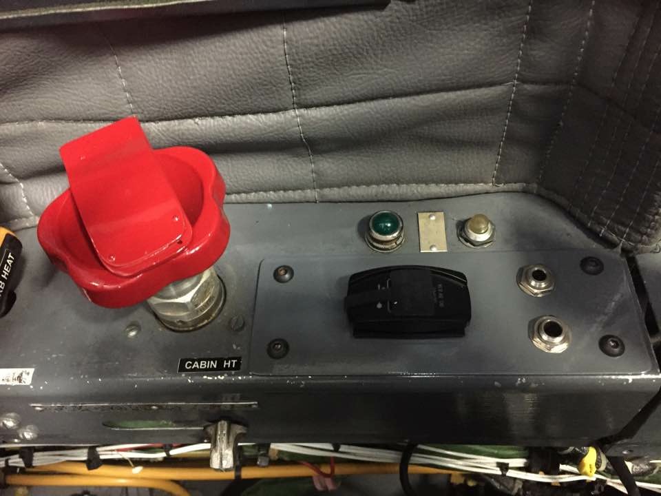

    Anyone looking to install a USB charging port in their YAK/CJ. Here is a very good option. https://www.amazon.com/gp/product/B013W8KPUG/ref=oh_aui_detailpage_o04_s00?ie=UTF8&psc=1 -------- &quot;Battle Yak&quot; Read this topic online here: http://forums.matronics.com/viewtopic.php?p=470892#470892 Attachments: http://forums.matronics.com//files/img_0660_137.jpg
