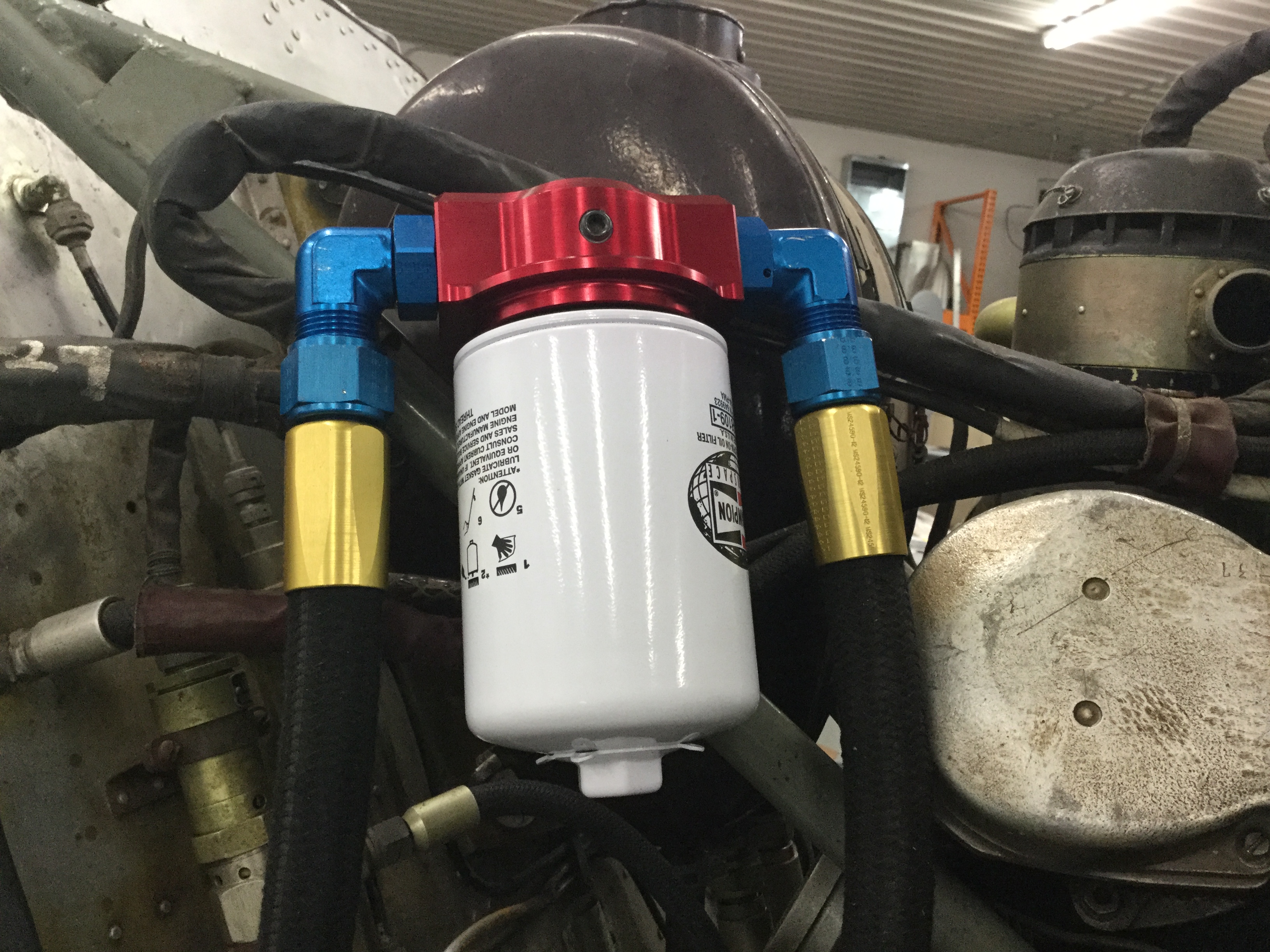

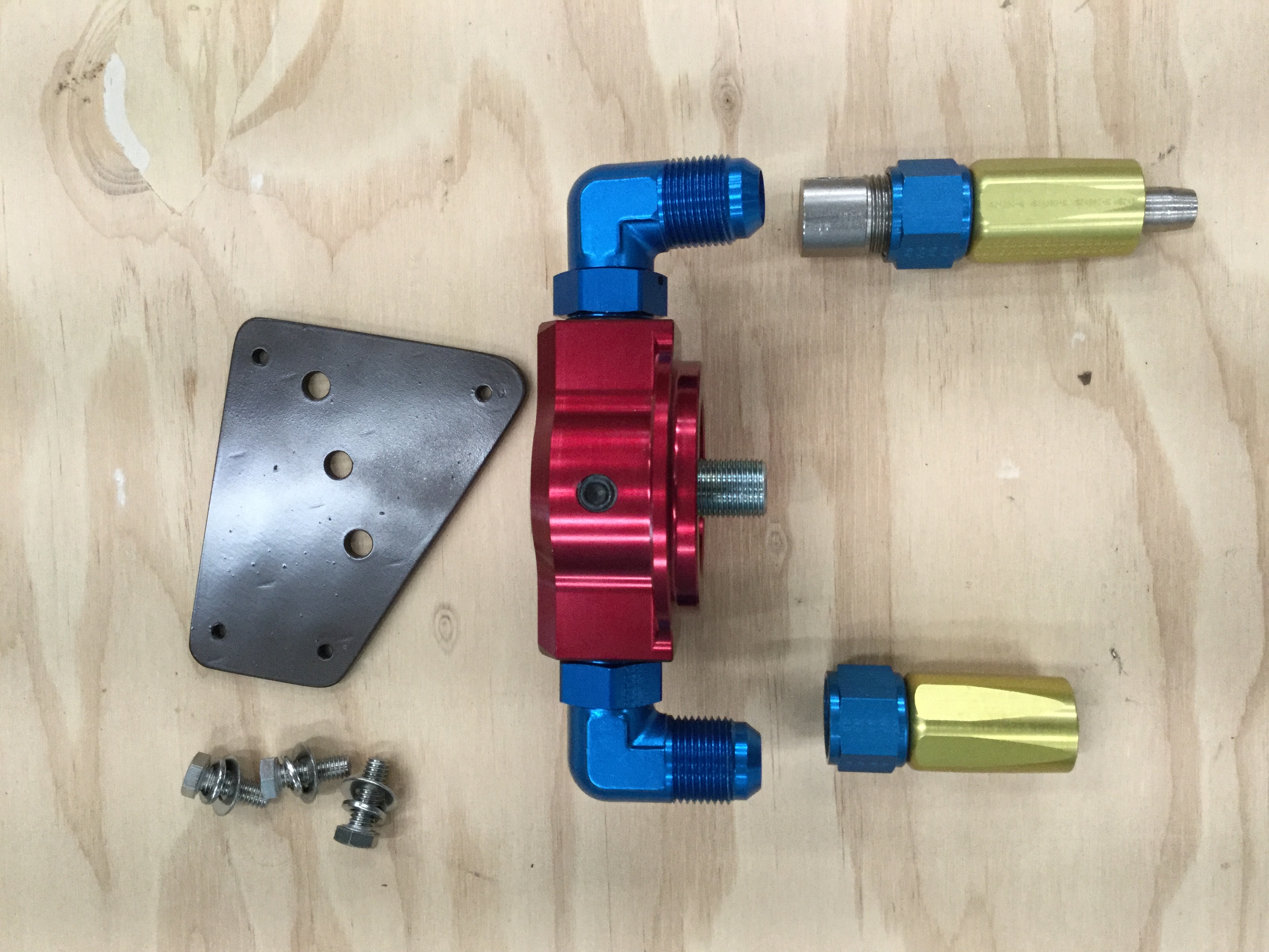

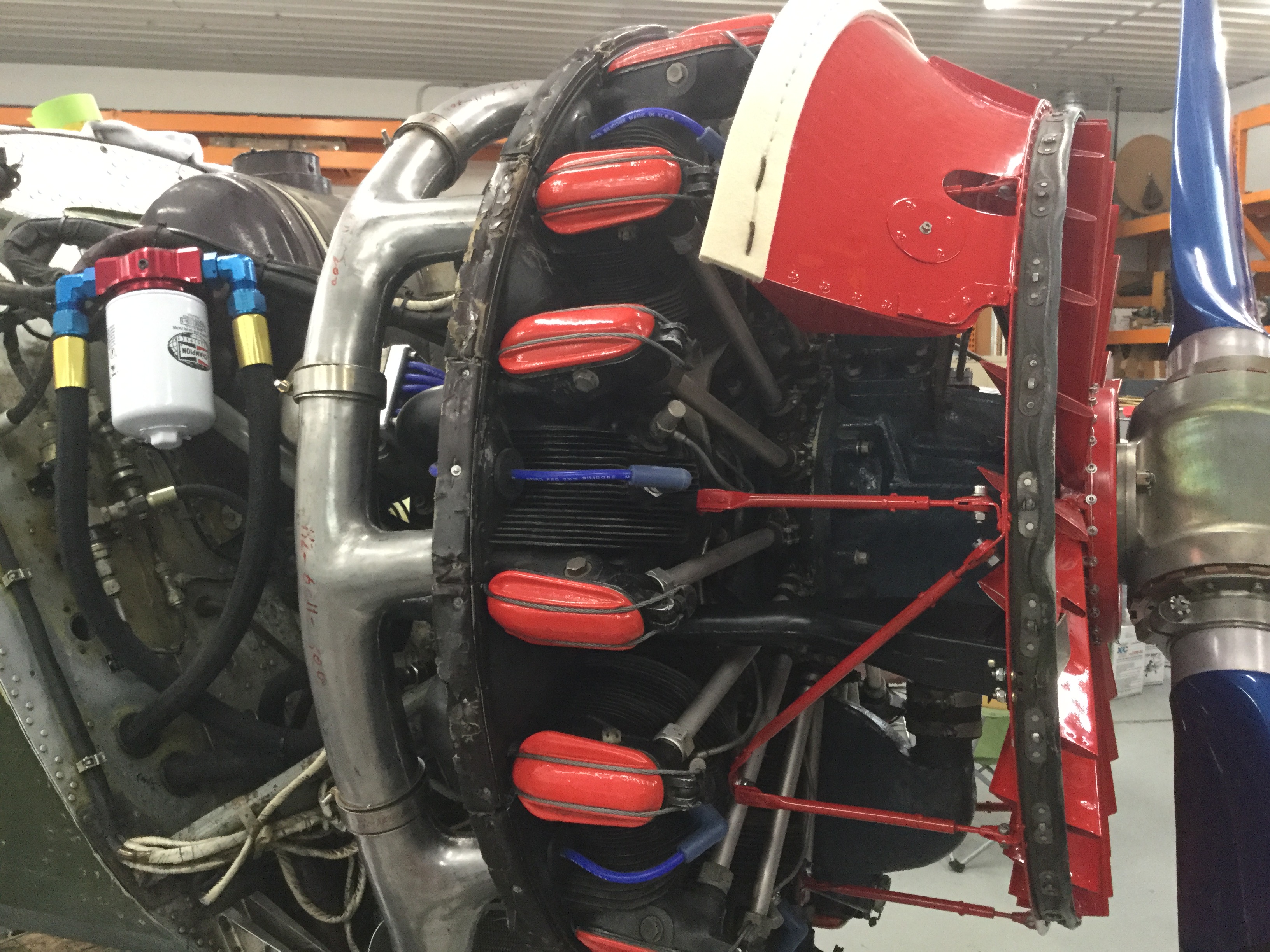

Also, does anyone have a remote filter on their Yak? As an engineer I shiver at
the thought of basically unfiltered oil circulating around my engine. One of
the DC3's I looked after has the Air Wolf kit fitted and boy does it work!
I would get one of them or maybe one of Craig Payne's ones today, but I can't
find a spot suitable to mount it. Again, can someone please post or mail a picture
or two?

Here is the installation of a remote filter on my Nanchang - I'm sorry but I forget
exactly where the main part was sourced, but we fabricated the mounting plate.
Also, sorry the pictures are so big, but too hard to edit smaller!
