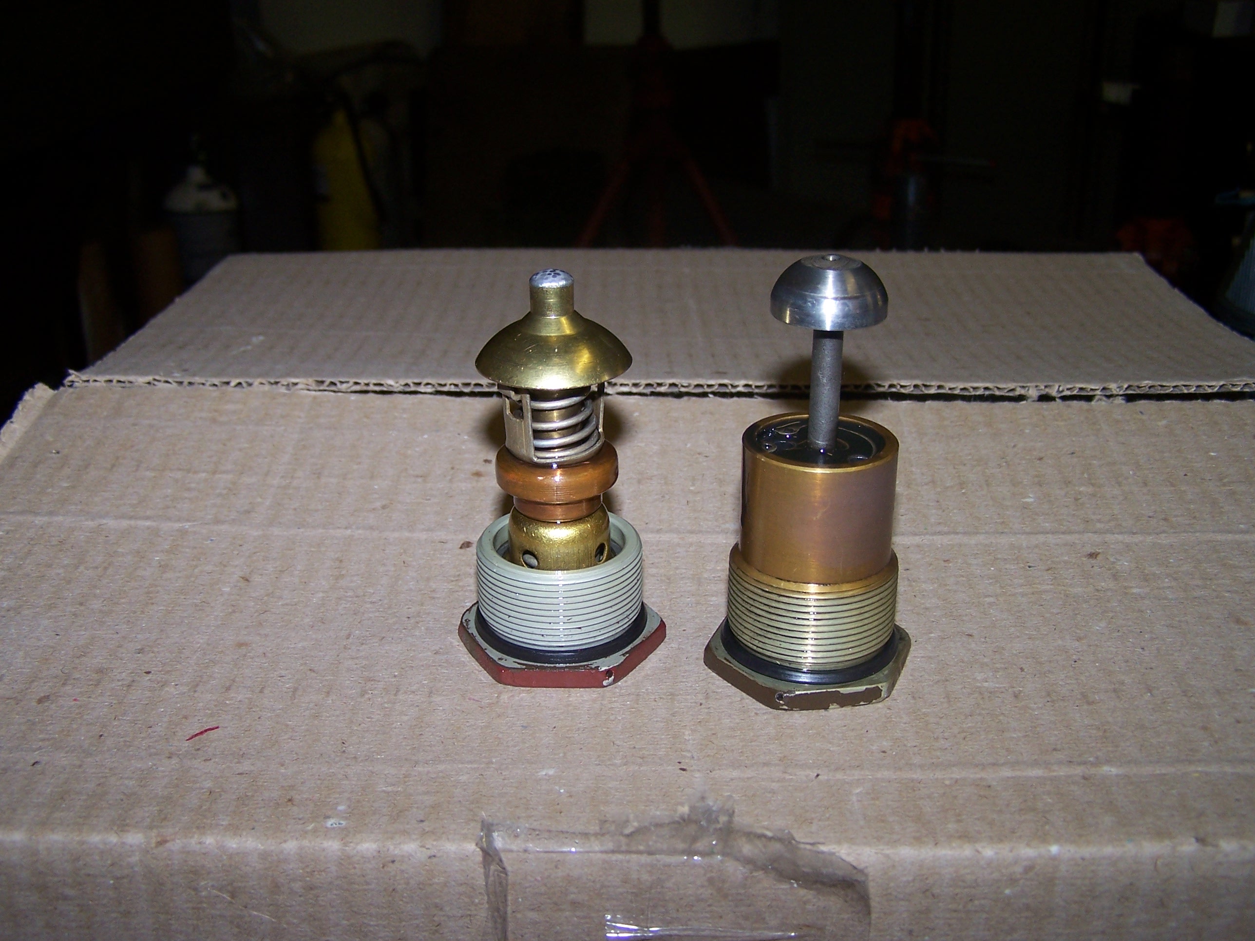

    Hi Andrew, Like Mark I also fitted the original 'thermo(stat)-(safety)valve' back into my -52 in 2010 and it's reduced the engine warm-up time and more importantly got the oil temps into the green to boil off any corrosive moisture (mine's a cool engine in-flight). I've attached an image of the two units with the thermo-valve (left) and pressure valve on the right. Sourced the thermo-valve from a one-off surplus Mi-8 helicopter hydraulic inter-cooler in the UK (sometimes used for competition aircraft oil coolers). Given they made 17,000+ Mi-8s you would hope someone somewhere might have spares, but they seem to be like hen's teeth :-( To follow on from Mark's thoughts ... the very cold weather SOP is to blow ducted hot air into the engine and oil cooler (see other image). However this causes the original fit cooler thermo-valve to open about 7mm max (it's just a simple expanding paraffin wax device with an over-pressure relief spring at the base) allowing oil through the cooler matrix. Trouble is the upstream large oil pipes feeding the cooler are still full of unheated congealed (Russian) oil ... that then gets fed into the cooler matrix on engine start with the potential to rupture it. Now the over-pressure spring in the base is supposed to take care of this and my conjecture is that the limited travel and force required in practice was not always enough to protect the cooler matrix in time. This is from having compared the operation of the thermo-valve versus the (field replacement) pressure relief valve and the latter takes less effort to operate (simply based on pushing down hard on both with my hand). Presumably this is not an issue for Mi-8 helicopter cooler usage as the viscosity of cold hydraulic oil is less than aircraft engine oils. FWIW - I've experienced no issues using the thermo-valve on my -52 over the last 7 years using western oils, albeit in less extreme temperatures (UK is relatively mild). YMMV. Brgds, Rob R Read this topic online here: http://forums.matronics.com/viewtopic.php?p=477466#477466 Attachments: http://forums.matronics.com//files/yak_pre_heat_471.jpg http://forums.matronics.com//files/thermostat_safety_valve_163.jpg

    Hi Mark, Wow. Thanks for the pictures and the additional detail on the thermovalve. I'm still working on finding one. Our typical Northern California temps aren't that extreme, but agree that the thermovalve is a more ideal solution. Very helpful to see the difference between the PRV and the thermovalve. I'll keep looking. Andrew -------- Andrew Patton Yak-50 San Francisco, CA Read this topic online here: http://forums.matronics.com/viewtopic.php?p=477474#477474

    Hi Mark - just a shot - do you have a part number for this valve? Many thanks Andrew -------- Andrew Patton Yak-50 San Francisco, CA Read this topic online here: http://forums.matronics.com/viewtopic.php?p=477475#477475

    No, I do not. Sorry. Mark ________________________________ From: owner-yak-list-server@matronics.com [owner-yak-list-server@matronics.com] on behalf of apatton2 [apatton@alumni.princeton.edu] Sent: Saturday, January 20, 2018 12:33 PM Subject: [Non-DoD Source] Yak-List: Re: Super-cool oil temp Hi Mark - just a shot - do you have a part number for this valve? Many thanks Andrew -------- Andrew Patton Yak-50 San Francisco, CA Read this topic online here: http://forums.matronics.com/viewtopic.php?p=477475#477475
