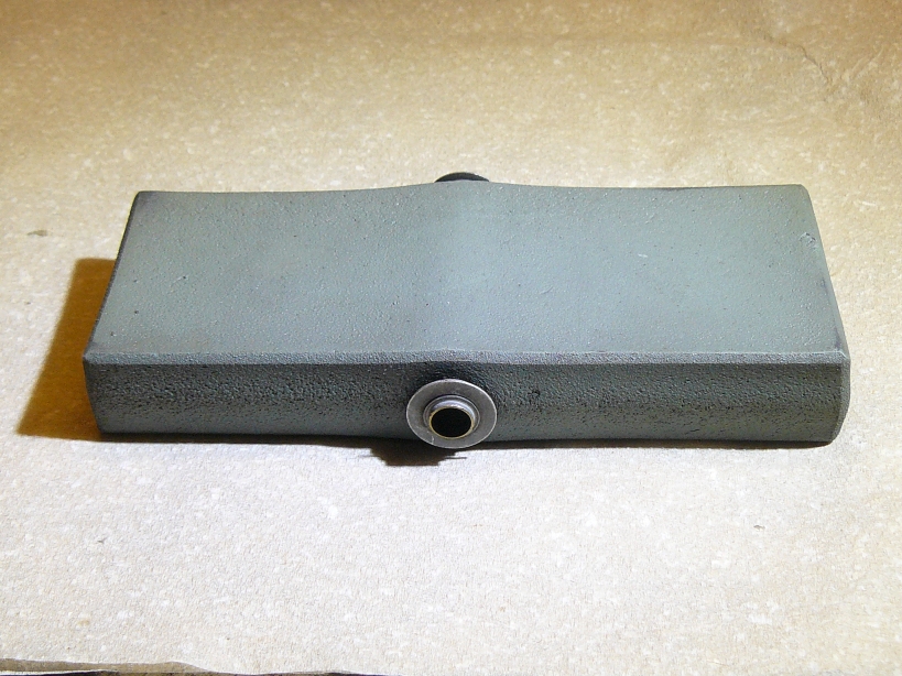

That is a typical defect after all these years. The fuel obviously dilutes any
additive in the plastic floats so they shrink and no longer float. I copied a
few sets in stainless but am not very keen to do some more, too much hassle and
I have other projects to keep me entertained. At least some pics:
Vic

These are 18 T floats. Chinese aircraft are extremely rare in Europe.
Vic
