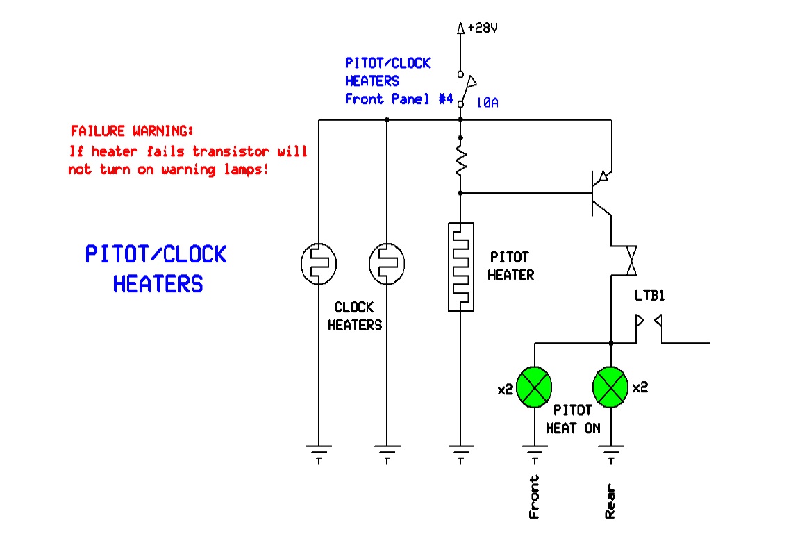

FYI - be aware that the pitot heater has a simple transistor circuit that only
drives the green 'on' lamps (see attached diagram) when the heater is consuming
power i.e. it monitors that the heater is actually working, not just being
supplied with a voltage.
So if the heater, resistor or associated wiring goes open circuit, or the transistor
fails, the lamps will not light ... that could lead you to consider that
the 10A breaker has died.
The resistor (T4) & transistor (T5) can be found in the relay box on bulkhead 6
(at the back of rear instrument panel) if you want to check out the circuit.
Hope this helps with your fault finding.
Rob R

Once again you taught me something I did not know!
Mark

Thanks Rob!
I join Mark in his opinion. Not the first time that you presented superb diagrams!
Jan
