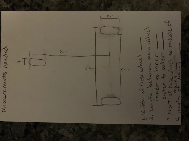

    I was hoping someone either had these measurements or could possibly take these measurements for me. I am waiting on my plane to be ferried into my airport and then the plan is to trailer it to an off airport location for paint and mods. I have received excellent information on how to do the trailer but before I commit to welding everything up I would like to confirm some good measurement numbers. I am also including a picture (sorry, computer rotated it) of what I measurements I need but here we go: 1. Width of nose wheel_______ 2. Length between main wheel INNER to INNER_______ 3. Length between main wheel OUTER to OUTER_______ 4. Front of Nosewheel to middle of main gear_______ 5. Length or diameter of Main Wheels_______ I know this is a pain in the neck but I have looked everywhere for this. I purchased the plane and the trailer and now I am down to fabricating the trailer mod so I can get started on the actual project. Feel free to shoot me a PM. Thanks, SAM Read this topic online here: http://forums.matronics.com/viewtopic.php?p=484636#484636 Attachments: http://forums.matronics.com//files/nanchang_measurements_123.jpg
