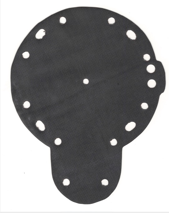

I know from personal experience the diaphragms are NOT interchangeable.

> Can anyone tell me 100% that they are interchangeable?
> Need to order sets for up to 4 HS6As all well past 6 years of operation
> Also, my CJ6 parts catalogue just has blank pages where the carburettor is meant
to be! PLAAF secrets or .pdf problem?

Here is a picture of a carb membrane for an M14P from a Yak52. Installed it last
week.
