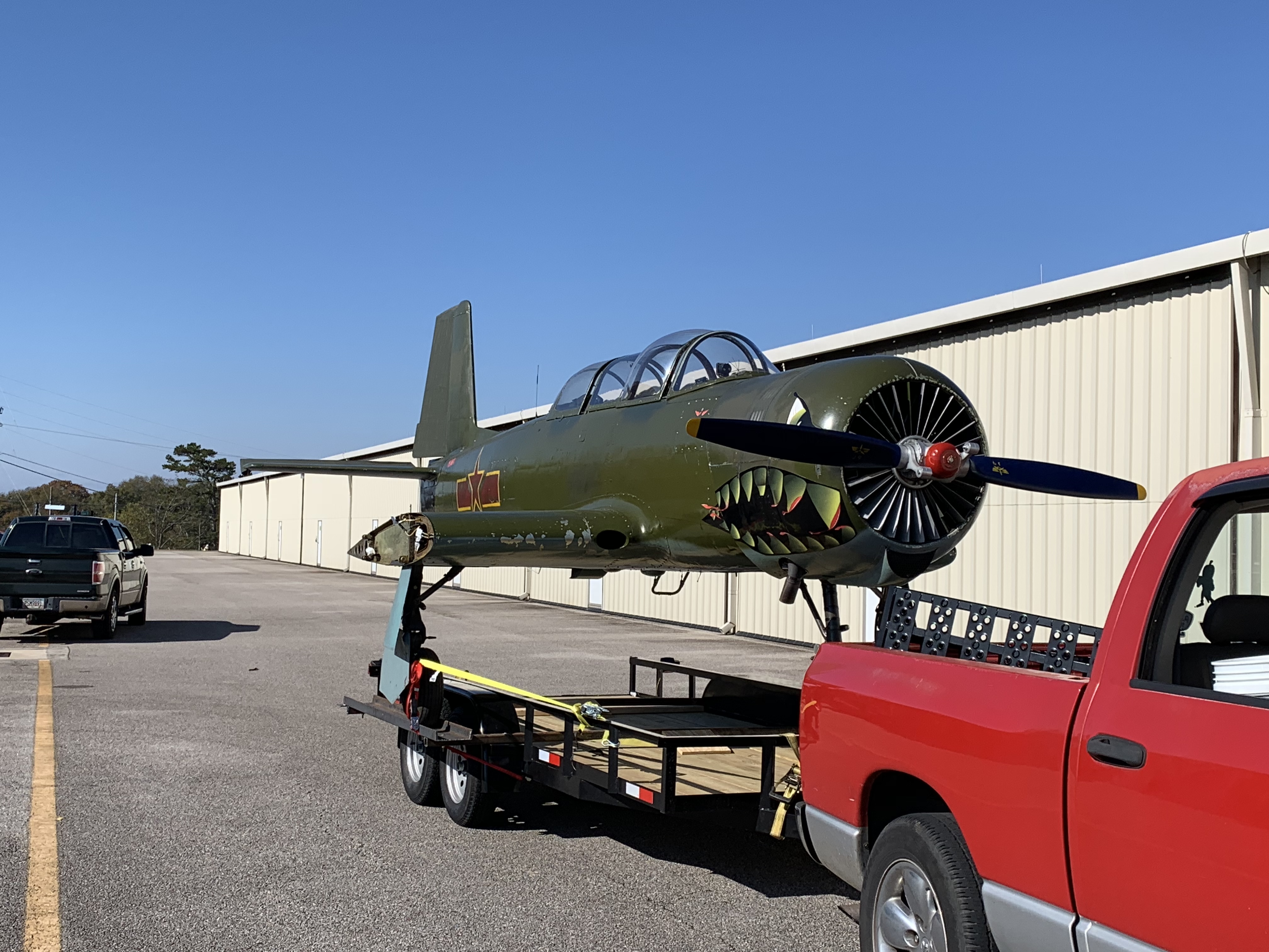

    I just wanted to say thanks to everybody that sent me a message and helped me out. You gave some great ideas. I ended up using a 16 foot trailer with 8 inch wide C-channel side ramps. The square tubing that ran across the ramp were a quarter inch thick. The setup works fantastic. SAM Read this topic online here: http://forums.matronics.com/viewtopic.php?p=485498#485498 Attachments: http://forums.matronics.com//files/6f7cc430_d7c2_4791_af98_a7eae669a5e2_173.jpeg
