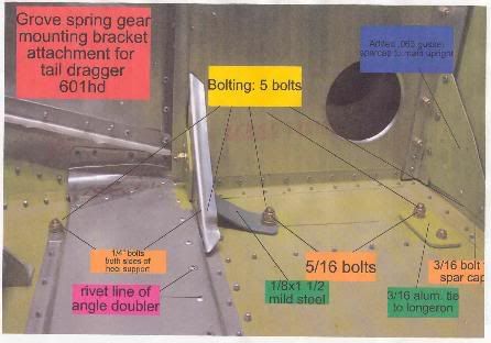

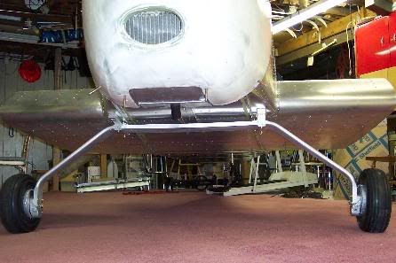

    --> Zenith-List message posted by: David Barth <davids601xl@yahoo.com> I received this but believe it was intended for the entire list. David Aaron <agustafson@chartermi.net> wrote: From: "Aaron" Subject: 601 gear conversion 601 HD/HDS builders I am one of those that has put spring gear on my 601 HD tail dragger. Maybe the only one on a TD(as of 3 OCT 04) http://img.photobucket.com/albums/v220/AGCB2/Landgear.jpg I did not get (didn't ask) approval from Chris Heinz, so I don't want to cause any trouble, however I am willing to provide the info that I have and how I did it on my plane. I am very satisfied with how it turned out on my plane. Since more & more folks are asking for this info, I have put together a list of pics & a general description to be accessed by anyone who asks. I don't know the weight difference but the Grove gear is 4.5" wide 2024 treated to T6 compared to the, I think, 8" wide 6061 XL plans gear. And one other thing you probably can't do is gun drill the brake lines. There were a few changes that I made as I built the center section and lower fuselage that I would still suggest. Simple ones just to support the gear mount brackets. Since mine was the first standard Grove installation, they did not have the patterns. I simply talked to Robbie Grove and from his information it was a easy task to fabricate brackets from 1 1/2 x 1" 6061 which I obtained from OnlineMetals.com. http://www.onlinemetals.com/how.cfm http://img.photobucket.com/albums/v220/AGCB2/eGearmntinstd.jpg The brackets are actually mounted outboard of the lower longerons and the right parallel w/ the left (the longerons are closer together in front than back) http://img.photobucket.com/albums/v220/AGCB2/emountbrktjpg.jpg The main mods I made were to strengthen the heel support as this is where the forward load is and all of the braking forces. I sized it up one thickness and added a doubler angle to the read channel angle. I also increased the size of the gusset to the vertical member and changed it from an angle to a channel. The rear load is easily carried by the spar. http://img.photobucket.com/albums/v220/AGCB2/2bolting.jpg Again, I say that I am completely satisfied w/ my gear installation and would be happy to talk to anyone thinking about or planning a Grove gear installation. 2 OCT 4 Aaron David Barth 601 XL Plansbuilder 15% done? Working on Wings www.ch601.org --------------------------------- vote.yahoo.com - Register online to vote today!

    --> Zenith-List message posted by: David Barth <davids601xl@yahoo.com> Hi Gary For a start I would suggest you contact Aaron at agustafson@chartermi.net and then maybe get more contact info from him. When you have better contact info than I do - and that shouldn't be long - please send it to me and I will put it on the ch601.org website.. David "Gary A. Boothe" <gboothe@calply.com> wrote: --> Zenith-List message posted by: "Gary A. Boothe" Hi David, Thanks for the quick response. I saw that websight link but couldn't figure out who to contact about progress, testing to date, etc. Zenith has told me that spring gear is not an option for the HDS, and if that's what I want I need to consider changing to the XL. I am encouraged by the images on your sight. Please tell me how to get more info as I would like to continue with the HDS. Gary Boothe WW Corvair Power - 601 ----- Original Message ----- From: "David Barth" Subject: Re: Zenith-List: Spring Gear for 601HDS David Barth 601 XL Plansbuilder 15% done? Working on Wings www.ch601.org ---------------------------------
