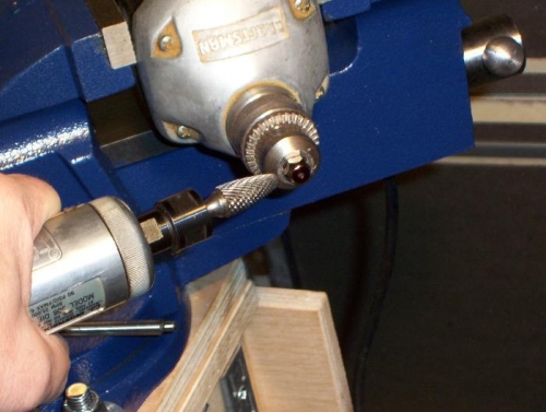

I don't know that I got it exactly right, but close enough for me. I have
ground four of them for different rivet pullers. I just heated up the nose piece
to a cherry red and let it cool. Then it can be ground with any number of
tools. I have used a Dremel with both round cutting heads and round grinding
heads. I think the metal ones give a smoother result.

For a short article on the easy way to form puller heads using Dremel
tool, go to the archives for a short article I offered. It is message
#11121 or use the search word: "gottem" and it is the only message that
will come up.

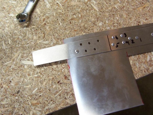

To modify the noses pieces:
3/8 Drill motor, Bench Vice, Die Grinder, Acorn shaped carbide bit.
Make sure you have centered the nose piece in the chuck by spining it. Put some
color on the nose piece before begining the grinding. It lets you see better
where the tool bit touches.
Start the drill motor and lock it on, start the die grinder and touch off in the
center. Use a light touch and stop to see if it is really centered. If OK continue
to shape untill it is about right, then test it. Once the tests prove
good, use sandpaper and red scotchbrite to polish out the tool marks.
It really is easy and if you go to deep just grind it flat and start over. Using
the carbide burr no heat is required.

I had a ZAC supplied hand rivet puller with
ground tips that did not fit my pneumatic gun. It
took me about 10 minutes per tip to grind my own,
using the procedure I have described a couple of times
in the archives. Rivets pulled by my tips are
indistinguishable from the ZAC tip.
Sending them to ZAC works, but if you want to
save $25 or need them a little quicker, do it
yourself. It is a piece of cake...

I've found if you go too deep you can fix it by taking a little bit
off the flat part of the nose piece with a normal file. You can
test the result by setting a rivet and cutting across it to see if
the internal layer is flat to the surface of the piece being riveted.
