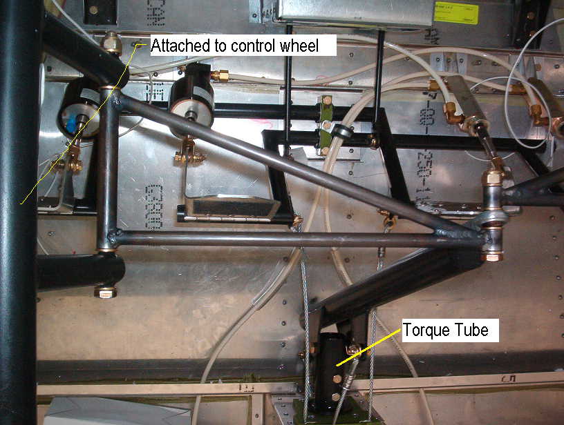

Hello,
I built and fly a CH640. I will try and post a picture later, but will try to explain
if I can. Starting from the ailerons. Cables from the aileron bell cranks
attach to a torque tube which runs forward through the spar. Attached to the
forward portion of the torque tube is a vertical tube. Think of it as a single
control stick that runs up behind the panel. The photo is looking down on the
controls behind the panel and forward is the top of the picture. It is really
simple and works well. There is probably a bit more resistance than a system
using a chain mechanism.
