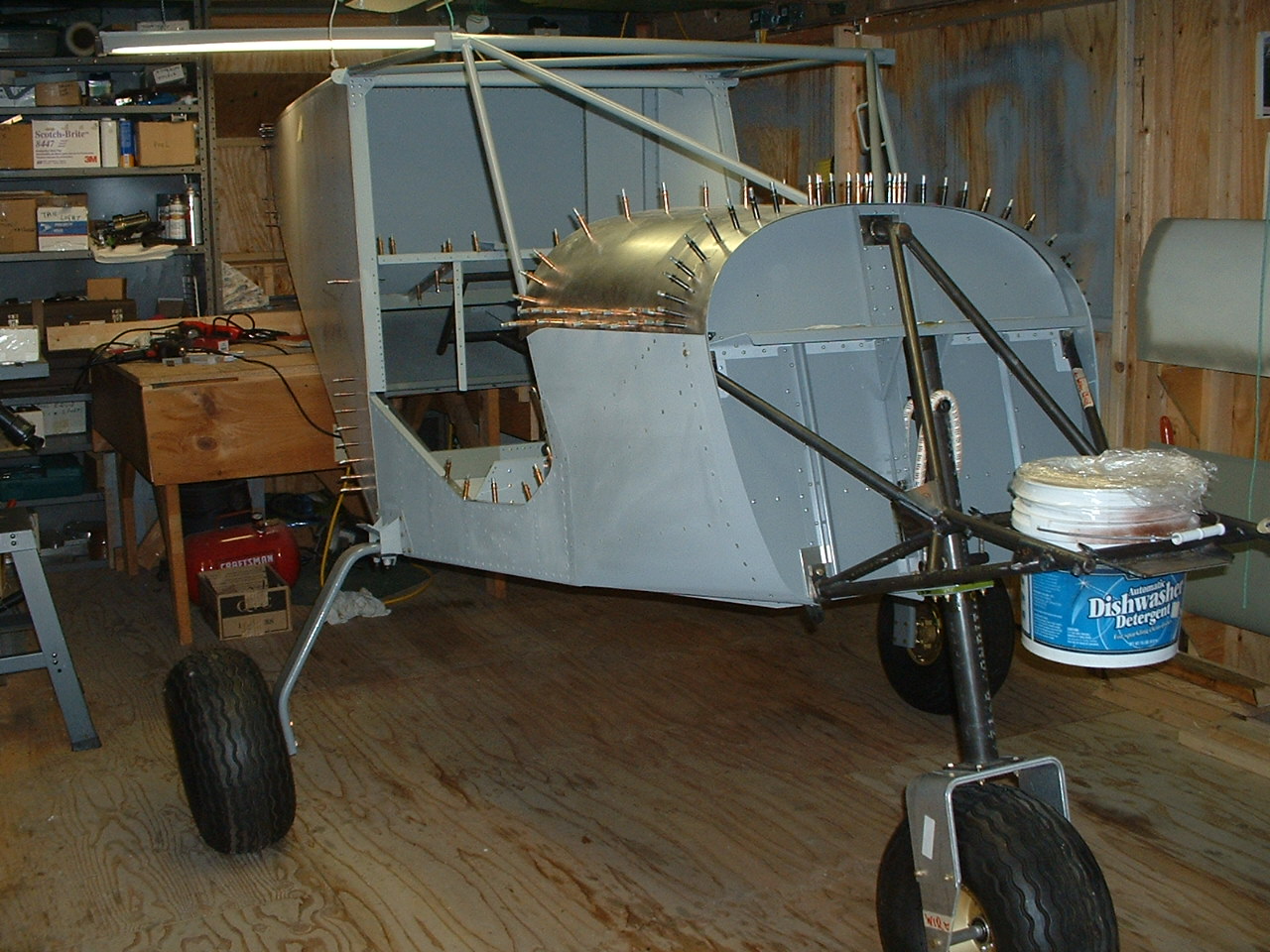

      --> Zenith-List message posted by: "Geoff Heap" <stol10@comcast.net>
      test do not archive
      http://forums.matronics.com/viewtopic.php?p=62141#62141
      http://forums.matronics.com//files/on_wheels_2_480.jpg

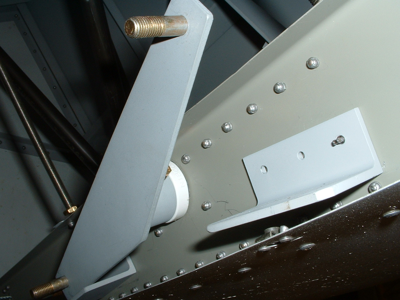

| Subject:  | 701 Aileron rod horn interference |
      I bought the control kit from ZAC. After assembly I see that without the elevator
      wires hooked up, the torque tube is able to slide forward until the boltheads
      going through the aileron rod horn 7C2-3 (and rod ends) interfere with the
      top flange of the BOTTOM CHANNEL 7F6-1. In this position the ailerons cannot work.
      The only scenario I can see where this can be disastrous is if the elevator
      wires go slack in flight (for any reason you care to think of) In this situation
      hopefully the wires just go a little slack ( I'm not even talking about
      complete failure such as a broken wire). OK, but now there is no tension from
      said wire to hold the torque tube in the aftmost position. If the torque tube
      now slides forward about 5/16" I've lost aileron control. There is an in flight
      fix for this which is not acceptable to me. Simply push the torque tube back
      with my right hand and aileron control is back.
      Variation in assy from one 701 to another does not alter this condition that I
      can see. On page 7C2 two dimension changes for the rod horn would solve this.
      Dims 25 mm and 8 mm should both be increased by 9mm to 34 and 17.
      I solved this to my satisfaction with a piece of pvc tube from home depot cost
      about 0.50c. OD is 1.25. I had to open up the ID to 1.135 then cut it off and
      belt sand it to .30 long. It weighs nothing and hopefully will sit there for years
      doing nothing as it doesn't touch anything. But one day..............it might
      have a job to do. see attached
      http://forums.matronics.com/viewtopic.php?p=62144#62144
      http://forums.matronics.com//files/dscf0025_185.jpg
