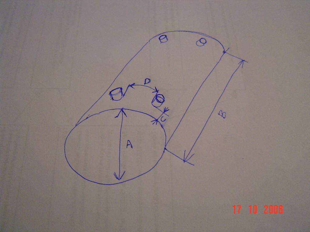

| Subject: | Muffler dimensions |
--> Zenith-List message posted by: "Jari Kaija" <jari.kaija@pp.inet.fi>
Good morning to everyone!
CH701, 912A and self made exhaust system:
I need dimensions for muffler. It's diameter and length.
Also I like to get EDGE distance measured from muffler
edge to pipe edge for those 4 exhaust pipes coming from
engine to the muffler can.
I have only one opportunity (a way too much job at work)
in this week to visit our local metal suplier. I have already
all other parts in my hands except sheets to make muffler can.
http://forums.matronics.com/viewtopic.php?p=68402#68402
http://forums.matronics.com//files/muffler_can_681.jpg
