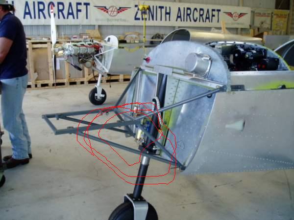

      Forward of the fire wall. I've attached a photo from flycorvair.com of the location.
      amyvega2005(at)earthlink. wrote:
      > whre are you placing the Gascolator?
      > Juan
      W.R. "Gig" Giacona
      601XL Under Construction
      http://forums.matronics.com/viewtopic.php?p=81275#81275
      http://forums.matronics.com//files/firewall_photo_176.jpg

      Me too, just like that, not sticking out below.
