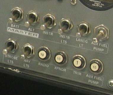

Message 2
| Subject: | Re: Labels and More |
Tommy
I made a drawing of the labels we required in turbo cad &
printed them out on A4 gloss photo paper to the size required.
Most were printed back with white letters to avoid
reflections in canopy.
Ray took the photos to a local vinyl sign maker who scanned
them & printed them out with a sticky backing, we cut them out removed
back & stuck them on the panel have been on 6 months so far ok.
Clive (Ray Lasniers 601 HD G CBDG 56 Hrs)

Message 3
Have you tried the clear laser printer labels? I did up my whole
panel with those and people always ask me what I did them with.
The only thing better in my opinion would be a silk screen job (which
anyone can do at home with a little time and inexpensive paints and
tools)
Trev Page

Message 8
These were made with a ~$120 P-Touch labeller, and the included software on a PC,
which was connected to the P-Touch.
Bill Mileski
http://forums.matronics.com/viewtopic.php?p=82867#82867
http://forums.matronics.com//files/panel_section_198.jpg
