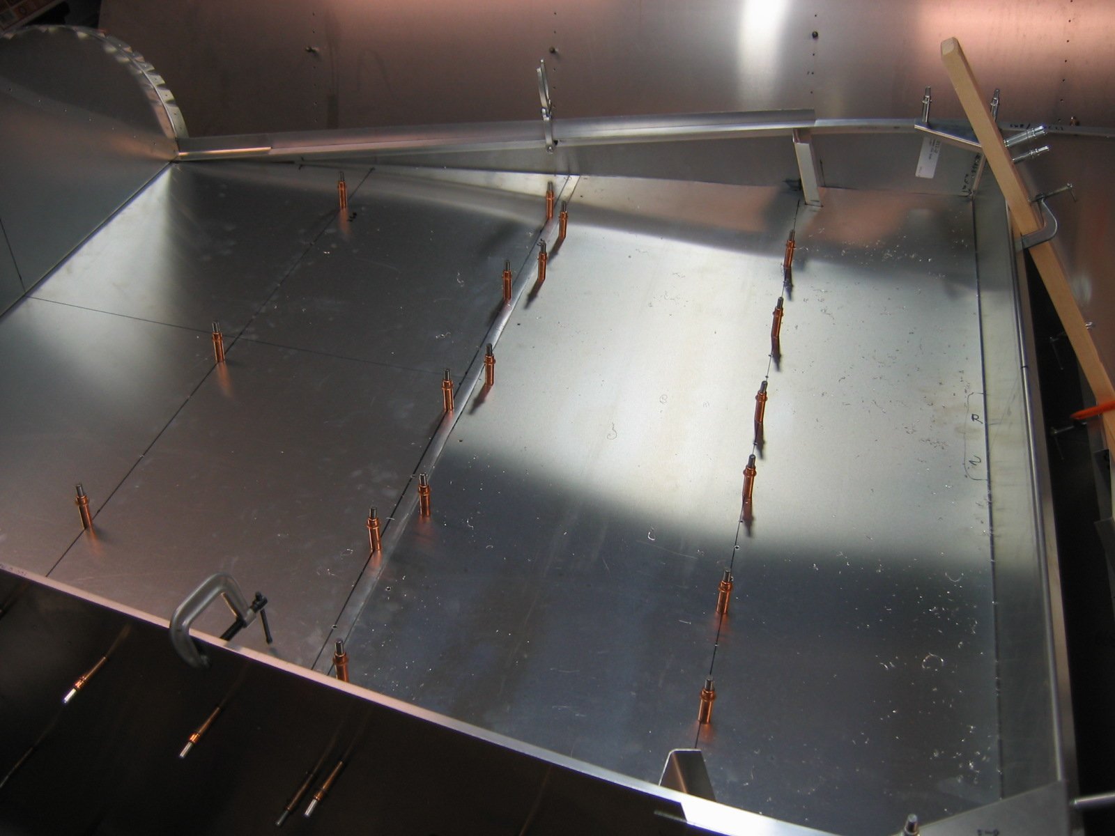

Message 7
| Subject: | Re: Baggage floor |
I did what Jay did and split the floor down the middle. If my attached picture
worked, you can see the double row of cleco's where I substituted a u-channel
for the L-angle. The aft floor will have the side L-angles riveted to it before
placing the floor in the fuselage due to the longeron proximity. The forward
baggage floor will be left un-riveted until close to the end.
Good luck,
David Gallagher
601 XL, tail and wings completed,
working on fueslage.
