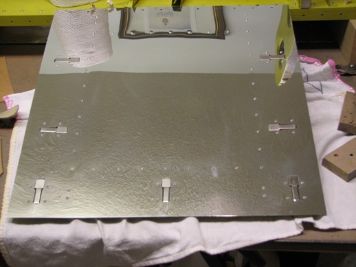

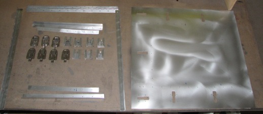

Message 21
| Subject: | VP (Visual Progress) report |
Hello, all
After a long while, I managed to pop a few rivets this evening.
Results are attached: one wing locker door, with Hartwell latches.
Carlos
CH601-HD, plans
CH601-HD, plans
Montreal, Canada
http://forums.matronics.com/viewtopic.php?p=123712#123712
http://forums.matronics.com//files/locker_cover_parts_151.jpg
http://forums.matronics.com//files/locker_cover_125.jpg
