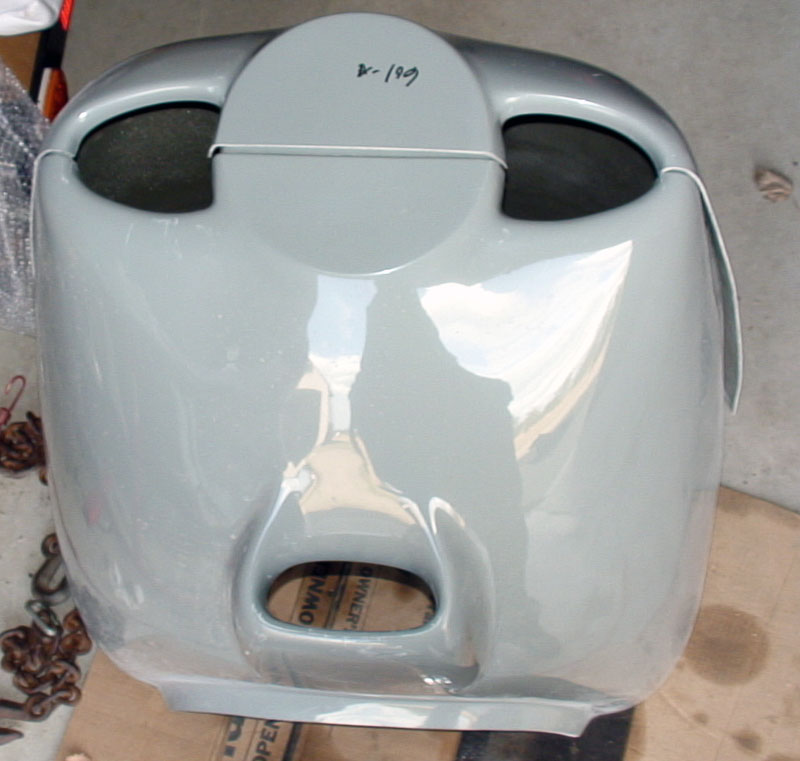

Are you sure you weren't looking at the carb air scoop? If they have the new Jab
cowling then the big scoop under the prop (where the carb air intake is on
most planes) is for the oil cooler.
If it is for cooling, then please post a picture if you have one.
Tim

Message 6
| Subject: | Re: 601XL Jab3300 cooling |
I see what you mean...... seems like there are some serious design issues with
that cowling. The pix of the latest from JabiruUSA is attached. I hope it
works a little better.
Tim
______________
CFII
Champ L16A flying
Zodiac XL - Jabiru 3300A
Working on wings
http://forums.matronics.com/viewtopic.php?p=140431#140431
http://forums.matronics.com//files/601_cowling_514.jpg
Message 7
| Subject: | 601XL Jab3300 cooling |
Craig and fellow dudes,
The eyebrow you see on those planes is typ;ically for only the break in period.
The Tennessee Cowling which i have seen installed on one 601 has its own set
of issues. the key is push as much air through the top of the cylinder cooling
fins. the # 5 cylindar of the Jab 3300 has cooling issues on either one, the
key is to tackle the cooling issues"within reason" what I mean is that so long
as my CHT on the rear heads don't go above 345 and egt over 1340 at cruise
, i can live with it. the key is to get over 70 hourds then reassess. One thing
I did see is the tennesee fitting on the Kit was a little better however
you have to do a lot more glassing work, and the air ducts are a work in proces.
Juan

| Subject: | Re: Jab dual throttle |
Matt,
There has been a recent modification (hopefully an improvement) to the Jabiru USA
supplied cowl for the CH601XL. They have made room to accomodate a change in
the ram air cooling ducts, which in turn were changed to accomodate the new
style heads with more and larger cooling fins.
Another thing I was told is that the previous cheek scoops which fed the ram air
ducts were not optimally lined up with the airflow from the prop. The new cowl
has scoops better aligned and shaped to get more airflow into the cooling ducts.
Also the chin scoop to the oil cooler has been redone to provide better airflow
to the oil cooler for more effective oil temp control.
All these changes became available early this year.
Dred
