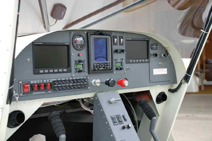

So close to being done I can almost taste it.
Dan Stanton
95% done paint to go
801, IO360
http://forums.matronics.com/viewtopic.php?p=142367#142367
