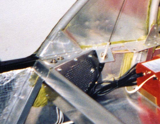

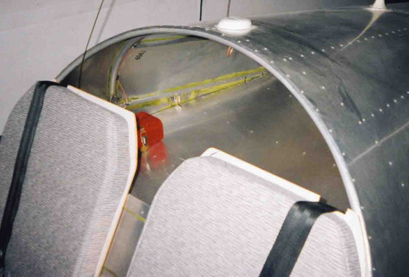

    Time: 03:03:26 PM PST US
    From: Jaybannist@cs.com
    Subject: Locations for headset jacks?
    Andy, I installed my phone jacks where shown on the attached photo. I have not flown with this setup as yet, so I can't comment on "how it worked out." i have caught some flack from some who think that elbows will damage the plugs when they are in place. If that actually happens, I guess I will install some sort of guard around them. Jay in Dallas 601XL N2630N "Dr. Andrew Elliott" <a.s.elliott@cox.net> wrote: >I am getting to the point of wiring, and was interested in hearing if anyone has tried any "unconventional" locations for the headset jacks. > >I would call anywhere in the panel, or directly under it, conventional locations. Unconventional ideas might be behind the seats, more or less under or above the shoulder harness locations, or perhaps in the aft inclined part of the center console, or ?? > >So, who's tried what? And how has it worked out? > >Thanks, >Andy Elliott, Mesa, AZ >N601GE (reserved) >601XL/TD/QB, Corvair, building... >

    Time: 04:17:32 PM PST US
    From: "Craig Payne" <craig@craigandjean.com>
    Jay, your canopy is very clean! ;-) -- Craig do not archive

    Time: 05:28:25 PM PST US
    Pshaw, twern't nuthin' to it! Want me to do yours like that? Jay in Dallas "Craig Payne" <craig@craigandjean.com> wrote: > >Jay, your canopy is very clean! ;-) > >-- Craig > >do not archive > >

    Time: 05:35:09 PM PST US
    > Pshaw, twern't nuthin' to it! Want me to do yours like that? Naw, I'm going to do mine with a wood rasp. I figure what I can't see can't hurt me. -- Craig do not archive
