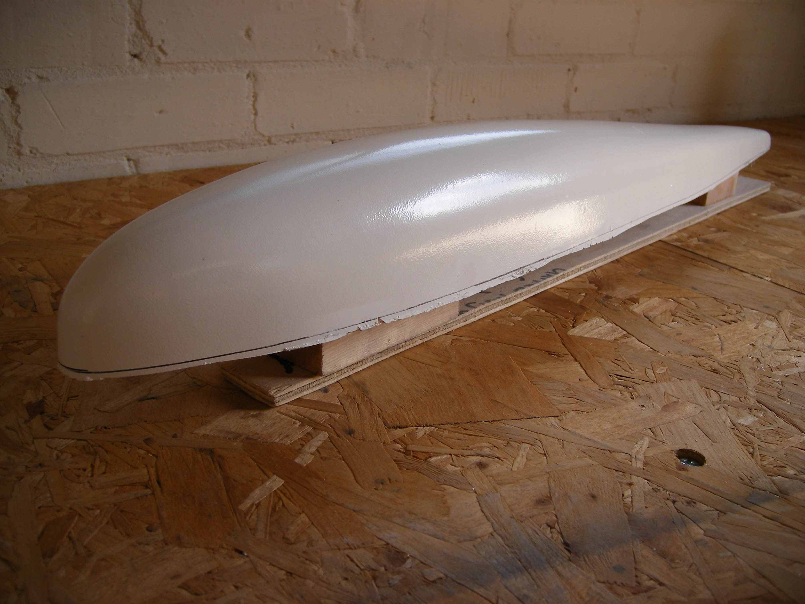

Hi,
I'm trimming the edges of the FTTs and I'm not sure how much I can take off. Drawing
6-X-1 shows the tip to tip width of the tail is 2.3m and the tail skeleton
is 2.205m wide without the tips.
I only need to trim 5mm off each FFT to tidy the edges up but the tail measures
2.345m wide with the tips in place as it is. The tail would then be 2.335m wide,
too wide.
To get the 2.3m width I would need to remove 22.5mm off each tip, that will not
work. Any suggestions?
Many thanks
Rob
http://forums.matronics.com/viewtopic.php?p=176424#176424

Go ahead and trim them for a good fit and don't worry if it's a
little bit wider than the plans show, it won't hurt anything. The
extra width will just give you slightly more pitch stability. The
early 601HD's didn't have the fiberglas tips, they were added to
improve pitch stability.
