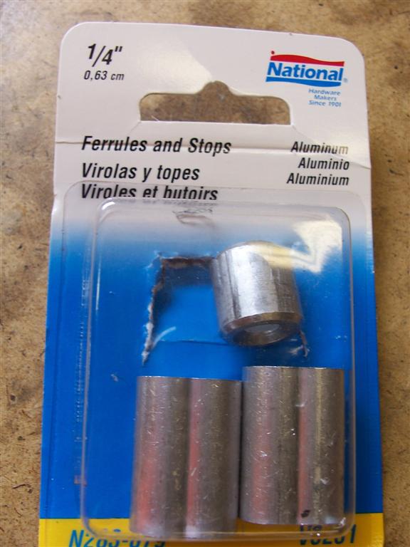

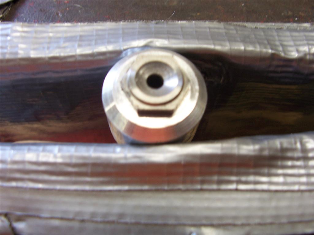

Recently I posted an e-mail passing along a technique from EAA Hints For Homebuilders
for pull riveting in tight places, but the technique would not work for
pulling the domed-head rivets on Zenith products unless the proper dome-shape
is somehow ground or machined into the adapter.

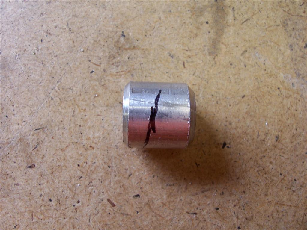

I came up with a cheap and easy way to create an adapter without the need to grind
or machine a custom head.

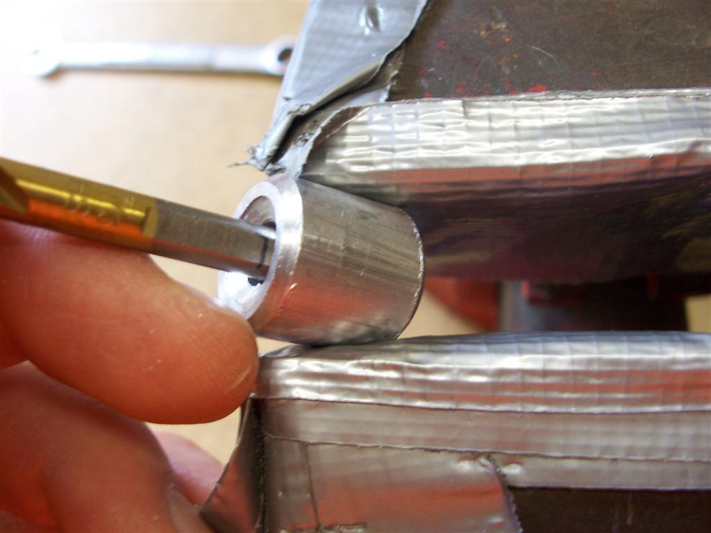

I started by determining the diameter and thread pitch of the riveter head in my
hand riveter. I then determined the drill size needed to tap a hole of the
same diameter and thread pitch. In my case, my Craftsman hand riveter had an
8mm head with 1.25mm thread pitch, requiring a 17/64" starting hole (essentially

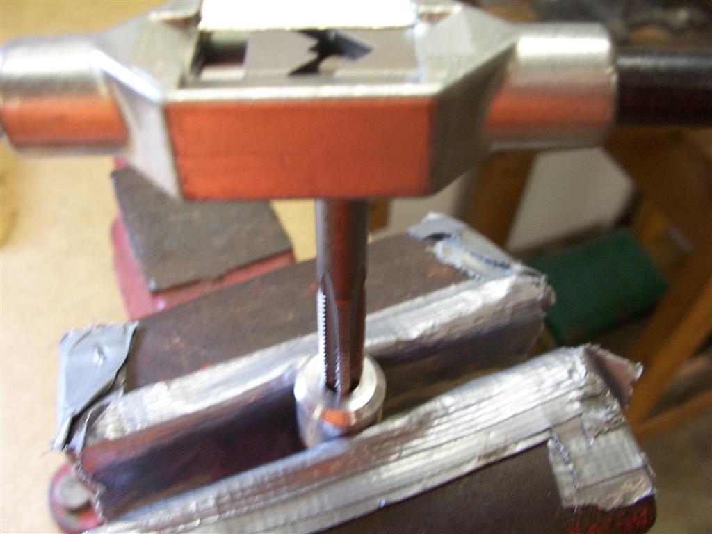

1/4"). I then went to the hardware store and purchased an aluminum ferrule

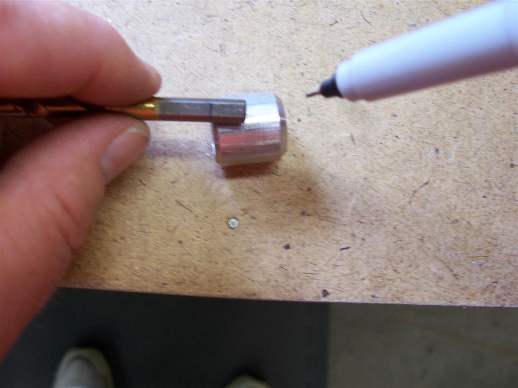

and stop kit with a 1/4" hole (about $2). I took one of the ferrules and threaded
the hole using an 8mm x 1.25mm tap. Next I threaded the riveter head into
the ferrule, measured the remaining height of the ferrule above the top of
the riveter head, and marked that distance down from the top of the ferrule as

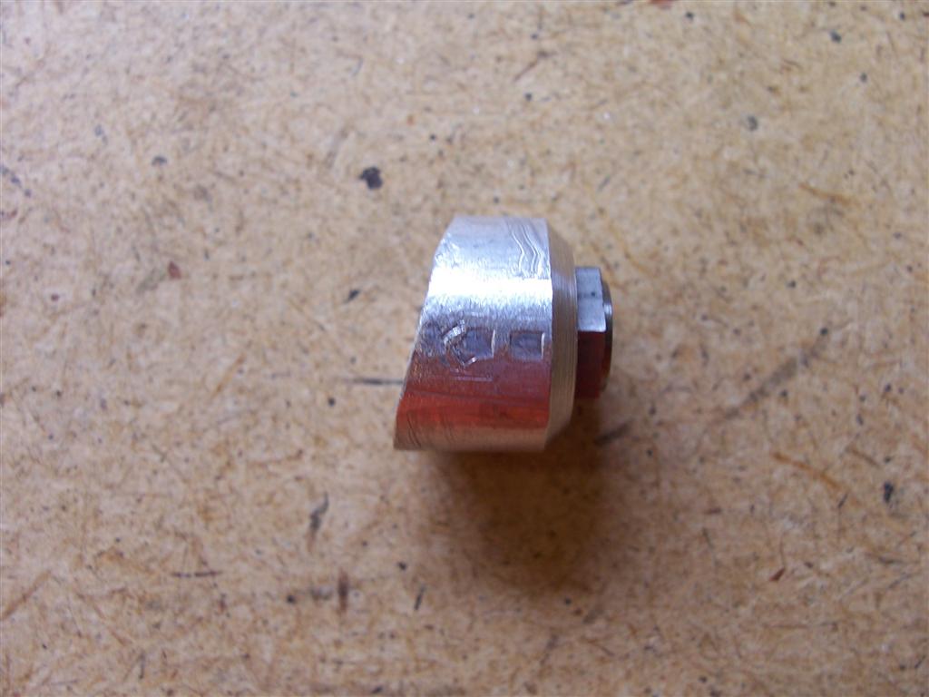

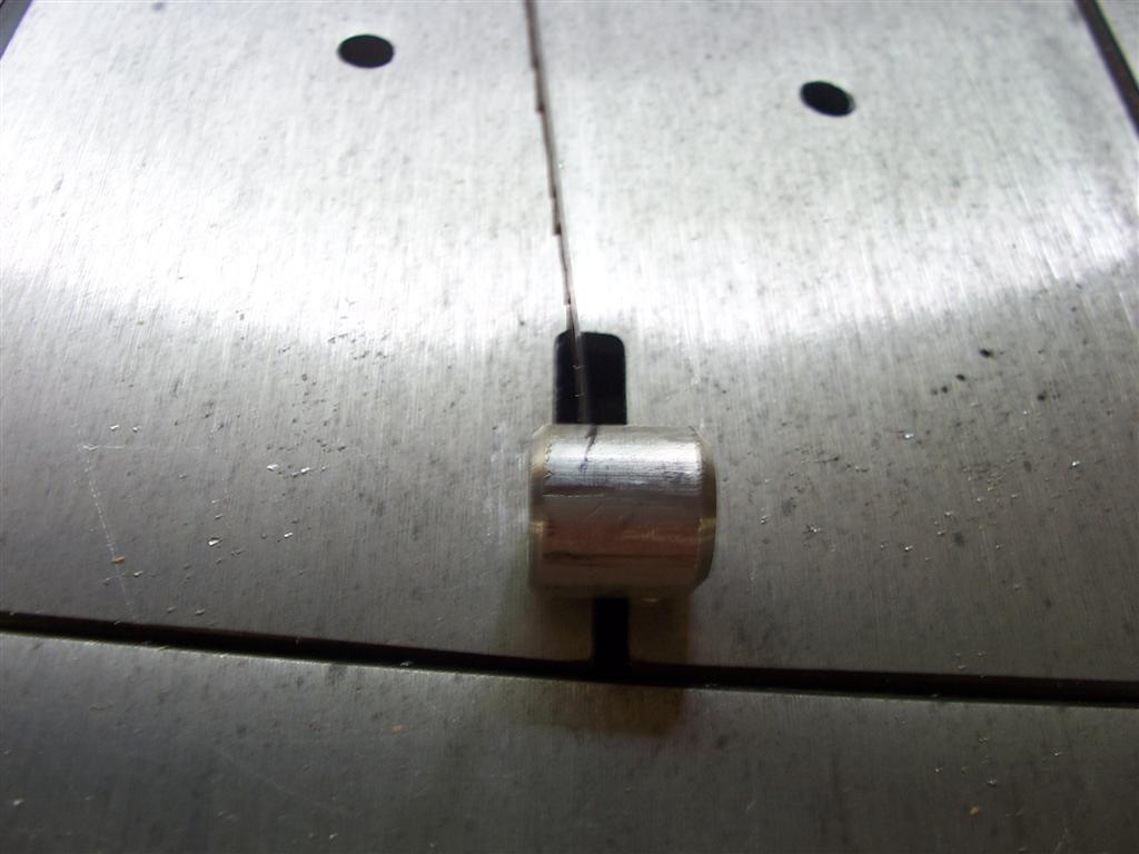

the lowest point for cutting off the top. Next I determined the angle I needed
to pitch the riveter away from the interfering parts (about 10 to 12 degrees),
set my band saw to this angle and cut the top off of the ferrule.

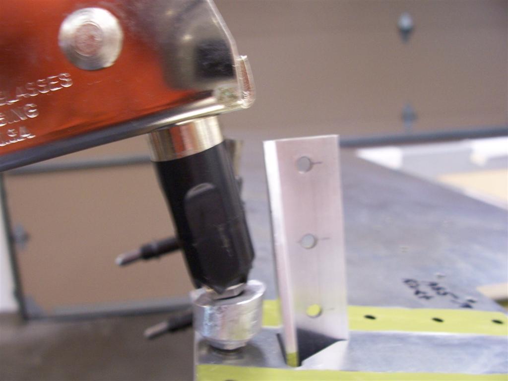

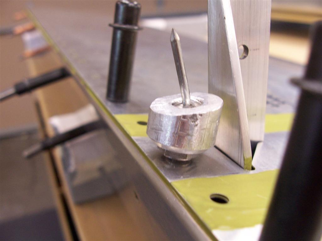

I can use this tool in the same way as the "wedge" adapter in the EAA film, inserting
a rivet and bending the mandrel to be perpendicular to the upper angled
surface of the adapter, and then pulling it with a riveter.
You may have a problem with grip length depending on the profile of your hand riveter
head. I have a low profile head, so the riveter is still able to grab
the remaining mandrel that protrudes from the top of the adapter.
I've included pictures with explanations in case anyone is interested.
