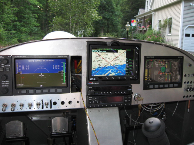

Dan,
The next gen dynon units are most impressive. I stop by the dynon booth here at
OSH daily to gawk at them. Of course, you guys suck because I have already
purchased my dynon gear already!! In comparison to the next gen stuff my panel
all of a sudden looks archaic. I've included a picture below. It looks like
a major avionics upgrade is in my plane's future and its not even finished yet!!

Bout the nicest panel I have seen so far!
