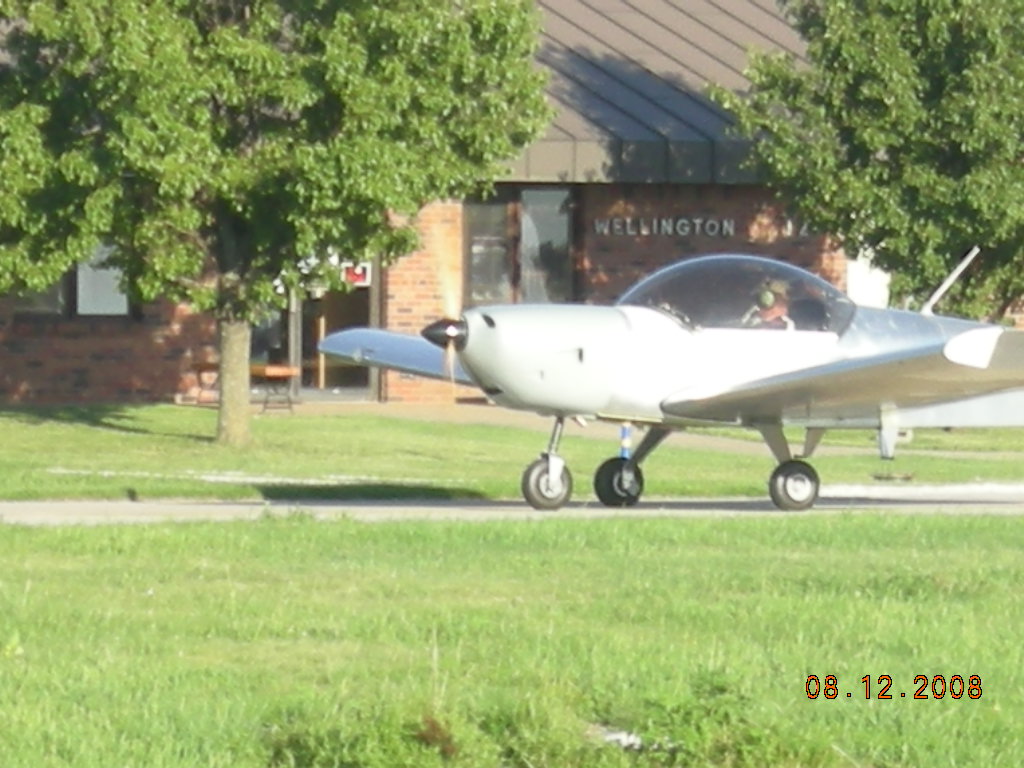

Had a great first flight. Trimmed out very nicely. All temps and instrument readings
stayed in limits. Boy that Jabiru is really nice. Hard to get the grin off
my face. The 3.5 years just flew by. Can't wait to fly her again.

Congratulations Matt! Your hard work was worth it. Your Web site was one of the
first I looked at when I began to think about building my own airplane. You've
been a real inspiration.
Yeah, that Jab is a smooth running machine.
Best wishes for many happy flights in 609MJ.
