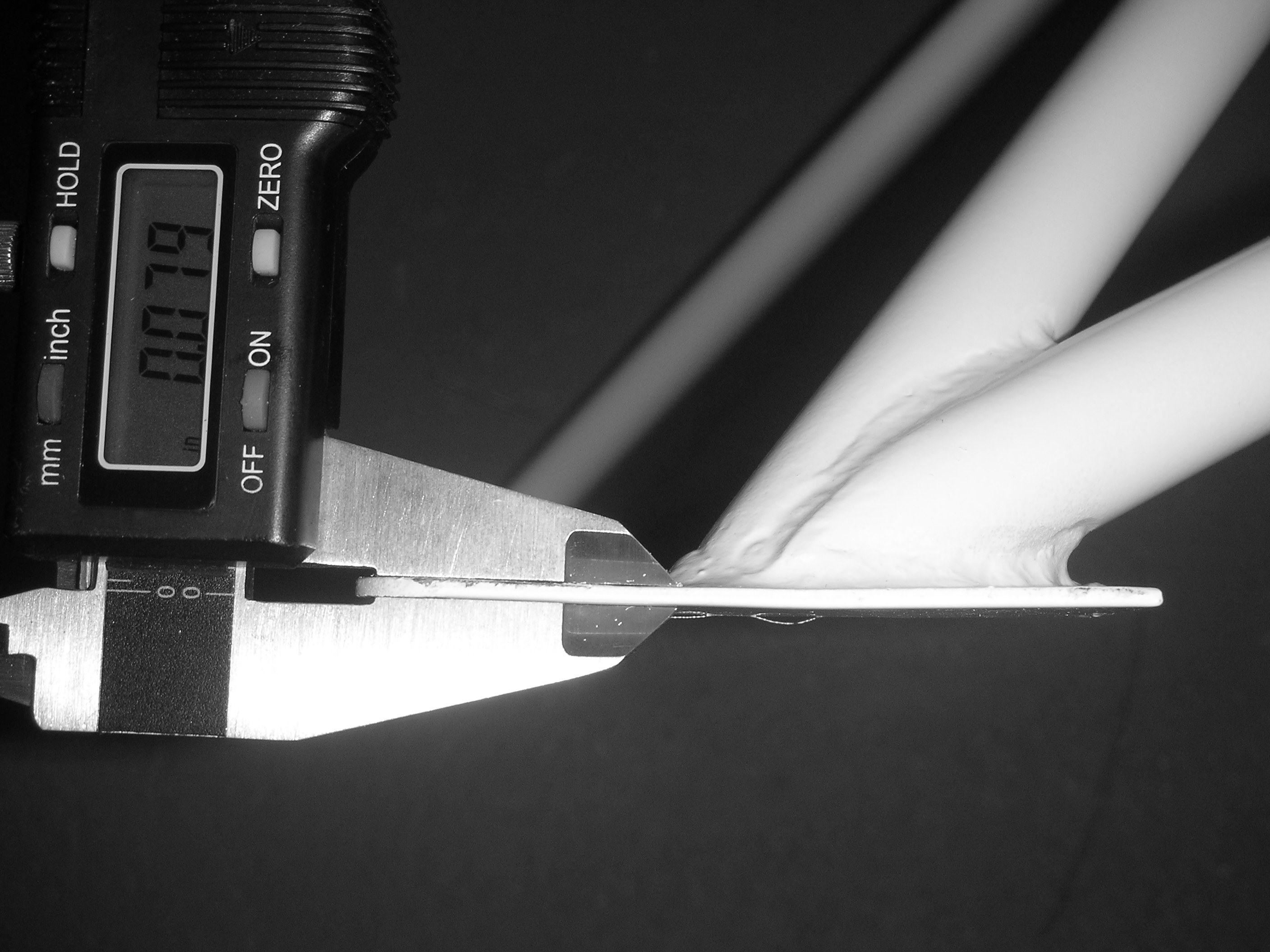

Here is a pic of the suspect Jabiru 3300 Engine mount attach plate
http://forums.matronics.com/viewtopic.php?p 2267#202267
http://forums.matronics.com//files/dscn2572_190.jpg
