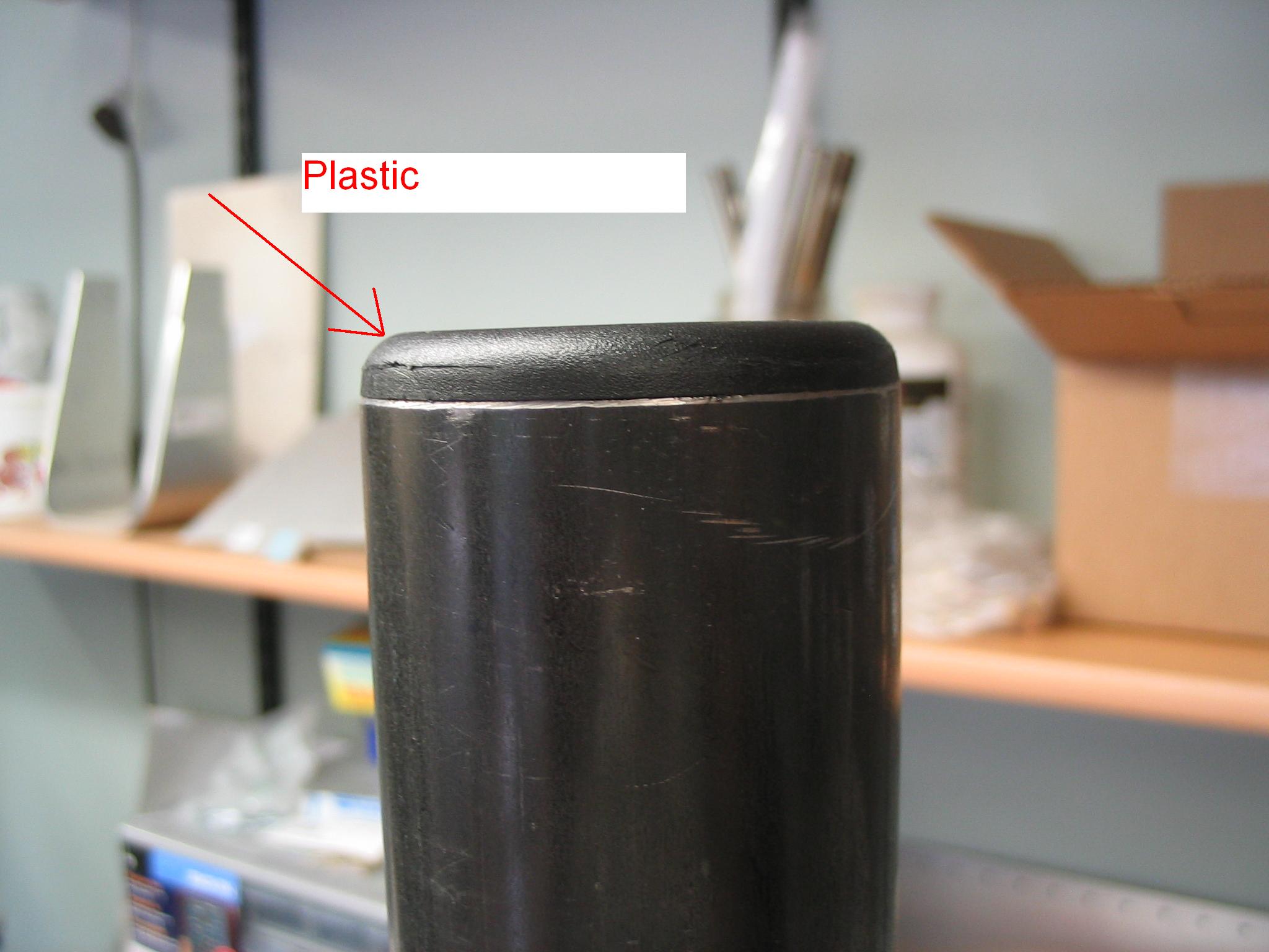

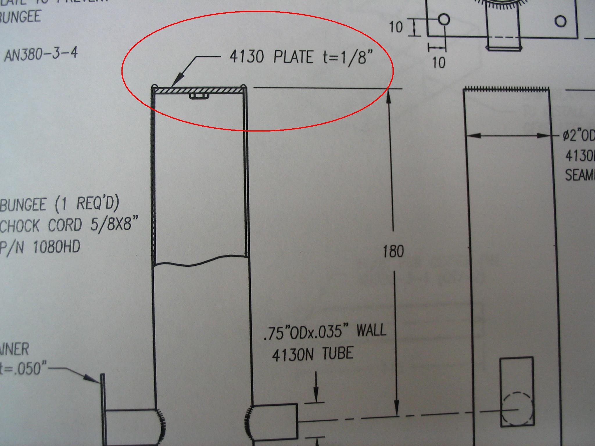

| Subject: | XL Nose Gear Strut: 4130 vs Plastic ??? |
Drawing 6-G-1 shows that the Nose Gear Strut is capped with a welded 1/8" plate
of 4130 steel (see picture).
The nose gear strut in my kit has a plastic top (see picture).
Anybody have the same thing? If so, how did you attach the 6G2-3 Stop Plate?
- Pat
Patrick
601XL/Corvair
N63PZ (reserved)

Message 5
| Subject: | Re: XL Nose Gear Strut: 4130 vs Plastic ??? |
Pat,
You are among the lucky fortunate! You have a new kit that no longer uses
the top plate as a bearing surface. The top just floats up and down thru
the opening. The plastic cap keeps dirt and loose parts from falling in.
It is wonderful to not have the issue with the 'old' style where you prayed
that the top bearing and bottom bearing came to rest at the same time!
Jon

Message 6
I contacted Zenith on this same thing and they said this is the new style
that has the bottom bearing and welded stops on the strut to take the place of
the top stop.
David Coberly 601XL / Corvair (still a ways off )

Message 8
Same strut here. I am about to call Zenith in the next few days to inquire about
the same issue. Guess I don't need to now.
----- Original Message ----
From: "Davcoberly@wmconnect.com" <Davcoberly@wmconnect.com>
Sent: Saturday, September 13, 2008 1:20:19 PM
Subject: Re: Zenith-List: XL Nose Gear Strut: 4130 vs Plastic ???
I contacted Zenith on this same thing and they said this is the new style that
has the bottom bearing and welded stops on the strut to take the place of the
top stop.
Message 9
Now that's what I like about this list!
Not only did my question get answered - there were other guys wondering about the
same thing, and they got answers too.
Thanks Everyone.
- Pat
