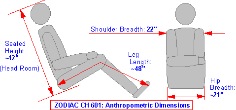

      Hi All,
      Having recently sold our PA38 we are looking for something newer and cheaper to
      run.
      The CH601HDS looks a likely contender but there are none local to me that I can
      go and look at.
      My question is: how much space is there in the cockpit? The reason I ask is that
      I am 6'4" and 190lb. My height is mainly biased towards my legs rather than
      my torso.
      Do any of you guys have any experience of fitting someone my size into a 601? I
      see that there is a very useful diagram for the 601XL on the Zenair web site.
      http://www.zenithair.com/zodiac/images/6-dim.gif
      There is also a quote from a pilot:
      "Just a quick note to let u know that I am 6'4" and weigh over 250 and I fit into
      the Super ZODIAC nicely. I encountered lots of headroom with the bubble canopy
      and was very surprised with the room." - TW
      His quote mentions the Super Zodiac, does he mean the HDS variant or is he referring
      to the XL?
      Some clarification/assistance would be much appreciated.
      Many thanks,
      Kevin (Plymouth, UK)

      Kevin,
      I am flying a 601HD, I am 6'3" tall and about 190 lbs. The trick is to have the
      rudder pedal placed as far away as possible. Also by varying the thickness of
      the seat cushion you can add more room. I built mine with the maximum leg room,
      rudders all the way forward and then made my seat cushions following instruction
      I found on line. The first thing I found when I put it all together in the
      plane was that my head (headset) tended to hit the canopy. I took about two
      inches of padding out of the bottom of the pilots seat. That took care of that.
      Later I felt that I needed more leg room and I removed a 1 inch peace of foam
      from the seat back. There is still plenty of foam and I can easily fit in the
      cockpit.

      Kevin,
          I am 6' 3" and got a ride in Larry McFarlan's 601HDS and I found it a
      little tight for leg room (It is an excellent plane by the way, Larry is
      very meticulous). I built the 601XL and moved the rudder peddles towards the
      firewall as far as the plans allowed and am quite comfortable.

      Also the seat pan itself can be installed a bit lower than the plans
      show. I think mine still has at least an inch between the seat and the
      bottom of the fuselage.

      Congratulations Craig!
      You're right, the HDS was a little tight, but my seat back could get
      another 2 inches if it were only an inch thick.  Fits me as I'm short in
      the legs, long in the waist.

      Thanks guys. I am hoping to take a look at a 601HDS that is for sale in the UK.
      Weather permitting I might be able to see it next week.
      How easy is it to adjust the rudder pedal position?
