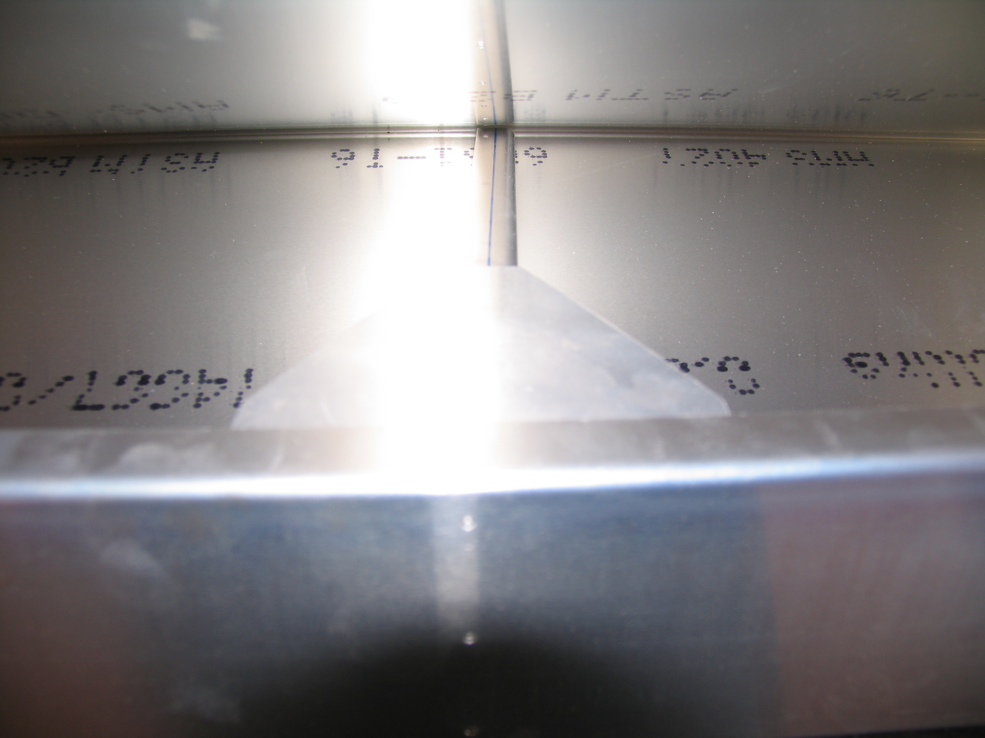

      here's some gusset pics for reference, note that the inboard triangle gusset's
      long edge is oriented along the top of the inboard rib flange.
      Anthony Hanson
      http://forums.matronics.com/viewtopic.php?p=222185#222185

      >From your photos it looks like you have flex hinge ailerons not piano hinge ailerons,
      is this true?
      Attached is the Zenith drawing for the installation of the gussets.   Does it match
      your drawings?
      I would contact Zenith before installing the gussets on a flex hinge.  It was the
      piano hinge aileron design that was having the problems talked about in the
      paragraph above the drawings but the drawing shows a flex hinge installation.
      This could be a defensive move by Zenith.  They can always point to the bulletin
      and say "See the drawing" this is what we recommended to be installed on all
      601XL, and the service bulletin shows flex hinged ailerons.  I don't know.

      My 650 is equipped with the hinge-less ailerons and my current opinion is to follow
      the drawings guidance and that they are a good precaution regardless of hinge
      type.  I just finished assembly of the right aileron, starting on the left
      after this post.

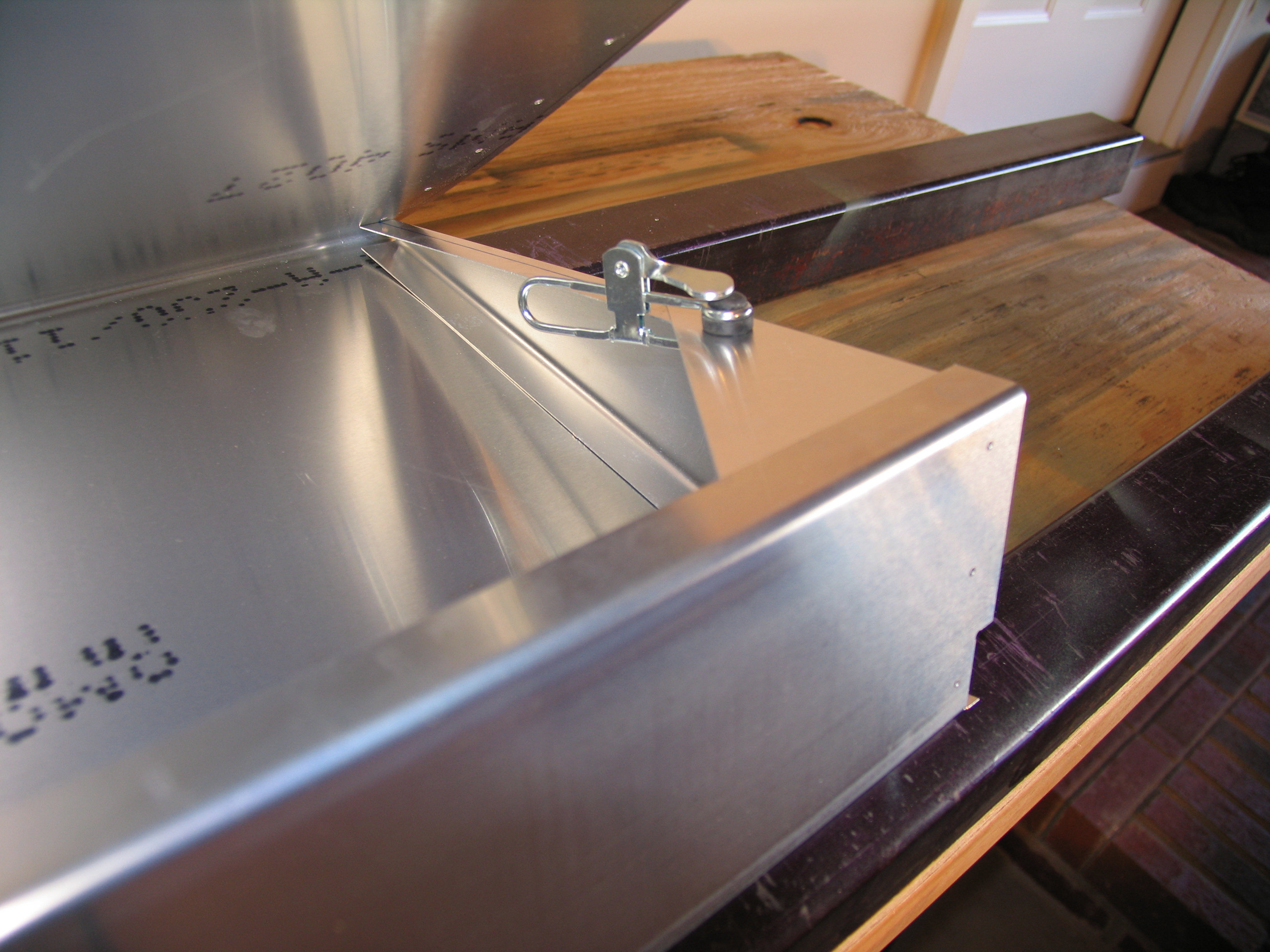

      The problem is that your flex hinge was tested extensively by CH without the gussets.
      http://zenithair.com/images/kit-data/ht-aileron.html
      The gussets will create ripples/stress points along the attach line between the
      flex hinge portion of the aileron skin and the spar portion of the aileron skin.
       The .016 skin will be raised by .025 and then settle back down.   The key
      to a flex hinge is the smoothness of the hinge.
      I would contact Zenith and ask them if the flex hinge aileron with gusset drawing
      is correct and/or tested.

Message 14
| Subject:  | Re: Aileron Rib Gusset Questions |
      Sabrina,
      Good call, and the most conservative approach.  Your logic is sound.  Will hold
      off on the rivets until confirmation with ZAC.  I'm getting high on self etching
      primer anyway:-)
      You veteran builders out there, thanks in advance, this new guy is a pilot only(Prior
      Piper Cherokee owner, and currently Army Kiowa Warrior Pilot) and am still
      learning the engineering know-how that so many of you exhibit.
      I'm a follow the plans/instructions, getter done kind of guy.  Appreciate this
      gotcha advice and the future guidance to come.
      Anthony

Message 16
      Sabrina and Nathan,
      Nathan if you do as your picture shows with the gusset under the "spar cap" and
      on top of the rib flange stress points are a non-issue. The CH drawing shows
      a flex skin aileron and the advice is to install on the 601. I think it is a worthwhile
      addition. I installed them on the external skin on my 601.
      As far as the control cables go I believe the KR has pulleys not fairleads. That
      makes cable tension easier to set and in straight lines. There is no way an
      aircraft should go through an annual without a dtailed inspection of the control
      cables including a tension check, binding, jumping a pulley, fraying and etc.
      I don't know of an A&P who would skip that.
      Al Rupp
      An A&P for many years.
      601XL
      -------------- Original message from "Sabrina" <chicago2paris@msn.com>: --------------
      gussets.
      skin. The .016 skin will be raised by .025 and then settle back down. The key
      to a  flex hinge is the smoothness of the hinge.  I would contact Zenith and ask
      them if the flex hinge aileron with gusset  drawing is correct and/or tested.
Message 17
      Maybe joggle the ribs to give room for the .025 gusset?
      Check with Zenith...
