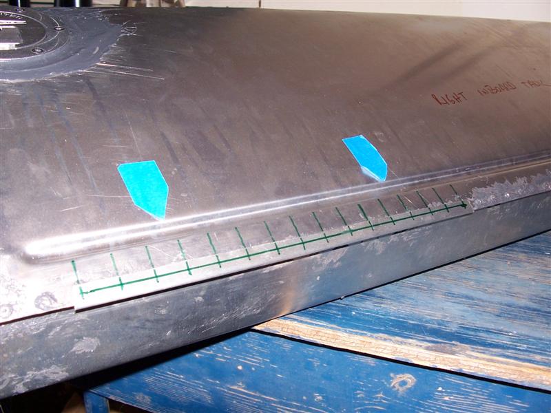

      Well I've waited long enough, it's time to get on with the wings.
      I have a few questions.  The drawing calls for a 1 3/8" diameter tube for bending
      the leading edge.  I'm thinking of using the vacuum method, and this will likely
      be either next weekend, or within a few weeks.
      Does PVC pipe have adequate rigidity?  Are 12 foot lengths commonly available?
      If not PVC I'm concerned as to what I'm going to do with a 12 foot length of
      steel pipe once I'm done.  This is a scratch build, so please don't tell me they
      come pre-bent.
      Dan Dempsey
      http://forums.matronics.com/viewtopic.php?p=226560#226560

      Hey Dan ,I had good results using this method.       Wade Jones

| Subject:  | Re: Pipe for bending leading edge |
      Wade,
      That's the method I was going to use, but what type of pipe did you use?  Is it
      PVC?  Do you think PVC would work?
      Dan
