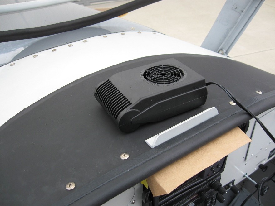

I did some flying this winter with OAT's in the mid to upper 30's and on the ground
during taxi is where I experienced canopy fogging. In-flight, I had no problems
with the fog clearing up even though I only have the one hole for heat
in the lower firewall. I bought a 100W 12VDC portable car de-froster unit that
plugs into a cigarette lighter for taxiing. I sit it on top my panel until ready
for takeoff when I un-plug and stow it. It is a very light unit and only uses
the equivalent power of a landing light. Picture attached.

Hi DaveG601XL, I like the look of the top of your dash.Where did you source the
edge rubber? and what material is the black anti-glare ?Like the sun visor for
the EFIS/GPS Cheers Alan

I have flown for two Wisconsin winters now and many times it's been way
below freezing and sometimes below zero. The canopy does fog up a little
bit (usually on the side, not so much in front) but I open my fresh air
vents (while I taxi and do my run up) and that keeps it to a minimum. Just
before take off I close the fresh air vents and pull on cabin heat and that
takes care of any fog that might have developed. Like Larry has mentioned,
I also carry a microfiber towel, but seldom have to use it. Like David
mentioned, I also purchased a portable car defroster but never had to use
it.
> the ground during taxi is where I experienced canopy fogging. In-flight, I
> had no problems with the fog clearing up even though I only have the one
> hole for heat in the lower firewall. I bought a 100W 12VDC portable car
> de-froster unit that plugs into a cigarette lighter for taxiing. I sit it
> on top my panel until ready for takeoff when I un-plug and stow it. It is
> a very light unit and only uses the equivalent power of a landing light.
> Picture attached.
