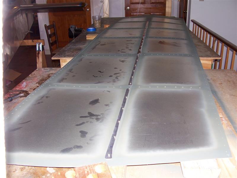

I'm not Dan, but here's a jpg file of the stringers/stiffeners I put in my 701
wing skins.
Tommy Walker in Alabama

Message 7
| Subject: | Re: What I did today |
Tommy ,is you skin thickness .016 or ,025
Wade Jones South East Texas

Hi Wade,
Thin, ain't they? LOL I think they are just there to keep the air out. :)
Yep, all skins except the bottom cabin skin is .016 on a 701.

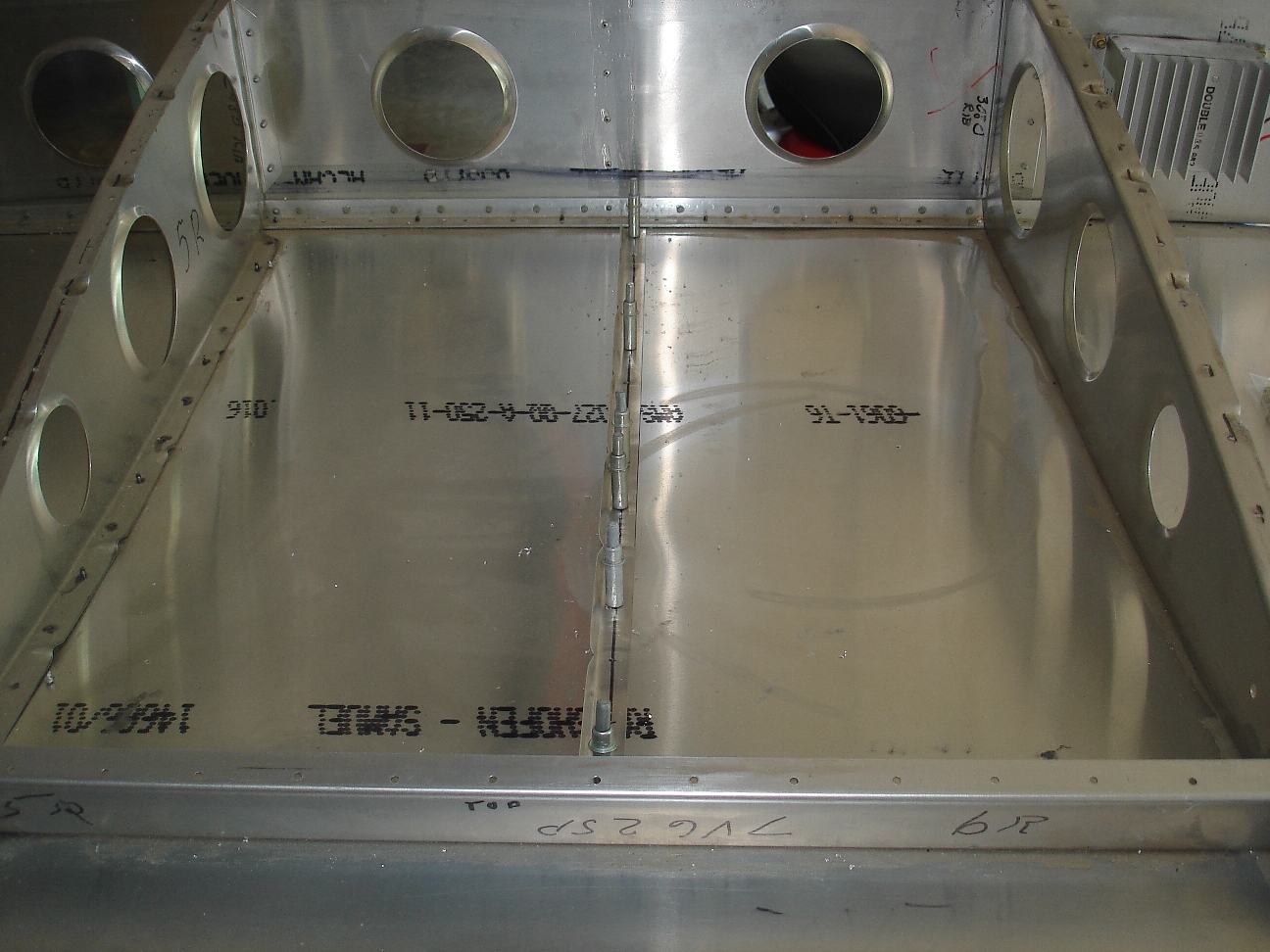

Eldon,
I'm attaching this picture, but please keep in mind, I have no idea what I'm doing
here. My wings are close to being closed, so I added the stringers the way
I thought I'd heard them described. When I asked for advice a week or so ago
about these, no one responded. But I see Tommy's photos are in the other direction!
This may be my big goof #2. If anyone knows how these are suppose to
be installed please speak up.
Dan

Dan,
Don't worry, that's how I did mine.

Eldon,
doing here. My wings are close to being closed, so I added the stringers
the way I thought I'd heard them described. When I asked for advice a week
or so ago about these, no one responded. But I see Tommy's photos are in
the other direction! This may be my big goof #2. If anyone knows how these
are suppose to be installed please speak up.
Dan

Per the 650 plans, the optional L angles go from the 4th rib to the wing tip, parallel
to the main wing spar and 425mm aft of the main spar rivet line.
Larry Winger
Peter,
Nice work. I checked out your website. Thanks for posting.
Dan

Dan,
Who am I to say someone is not doing it "correctly? I just copied what I saw in
other places. Jon Croke did his 701 this way. That is not to say his way is
best.
I just wanted to cut down on some of the oil canning in the 701 with the .016 skins.
I do like the they way your stringers are aligned. Who knows? Maybe your way
is the better way!
Do Not Archive Any Thing I ever post on this or any other site.

Tommy,
Thanks for the post. I just want to make sure I'm doing something dumb, like adding
stiffness where it doesn't belong. Evidently I've done it the way they
are doing it on the 650, so I'm satisfied.
When will #2 be flying?
Dan
