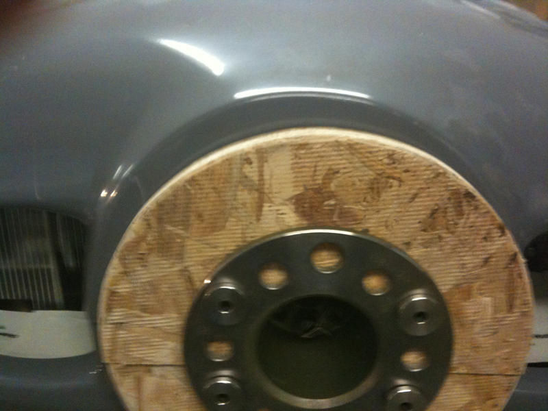

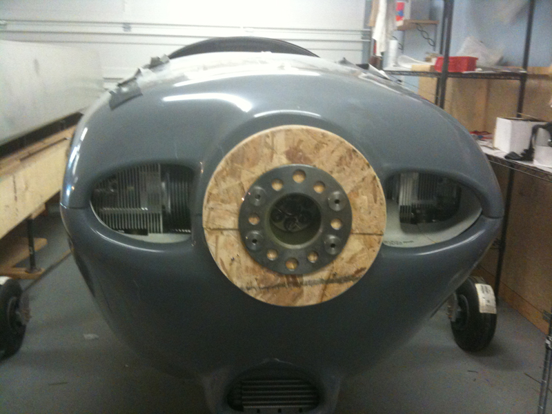

      Hi All
      I'm trying to fit the cowl (601XL Jab 3300 with the Jab Cowl)
      Look at the attached pictures  When I get the thing lined up so the air intakes
      line up and are symmetrical  the centering of the prop shaft is off.. WAY OFF
      Ok so which is it  Center the prop and not center the air intakes?? (seem bad
      for cooling to me) or center the air intakes (and it looks like *&*^%^&*)
      OK someone whos been here before guide me
      Larry Whitlow
      601XL
      http://forums.matronics.com/viewtopic.php?p=260524#260524
      http://forums.matronics.com//files/img_0127_101.jpg
      http://forums.matronics.com//files/img_0126_863.jpg

      Hi Larry,
      I think I had a similar problems with my cowl.  I don't remember the
      details (heck, I barely remember what I had for lunch) but I found a
      good picture that might help you out.
      After getting the crank shaft opening set up I had misalignment of
      the top and bottom fiberglass pieces that looked really awful.  I
      decided to fill in the gaps with flox and epoxy filler.  The flox
      came in a composite training kit from Aircraft Spruce.  Flox is just
      a nice pile of chopped up fiber (cotton, I think).  The kit was a
      great purchase even though intended for Rutan builders and their
      special techniques.  I haven't yet flown my plane, but I think the
      filler will hold up just fine as well as holding paint just as well
      as the rest of the cowl.  Please see the pictures below.
      Paul
      XL awaiting engineering changes
      >air intakes line up and are symmetrical  the centering of the prop
      >shaft is off.. WAY OFF  Ok so which is it  Center the prop and not
      >center the air intakes?? (seem bad for cooling to me) or center the
      >Larry Whitlow
      >601XL

      I had a similar problem as well  with the misalignment  so I used a heat gun to
      twist/bend and teak it.I'm very happy with the result and it was quick to do.
      Cheers
